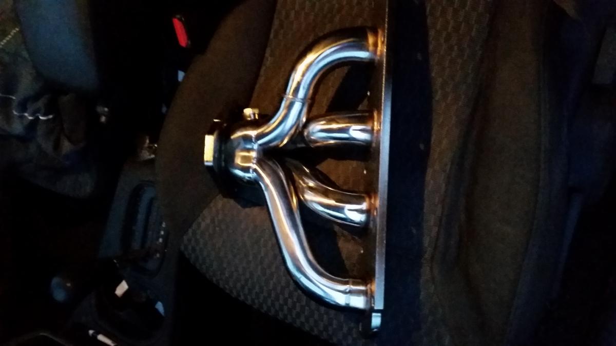

So I bought headers for my 2.2 months ago but finally found someone to put them on and when he goes to do it he says there is no egr port on then so they can't go on my car. Do I need to buy new headers now? Or is there a way around this??? Please help!!

Well it seams as if you got ripped off, if you bought some headers for your 2.2 and you only received a single header. Its a single bank so its a header not headers.

I believe no Ecotec engine came with an EGR (verified by Google) so whoever is putting in your header is mistaken. But you may have this: https://www.cobaltss.net/forums/2-2l...88/#post628625

what kind of header is that? brand?
Old Jan 12, 2015 | 10:16 PM
blueLNFftw's Avatar
Posts: 10,359
Likes: 84
Looks like eBay china special

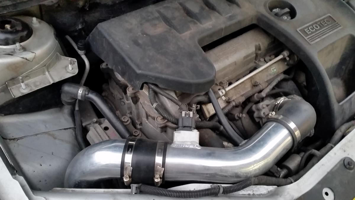

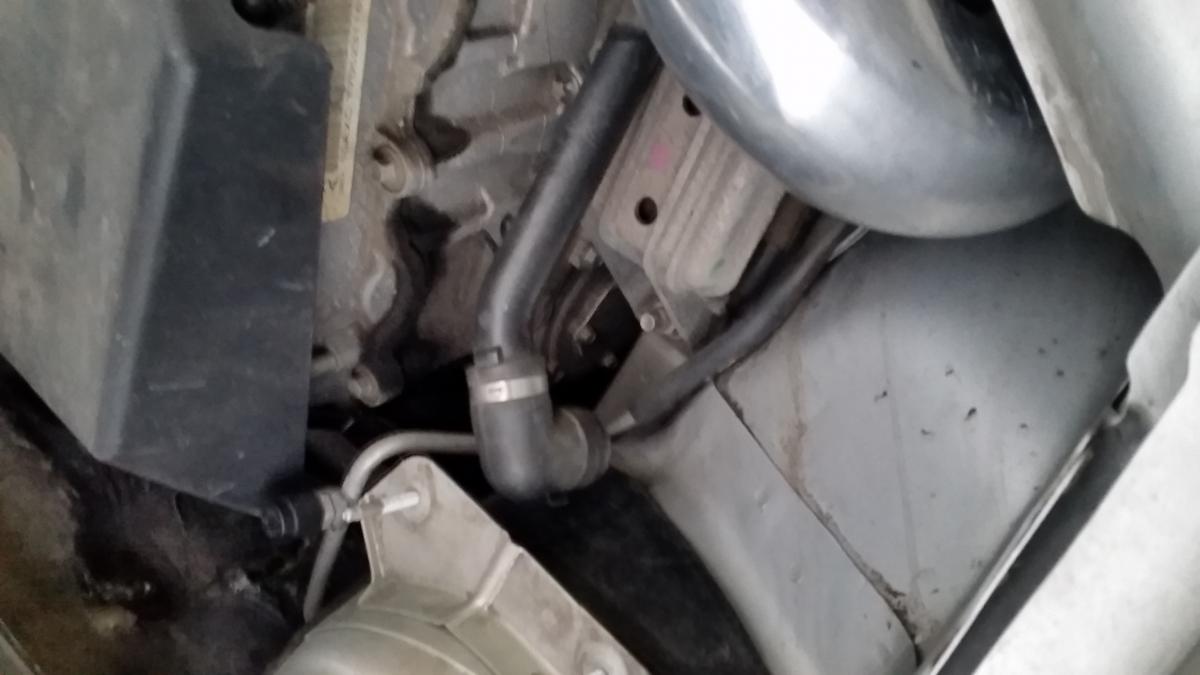

Ok well the SAI would explain why after I put on my intake I have this piece hanging around doing nothing. Which is also another concern of mine. Should I have that piece plugged or filtered. But still going back to my original question. Can I use my header that I bought for my car

This is the extra piece that's hanging by my cai

yeah it wont work unless you tune it out and remove the whole SAI

It's the same header badmab sells and claims to be theirs.
It's a ching ching chong header.
You would be better off with a ported stock manifold.
