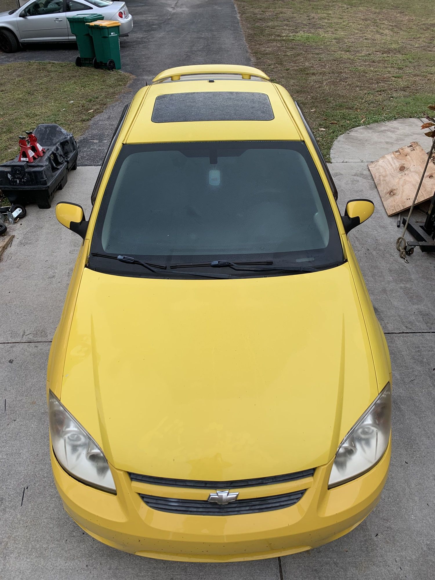

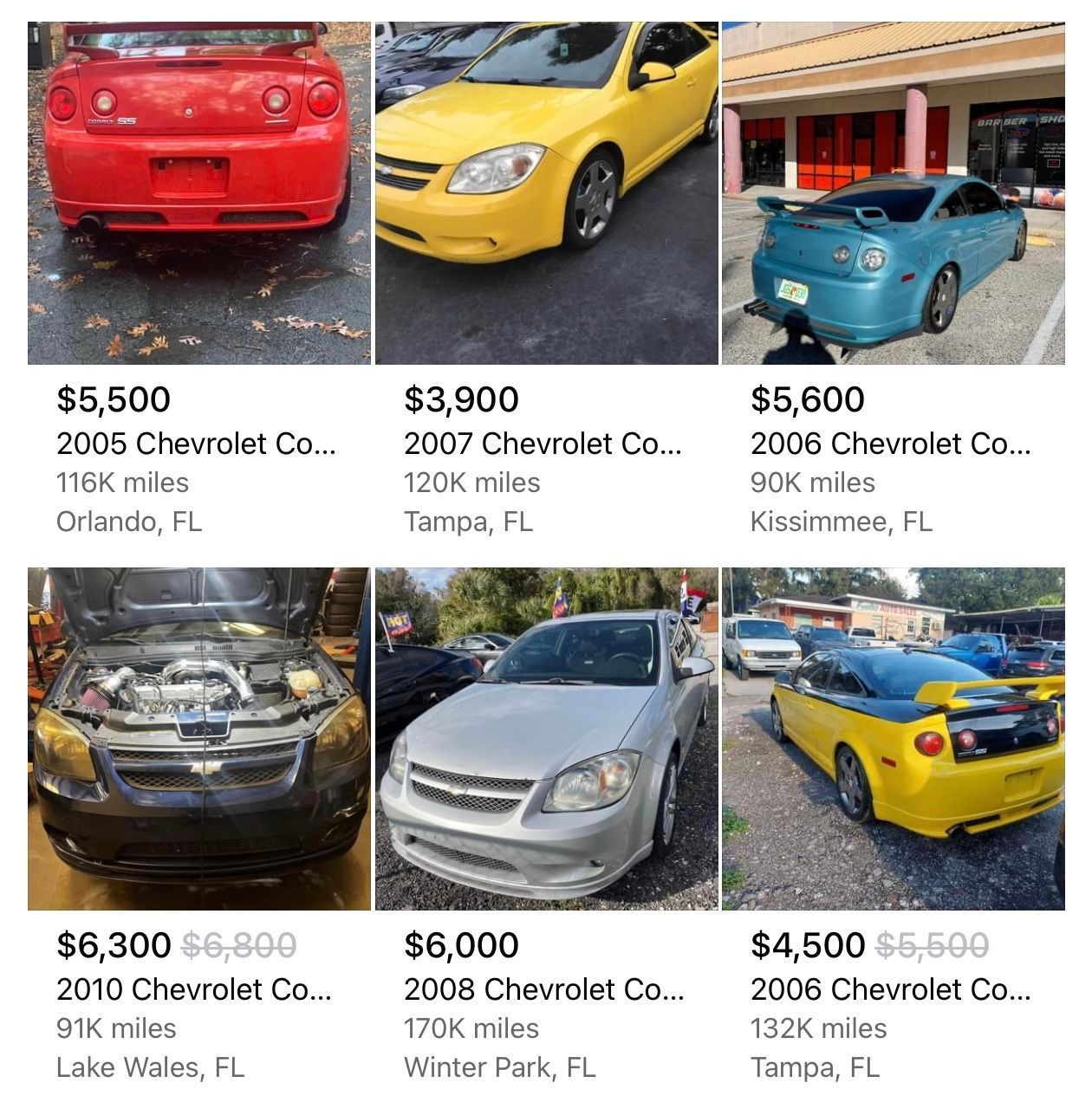

I picked up this 2007 Cobalt SS yesterday for what I think was a steal at $2,869 the dealer was asking $3,900
These are the six that I wanted to check out and drove 3hrs up to Tampa.
It drove great on the ride home, here are some pictures I took of her this morning.

Good pickup for the price for sure. However I've noticed a few things right away that are not right about the car. First off you have no side skirts that come standard with the ss/sc and ss/na models. Also you have no front lip spoiler that again comes standard with the ss/sc model. I would be contacting the dealership where you got the car to ask what happened to those parts. Inside the engine bay I see you have no fuse box cover unless you removed that yourself. Other than those few things it looks like a solid car. I look in your local junkyards in your area to see if you can find the side skirts and the front lip spoiler. Fuse box cover should also be easy to find in the junkyard. What are your overall plans for your build? I see you have a cold air intake on it already.

Thanks for the feedback, The dealer would not have any idea what happened to the missing pieces, they got it as is as a trade in. There are a few salvage yards in my area so I will check them out from time to time. Only plan at the moment is to enjoy driving it and see where we go fro here.

No problem man. It looks like a solid car and at a great price that you got it for. I'm actually in the process of restoring my 07 Pontiac G5 GT. I've done full suspension mods, new fuel lines, fuel pump, new tires, new brakes and brake lines. I'm also doing a m62 supercharger from the Cobalt SS which i'm upgrading to a stage 2 setup. I've been working on my car now for 3 years at a slow but moderate pace since I'm doing a majority of the work myself to save money. I think once you start to dive into it you'll really have a lot of fun making it your own. This ecotec platform is great because the cars themselves are very reasonable in price and oem parts/aftermarket parts are fairly cheap in comparison to the jdm counterparts like Honda Civic, Subaru WRX, etc. I came from that world originally growing up and to see the prices now some 20 years later when I first started modifying vehicles is astounding lol. Mind you in the next few years I might import a vehicle possibly if I can get a fair price for one. I live in Canada so we only have a 15 year rule compared to USA which is 25 I believe. Anyway good look on your project Sir and look forward to seeing more updates.
