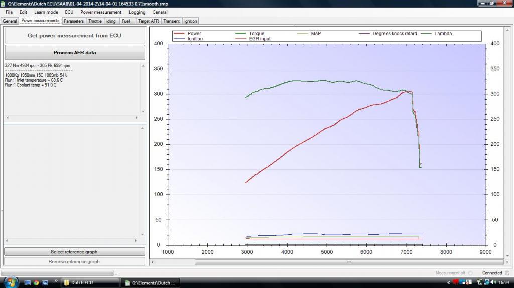

With the following mods
B207 with 2.2 crank, forged pistons and rods stage 2 LSJ cams,lightened flywheel and balancer delete, home build with vocky input on Dutch ECU software m62 3.1 pulley ported head, now also putting dbilas springs in, 630cc injectors

That dyno chart just doesnt seem right to me. What do you measure torque and horsepower in?

Torque is in NM
Power in hp

327 NM is 241 inft @ nearly 5000 rpm
305 hp @ nearly 7000rpm

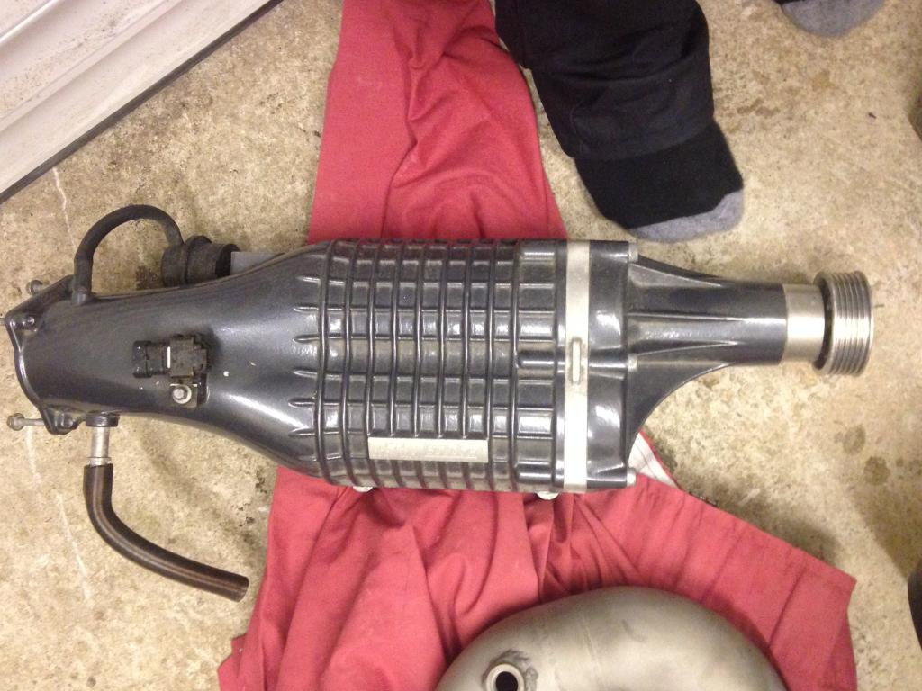

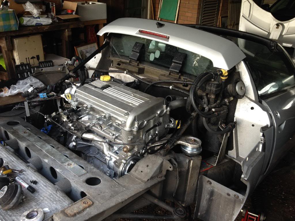

Rear clam off and new 3" exhaust going on
Just need to put Harrop
On next

Yep, think lotus eXige with a better Engine
3" exhaust in fueling is slightly out after changing it but will sort that soon
Cams , don't like idling

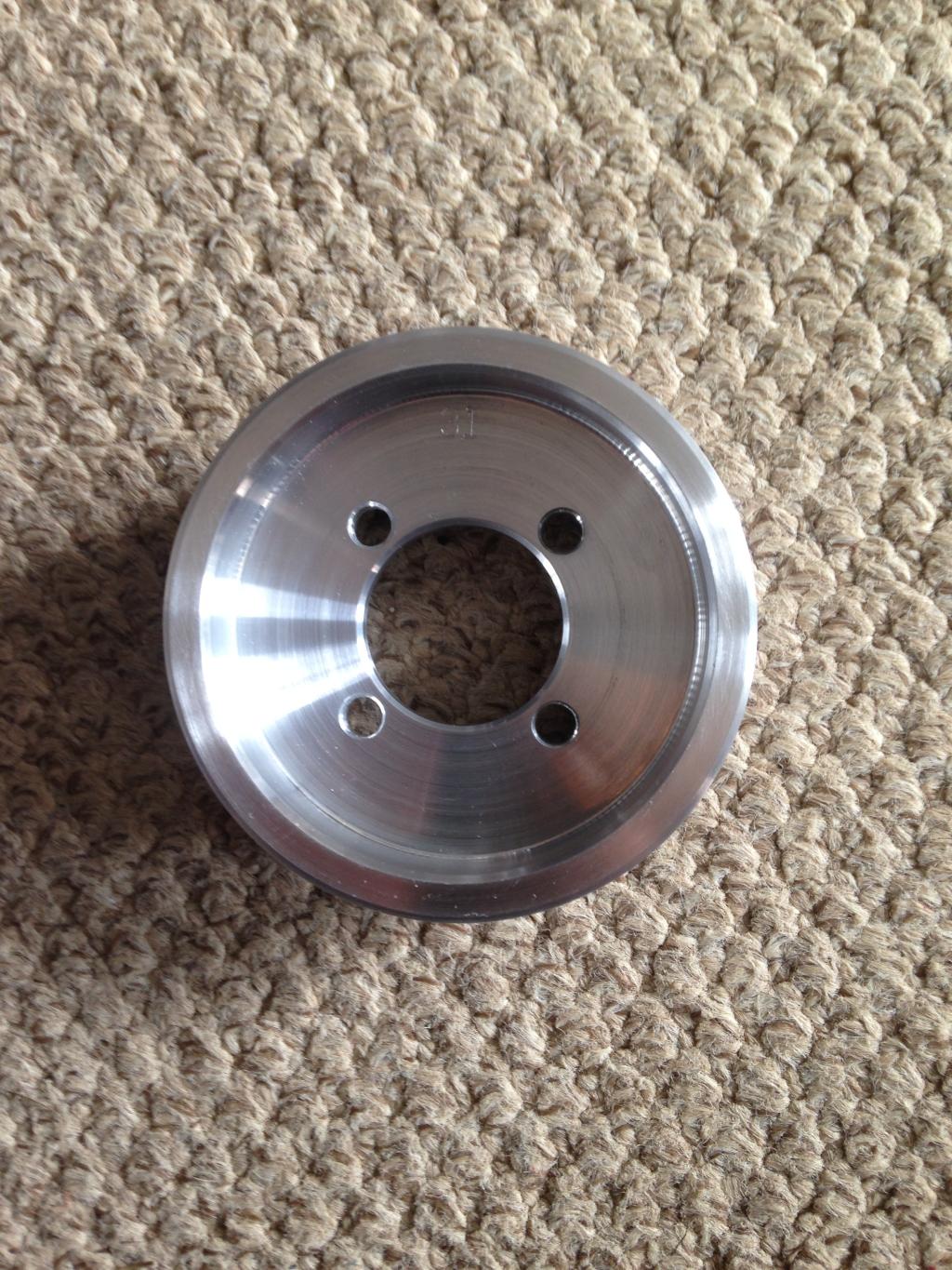

I will be using a 3.1 pulley on the Harrop as a attempt to keep IAT low enough for the ECU to not start pulling ignition or adding fuel to keep things cool,

Got my 3.1 pulley delivered from zzp today which I'm hoping I can take the car to 350hp
Mapping is getting close now

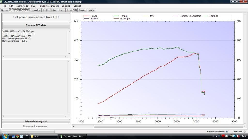

Happy days but need to up my fuel pump to a 455lph

Cool you picked up almost 50hp and 30tq.
Also, what does that thing weigh?
