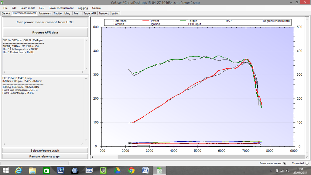

Got the LS4 working on my setup
Took a bit to get it to run at idle due to the throttle position to valve position in the TB
I've now put my 125mm intake on to the LS4 TB and will give the car a full remap and see how it goes

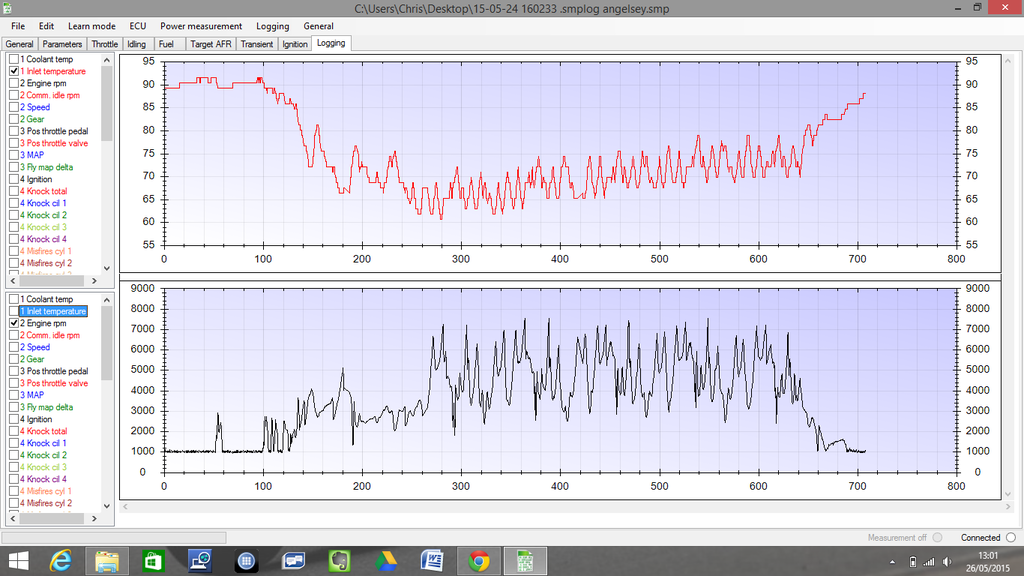

First track day with harrop & LS4 bolted on
IAT

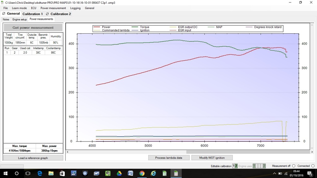

Thought i would update this thread a little bit

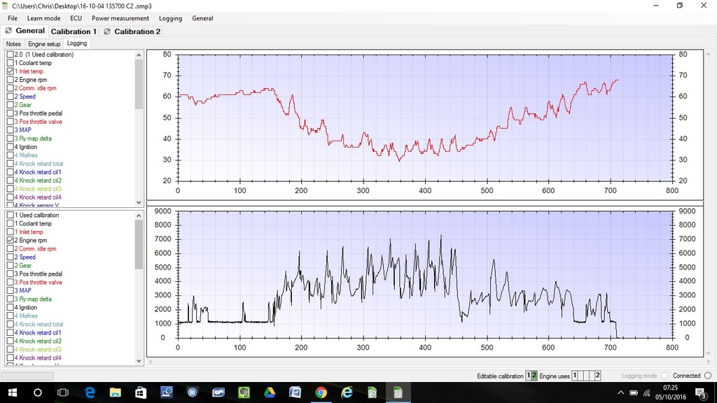

water injec tion is now fitted and im using 100% water (no meth)i also have a failsafe map with lower ignition which automatically kicks in if the water injection system runs out of water or fails
its not yet completely mapped but the cooling of the iat has really helped with the car
ive still not cracked the 400 hp mark but im getting closer

you can see how much the water is cooling the iat temps here
the water injection is controlled via the ecu and the injector duty cycle
