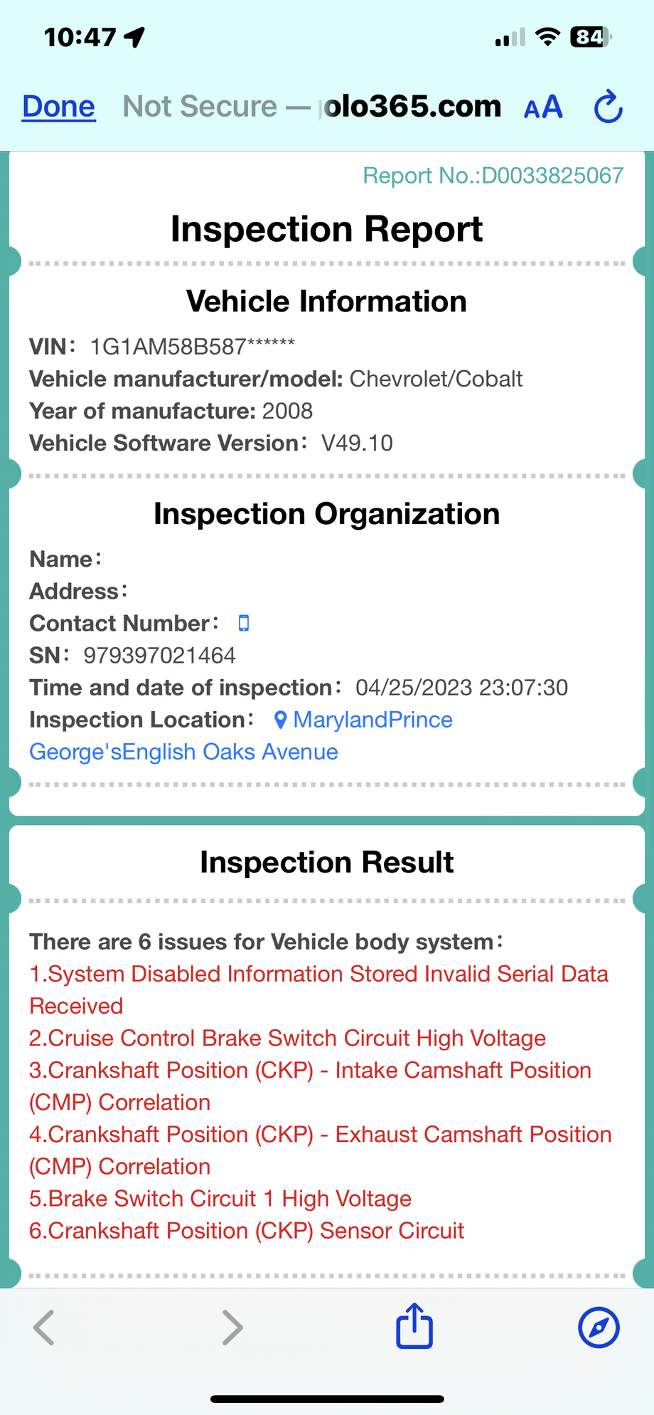

the symptoms is I can get the car to start at times but I’ll leave it idle and it will shut off automatically after about a minute. When it was running I didn’t have full power. It’s been parked since the issues started
Old May 8, 2023 | 11:02 AM
Mikegonzo79's Avatar
Joined: 10-15-22
Posts: 17
From: Richmond Virginia
These are the codes it’s throwing now

Pull the cam cover off check the timing and make sure the cam phasers lock

if it still starts im thinking one the the phasers is bad ive seen plenty of them run fine and when you go to move they stall out
