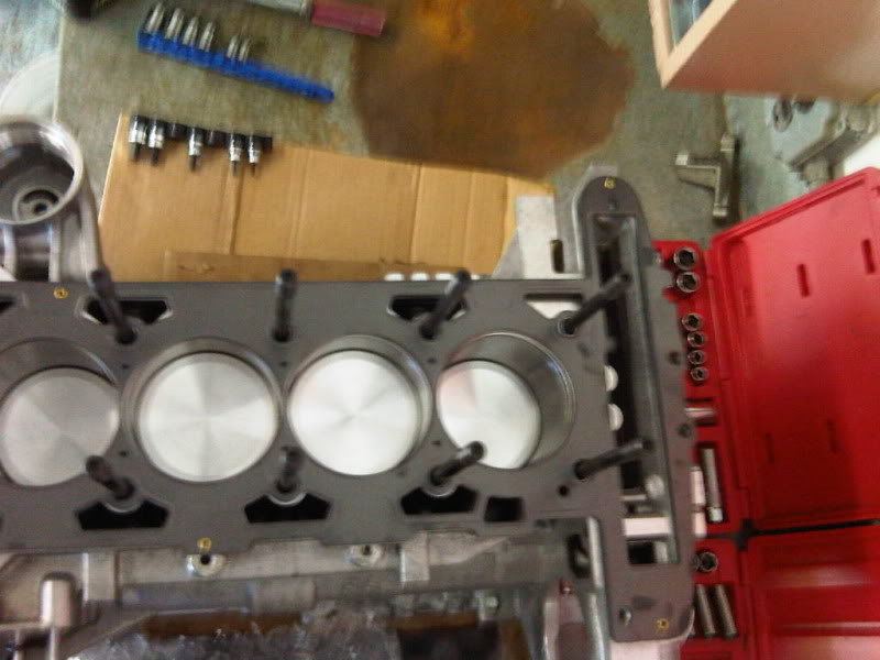

i run a 90mm bore bates sleeved and custom je pistons block. not a road i suggest for anyone else. theres no way stock sleeves can handle that much meat taken out.
it becomes very diffcult to get the head gasket to seal around the thin sections in between the sleeves.
