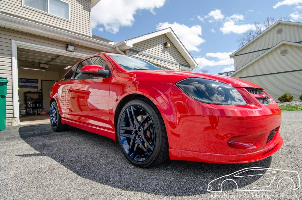

From: Illinois
Originally Posted by Loner05
whats the drop compared to OEM SS springs
There is basically no difference unless you get down to millimeters.
I swiped this picture from my detailer.
