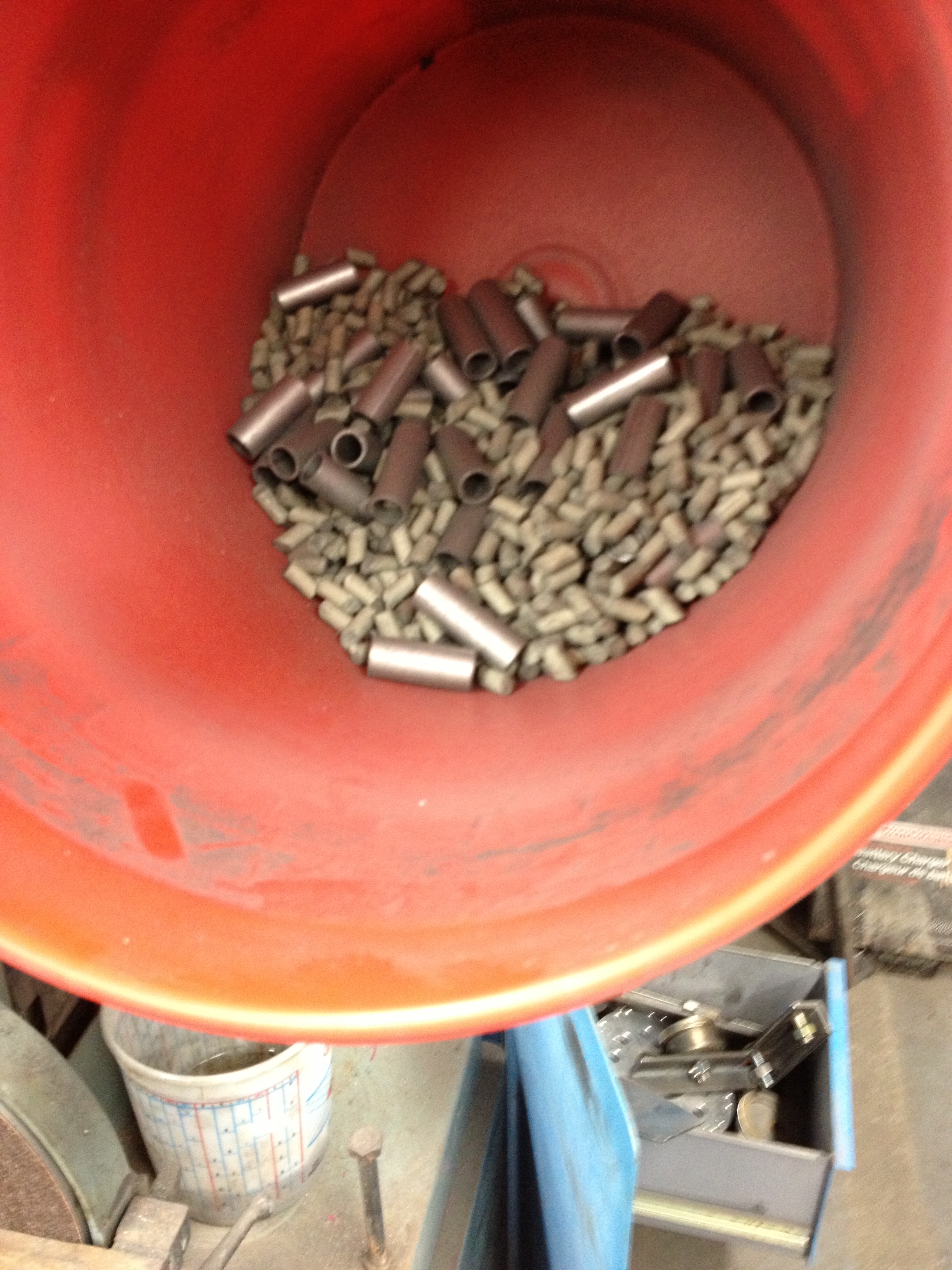

I have to be cautious with pictures of the process, too many copy cats out there. But
here is the tumbler cleaning the sleeves for the sway bar cross section mounting points.

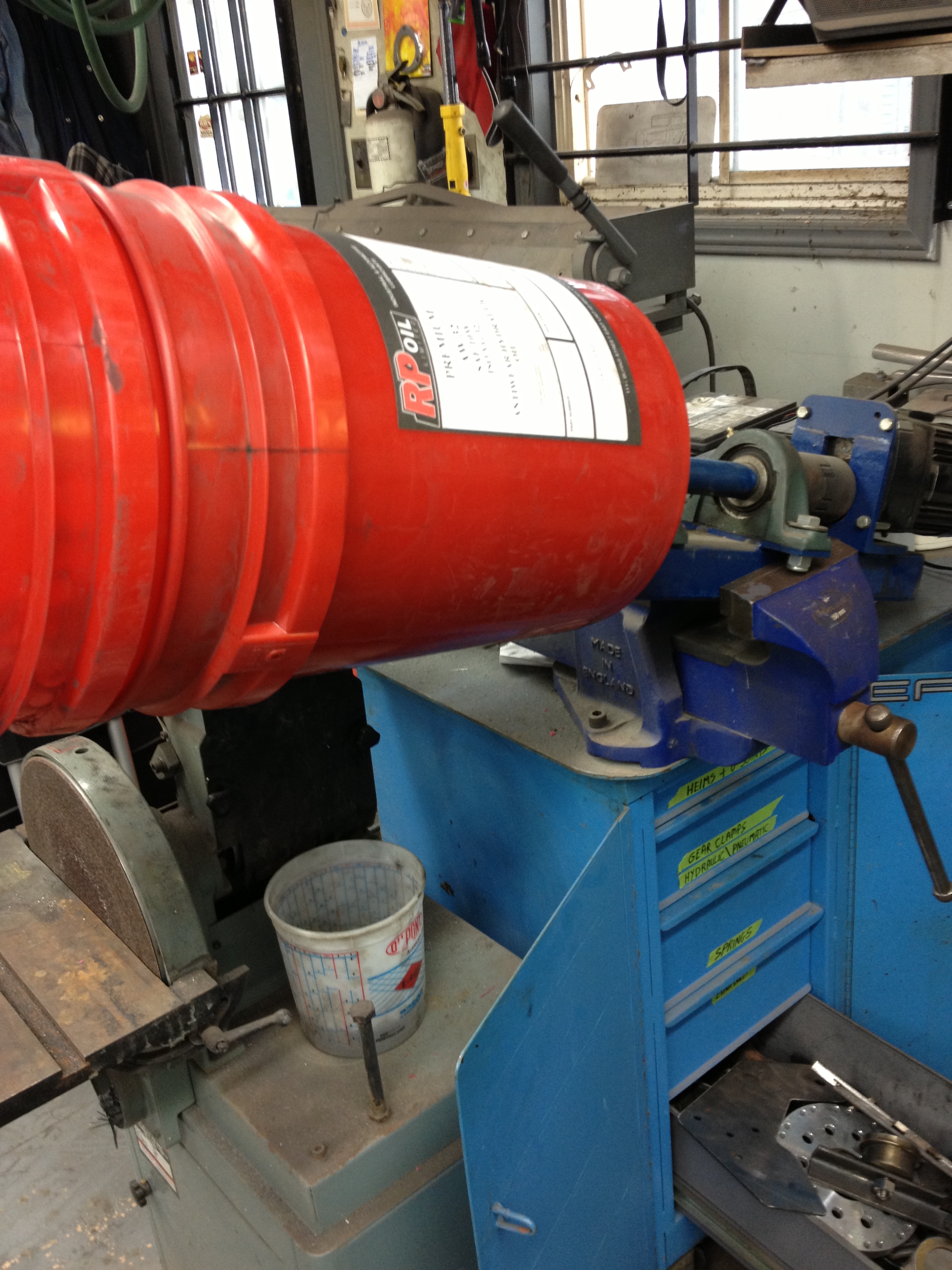

its a home depot tub lol

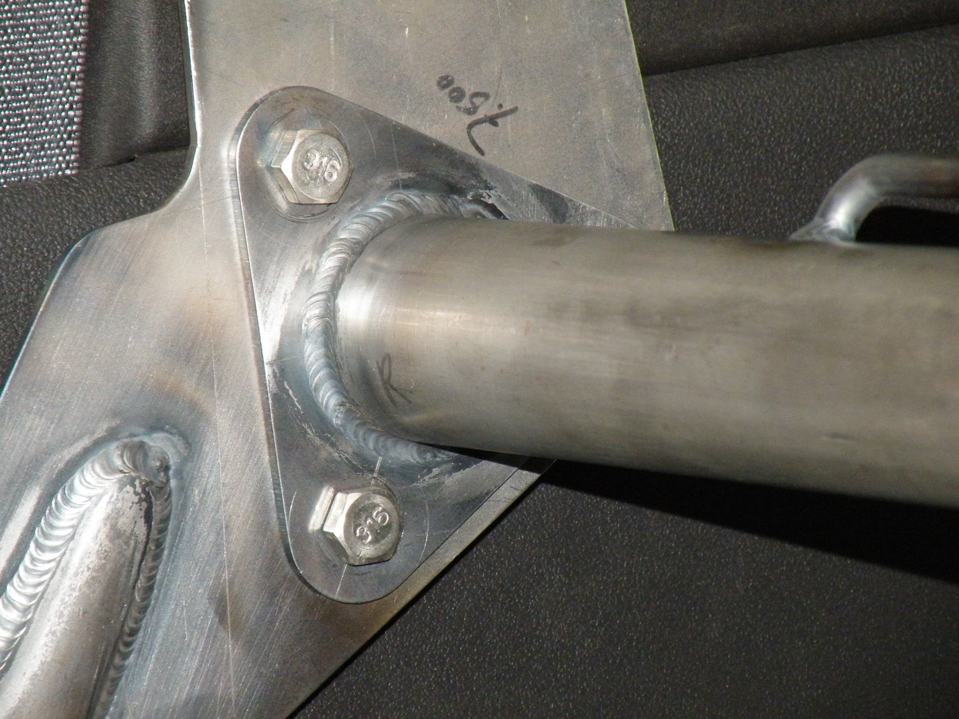

The nut plates are plasma cut then the parts are placed in a jig with mechanical lock nuts and welded.
Each part then is checked for thread engagement, powdercoated and assembled into the bar with anti seize coated cad plated 10.9 grade hardware, ready to ship.

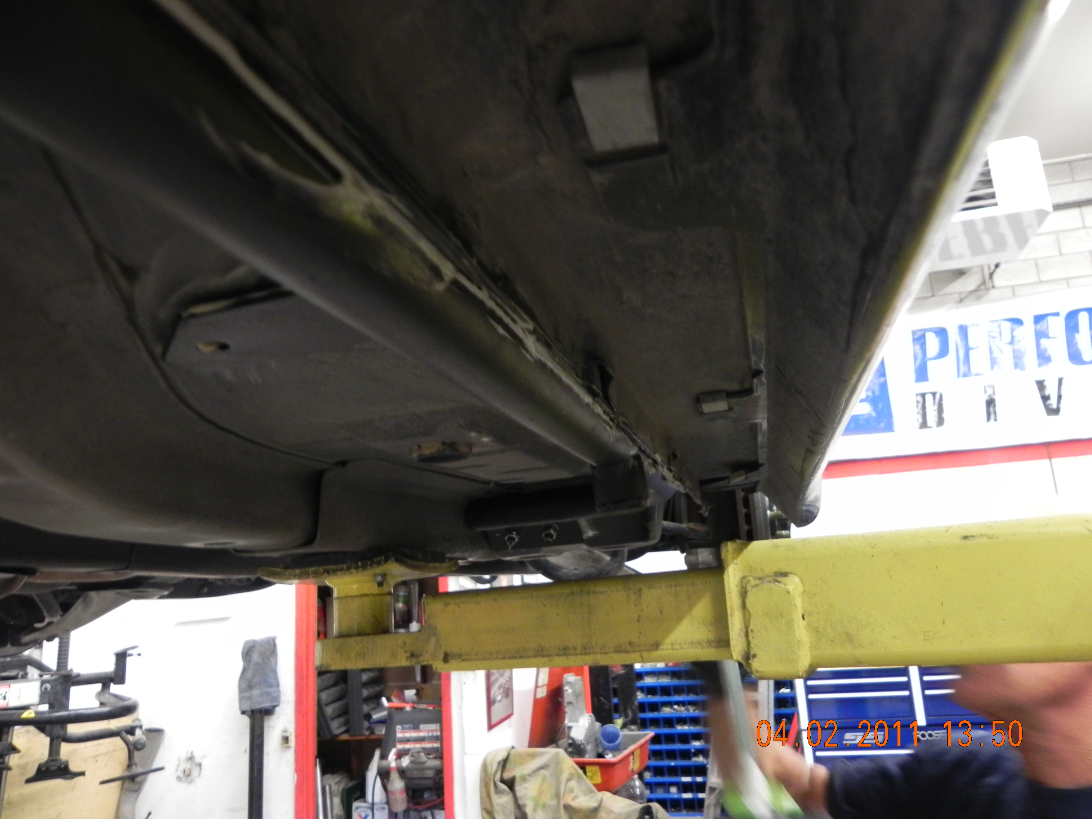

Its a similar process for UnderCarRails. Next to the sway bar and cabs these are my favorite parts, as they not only stiffen the structure, they provide a nifty jacking point which saves beating up the structure of the car just to jack it up. UCR are also made from Chromealloy material. Sure at 449.00 a pair they are expensive, but if you track your car, UCR will make your day so much easier.

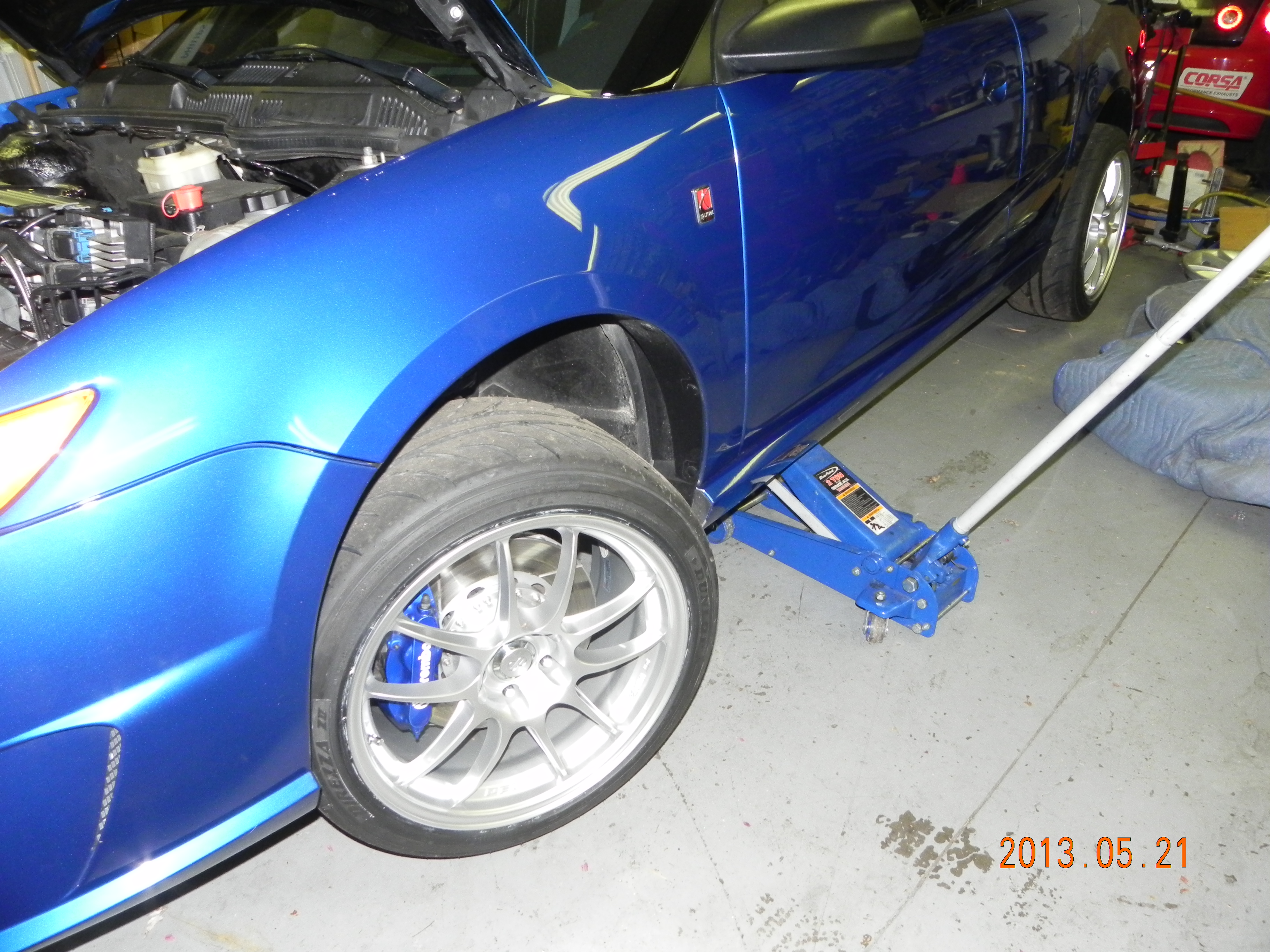

See what I mean?
so easy, LOL.
Dan is a pretty decent welder, even though he says its not his strongest suit. He likes to develop better ways of making things or finding a solution for ideas. Like a tow hook mounted license plate bracket ( to come)

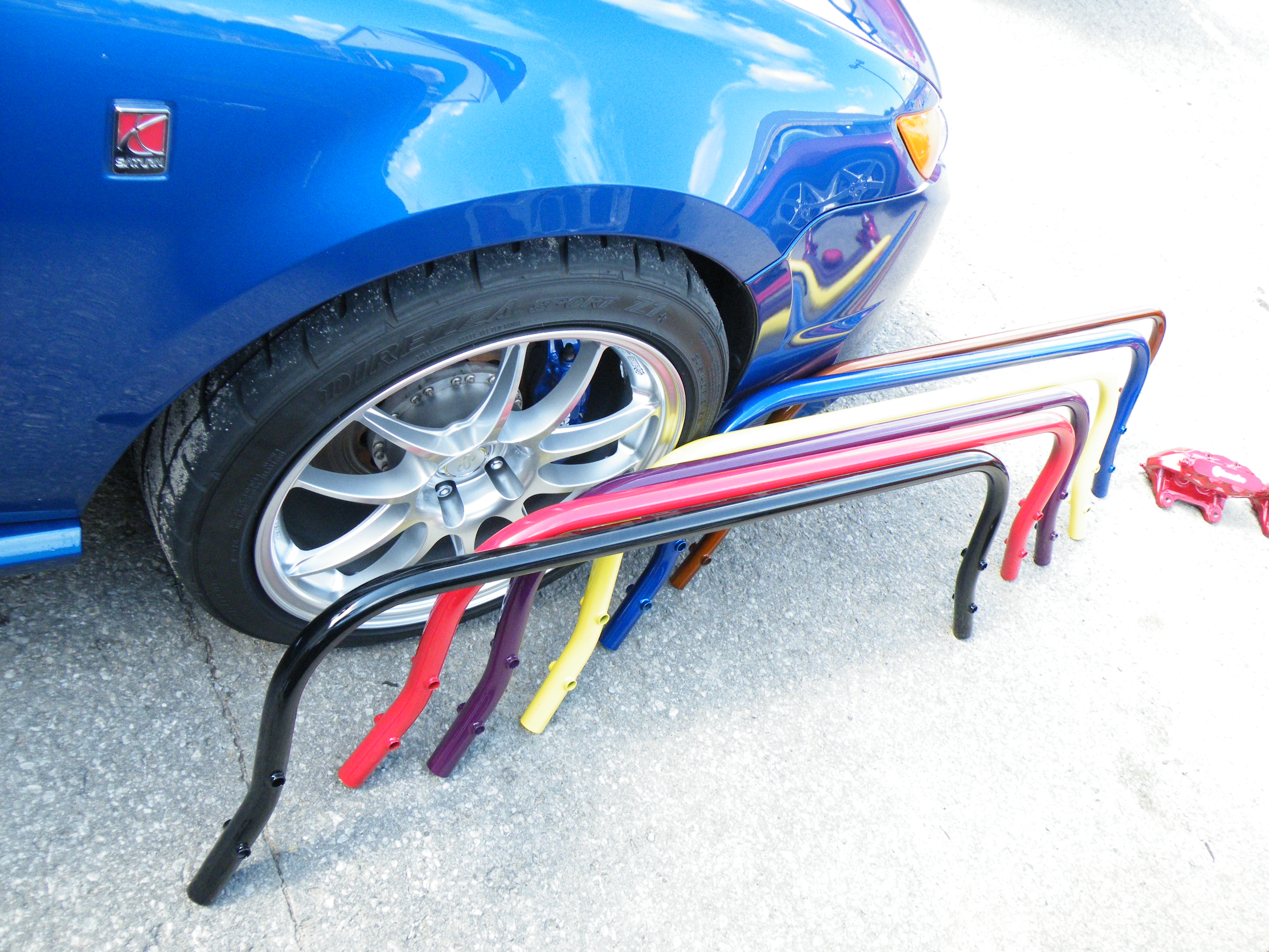

Sway bars. Hardcore or xXx? so many choices.
