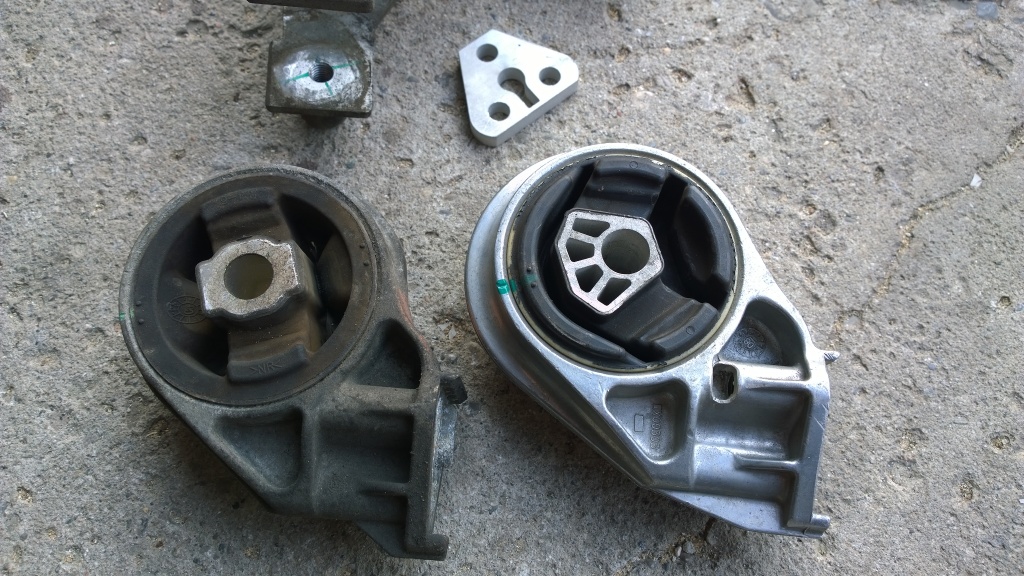

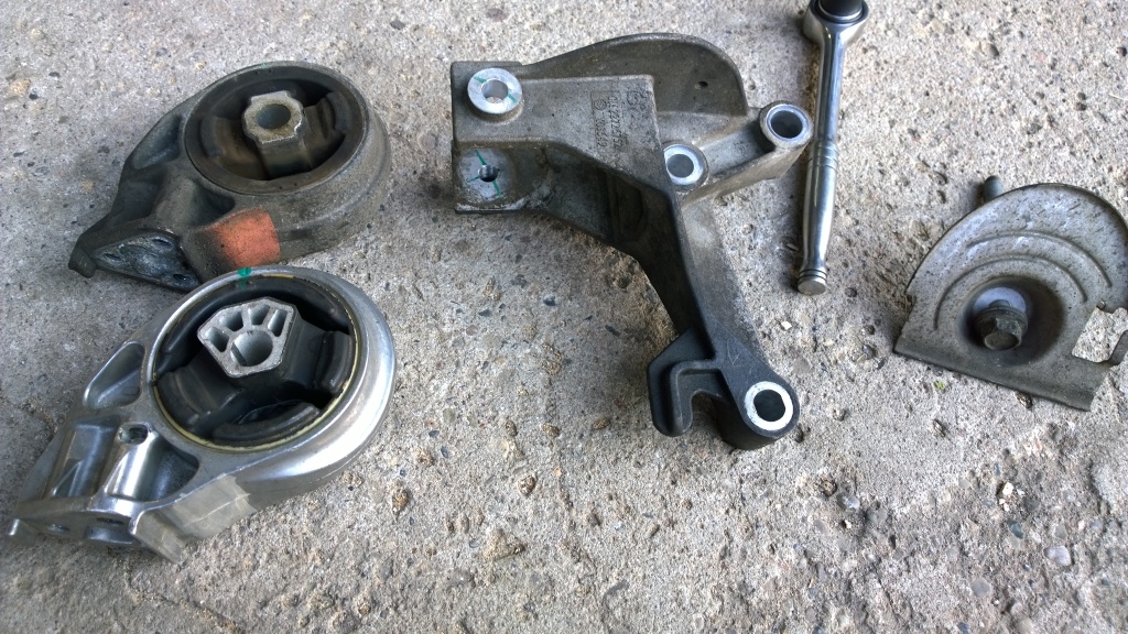

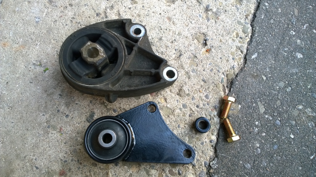

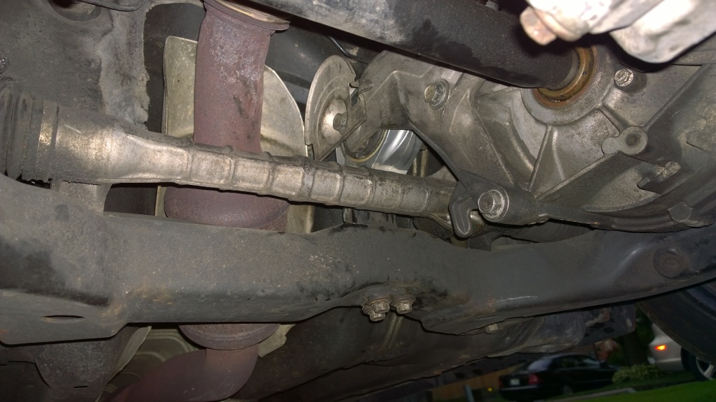

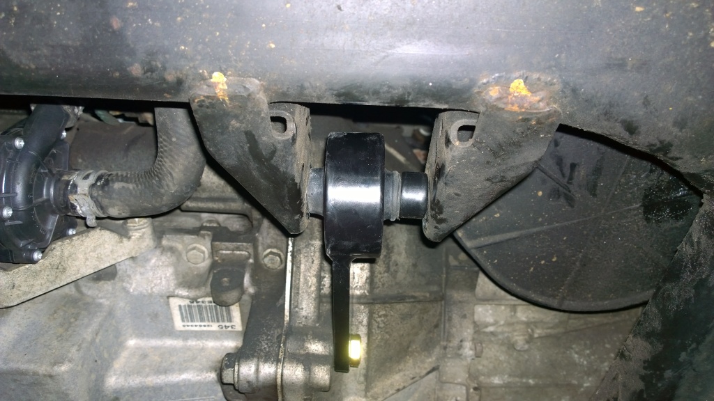

So I installed Powell's latest rotated front motor mounts along with a stock LNF rear mount:
Initial impressions are that I can feel the engine a lot more at idle and up to ~1500rpm, not much more between 1500rpm-3000rpm, and about the same as the tired, stock mounts after 3krpm.
No noticeable increase in cabin noise, but I only had it out for a short drive so far.
Hopefully the mounts soften up in a couple weeks.
No more rocking back and forth for the motor and tranny though!
