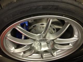

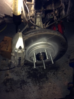

heres the deal.
1.You have to be at least 1.25 inch or more in thickness, to have enough material to make them hub centric. In otherwords, much thicker than the hub centric ring on the wheel bearing. Make it too close the spacer will crack at the hub centric ring.
2. you need longer studs, crate engine depot have some GMPP ones cheap enough, but my preference is to thread in arp bolts which may require making a notch in the wheel bearing to make enough room to clear the bolt to install. difficult.
3. For me to make them, buy a chunk of T6061 (100 bux or so) set it up on the milling machine ( 100 bux or so) then do a run of TWO ???? apacers you be whining like a stuck pig that 250 buxis outrageous for two wheel spacers...
its happened. lol.
we dont do it.
unless
I want it.
long studsName:  photo3_zps66d6dcfa.jpg
spacer installed
this spacer is in the hat for a floating rotor

heres the deal.
its happened. lol.
we dont do it.
unless
I want it.
long studs
spacer installed
haha, I appreciate the info. I agree, thats a crazy price I might as well buy the 4 piece on eBay for 50 less. thanks anyways!
