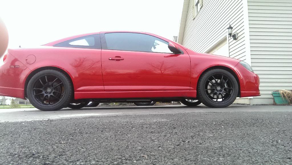

YYZ V.3's but V.5 will sit exactly the same. I need some stickier tires. I'd also recommend going strait to the XXX to save some money in the long run.
