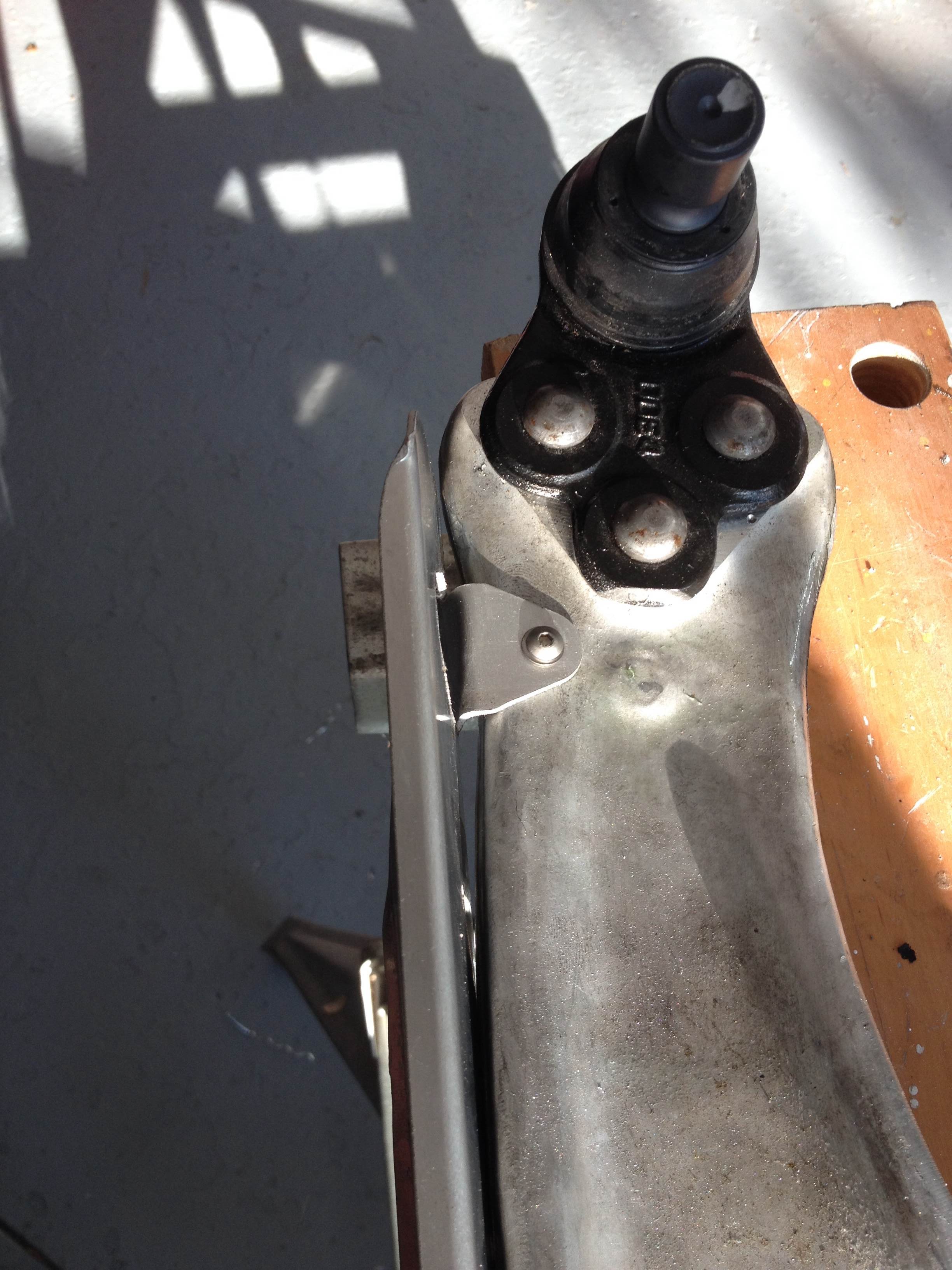

Powell Race Parts's Avatar
Joined: 04-25-11
Posts: 6,128
Likes: 47
From: Port Perry
Old Jul 27, 2015 | 09:39 PM

Price on those john ?
More pics .... I mean the drawing is so accurate now with 1 eye closed.
$45.00 a pair with hardware and a template plus shipping

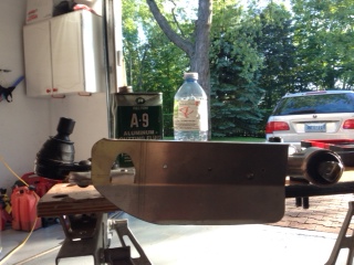

Was the one that mounts at the knuckle/hub with the duct from the fog light scrapped? I remember you saying it wasn't economical for the average person to do it that way.
So if I understand correctly this just works by directing airflow to the general brake area, vs ducting air to the rotor itself? Seems like a very economical way of improving airflow to the brakes, but I could still see the actual duct being an option for more dedicated racers.

He track tested these on a Cobalt that had mayor brake fade around a road track and they were very effective.

John also mentioned these similar ducts come stock on porsche.
The duct from the fog light is great...in theory, but try finding room and then when you have to replace the hose after ever track day, you'll just have pissed off customers. I looked and routing was a little cramped :/ These are cheap, easy, and do the job. I'm all for it.

So install is basically drill a hole through the control arm and bolt down?
I have never experienced brake fade as I don't track of auto X.
Any reason to run these on a street car only?

Negative, no point if you're not experiencing brake fade at the track
