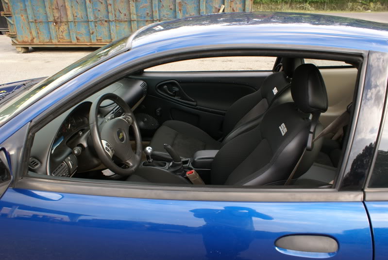

-Racepak IQ3 display dash
-2009 cobalt SS T/C seats front and back
-door pads and pockets wrapped to match seats
-dash wrapped to match seats (needs redone)
-cobalt ss three spoke steering wheel (radio controls function)

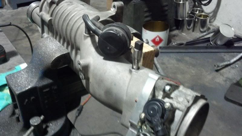

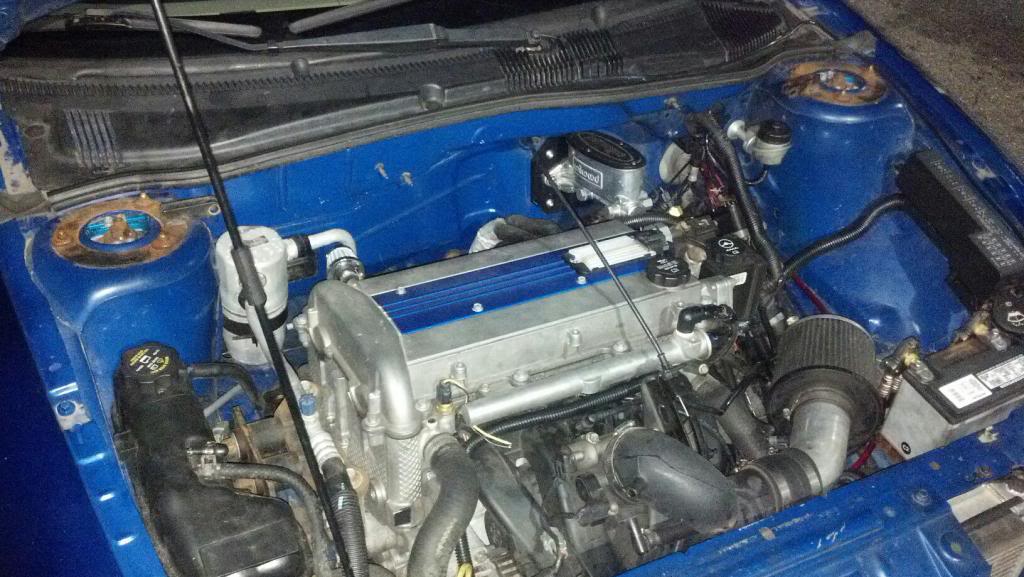

I don't have boosted brakes anymore, so I removed the nipple and tapped the M62 for a plug... maybe meth in the future?
test fit on the car about a million times

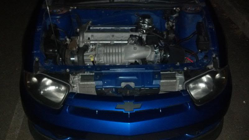

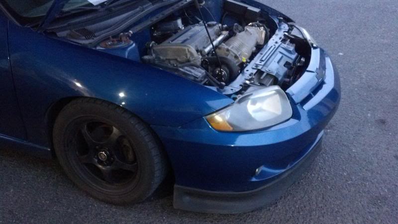

car is running at this point with a factory mustang degas bottle/ flow through h/e reservoir
another shot of the same. you can see the cap for the h/e reservoir on the far right barely

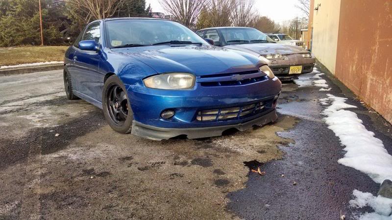

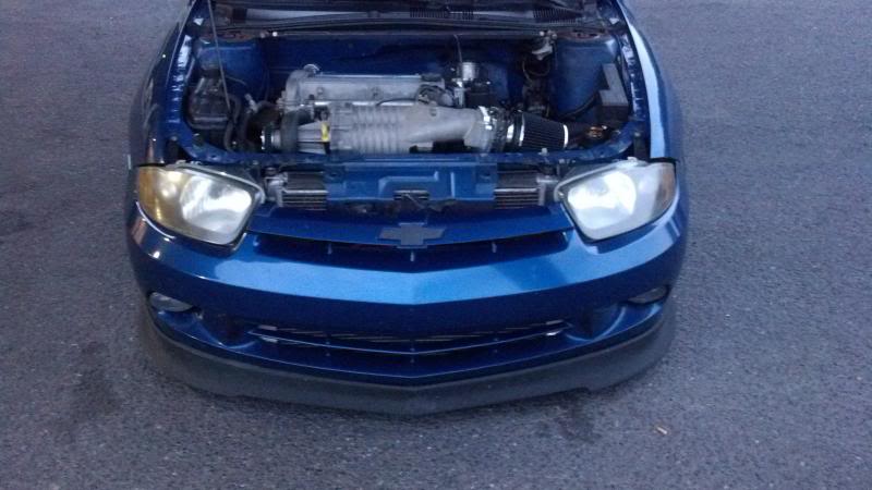

then winter happened... and now my lip looks like this:

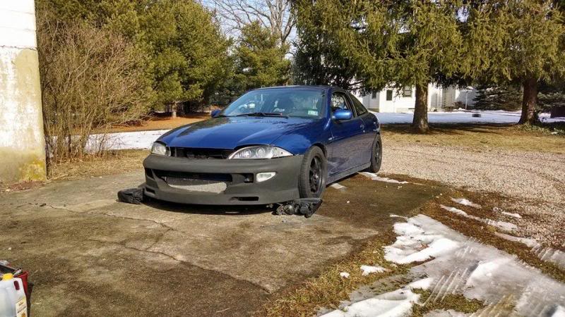

so I'm converting to the older style one-piece headlights and putting an RKsport Import Fighter front on the car.
I just need to rewire the headlights and get the right hood then spray bomb the front so it doesn't look so damn ghetto.

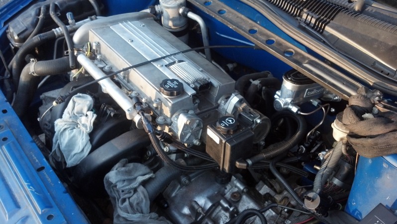

The car is running on factory Jbody electronics, so I've done a lot of special mods to get it to run.
External trigger ring for the crank signal. I built the VR sensor bracket to replace the water pump cover

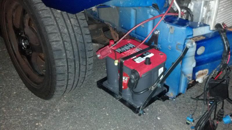

relocated the battery for more blower clearance
yes it has a wire nut... still there for now. gotta make an actual wire for this at some point

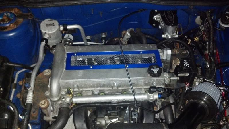

I was initially running on the L61 ignition (cavaliers come with this) but decided it sucked and I hated it and used LSJ coils and wired them up in wasted spark so the Jbody PCM can use them. since the LSJ coils have ignitors built in, this allowed me to ditch the ugly ICM and wire the coils straight to the Jbody PCM. Clean.
L61 ignition with modified LSJ coil cover:
LSJ coils wired in wasted spark with a coil cover I fabricated:

I have an LSJ in this car, so in the Jbody world we've had a few guys either swap to the LSJ head, or steal the LSJ valve cover for the L61 and modify the coil cover to fit the L61 ignition
wiring it was super easy. no tuning or anything involved
however, you may get a CEL because you lose the 'compression sense' section of the L61 ignition. you'll get PO300
for the LSJ head, their coils are ideal. bolt right on, and super easy
to use their coils on an L61 head may be a bit tricky though
