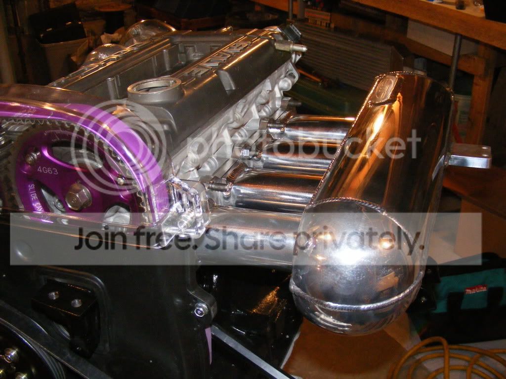

Finally almost done! I have been building my Galant VR4 for the past 3 years now and I'm reaching the dead line...hopefully spring.
Rolling chassis is complete and is awaiting this:
BLOCK
2.0L 4G63T
.20 over Manley Pistons ceramic and teflon coated
Eagle rods oil resistant coated
FFWDconnection Butcher Crank oil resistant coated
Pro-gram billet main caps
Race bearings all oil resistant coated
Brand new OEM front case, oil pump, timing components...
Balance shaft elimination kit
Oil Squirters blocked off
SCE Titan copper headgasket with built in o-rings
ARP L19 head studs
Fluidamper crank pulley
JayRacing Alt relocation
Ebay oil pan...tried to save money, will never do that again. A lot of modifying for proper fitment, but it worked
Welded -16 AN fittings on water pump and T-stat housing
Every single bolt is brand new from Mitsu
HEAD
One-off AMS ported head that I am not supposed to tell anyone about!
BC valvetrain: springs and retainers, oversized valves, bronze valve guides, low-boy valve seals ect.....
HKS cam gears and Timing belt
BC Cams 288/288 combo Lump...lump...lumpidy...lump...lump!!!
All assembly done by AMS Performance
And no, thats not the valve cover I will be using...just there to protect the valvetrain
MANIFOLDS AND TURBO
Big thanks to
http://gvautosport.com/catalog/index.php
and http://www.jmfabrications.com/site/i...tpage&Itemid=1
for the manifolds

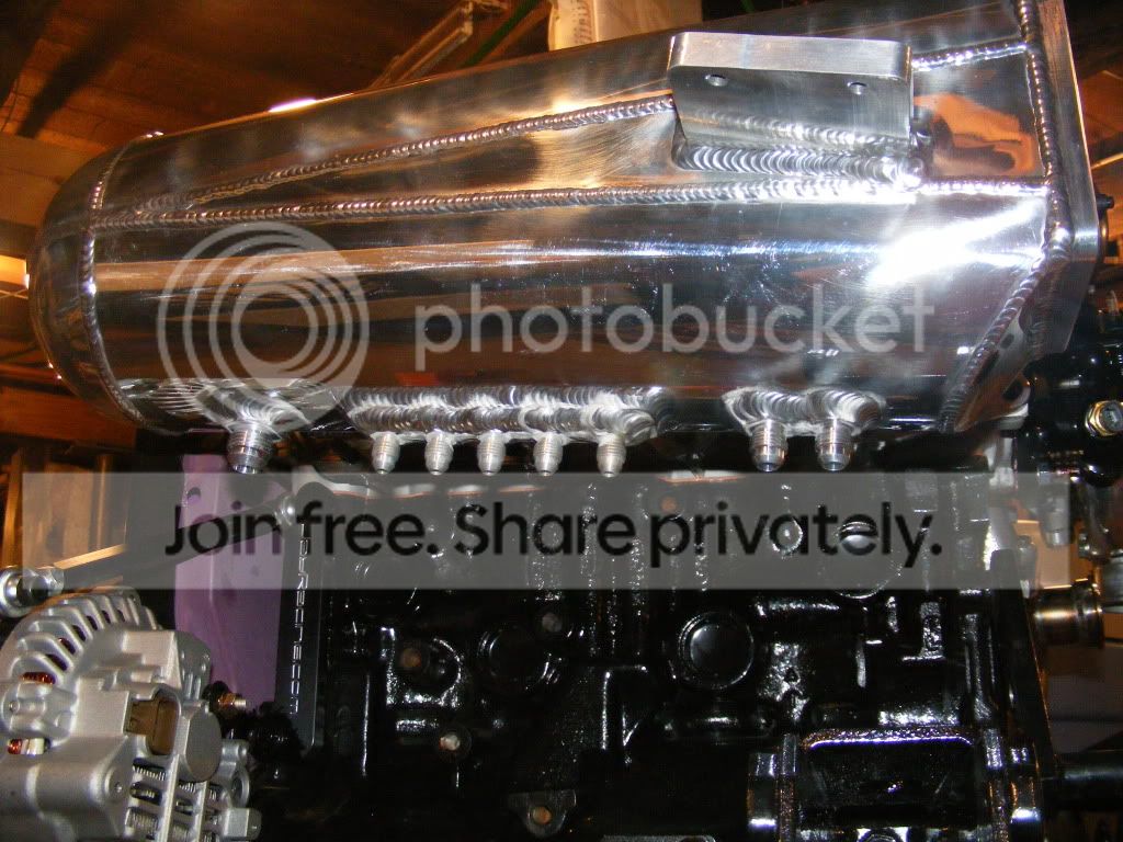

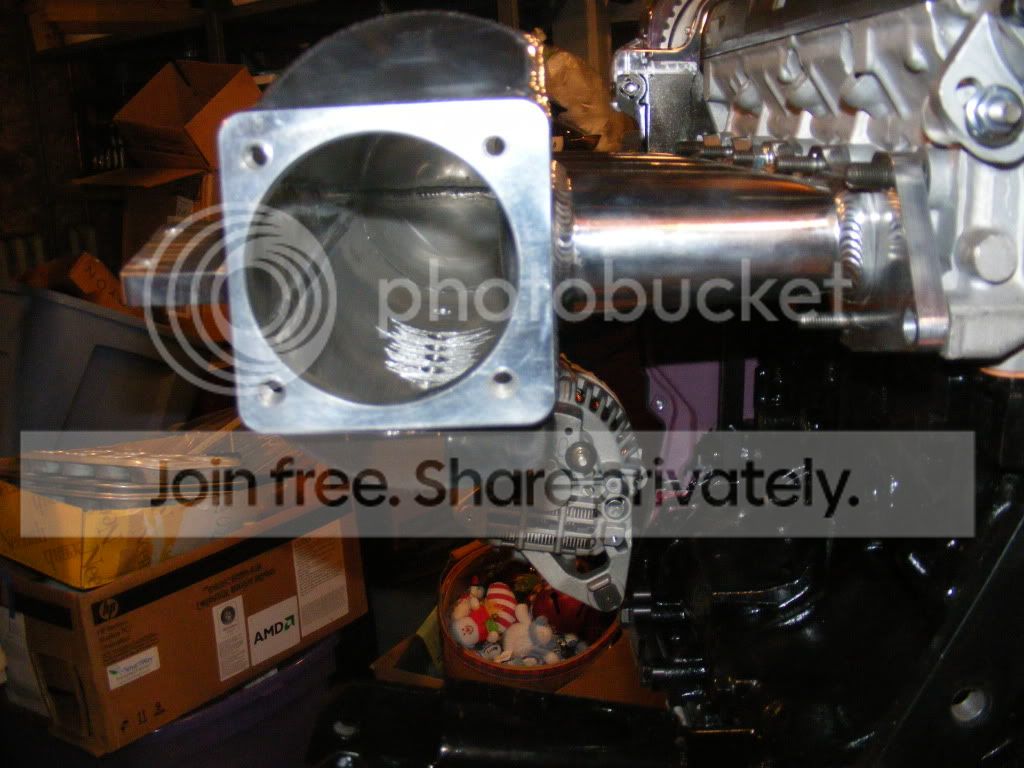

JMF Drag intake manifold flanged for Q45 90mm throttle body and AN fittings for vacuum lines

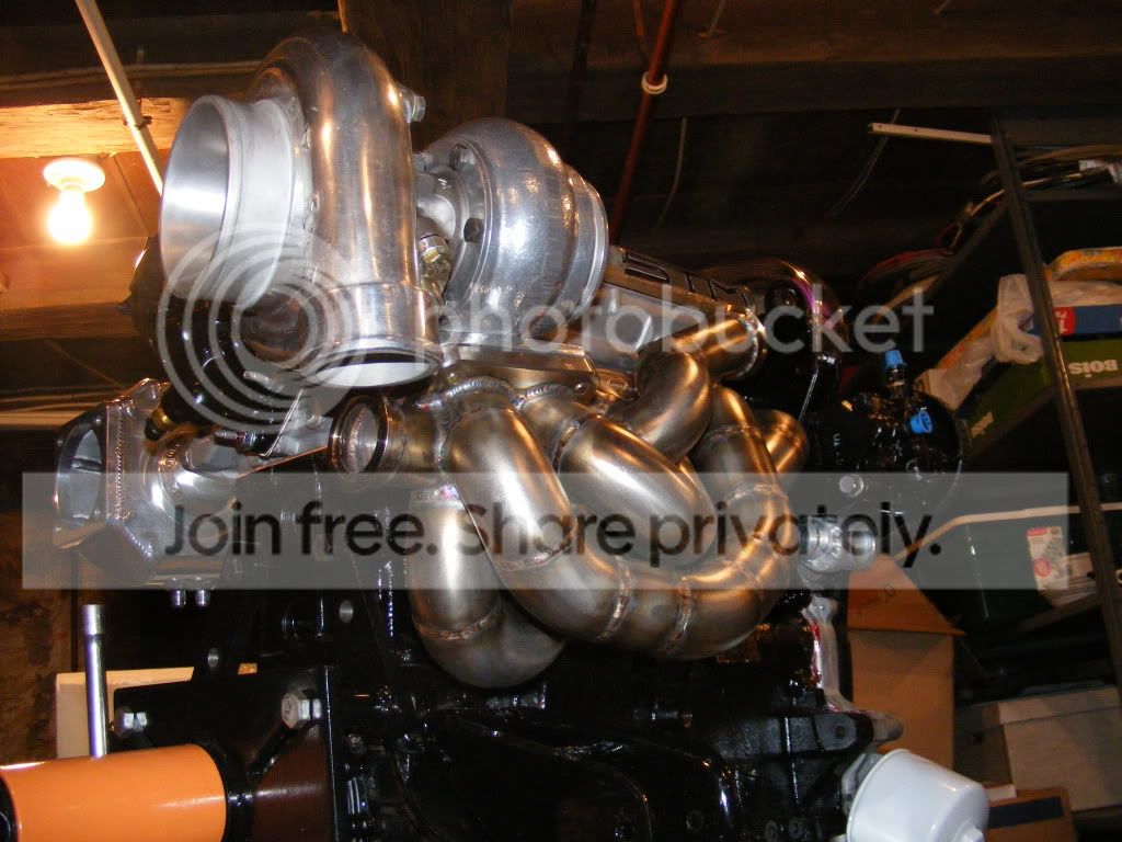

JMF top mount T4 exhaust manifold flanged for two Tial 38 MV-S wastegates
"King Kahuna" T67 T4 turbo 360 standard bearing(the only way to go)
.58 a/r exhaust housing
.70 a/r compressor housing
Supports up to 800hp

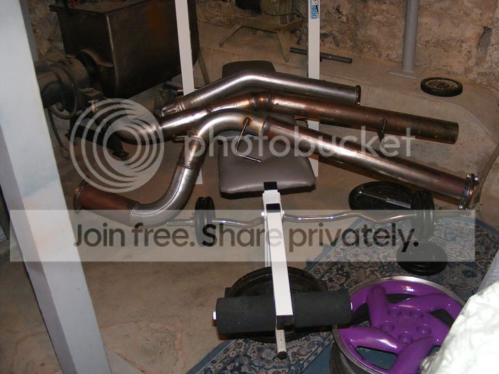

Might as well through this one in as well. My turbo-back for the balt that I had made and it's just sitting there. I had it on one for a day and took it off to get ceramic coated but never got around to it. It's a 3" straight pipe no cat. Yes its loud, yes it sounds sick. Don't hate...haters!
