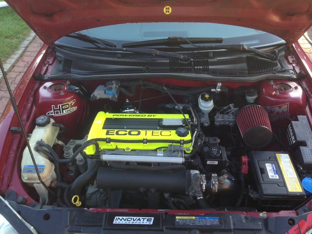

Suntank is still kicking...not to much new this year, but a few things have changed.
Biggest thing is the boost has gone up, went up from 11psi last year, to 15psi this year. The stock LE5 bottom end is holding up like a champ still, hopefully it at least lasts the rest of the season, that is a lot of boost to throw at a stock LE5 from a 63trim T3/T4. Still need to finish up the tune tonight, but its 95% there.
Re-did my meth system, wasn't functioning 100% last year, so I changed a few things and it is much improved. No pics of that tho.

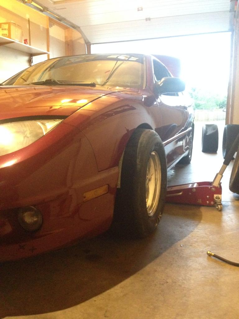

Upgraded to 24.5/8.0-13 MT slicks from my previous 22/9.0-13 M&H slicks, the 22's made the gearing way to short for a turbo car and I was having to shift to 4th in the 1/8th mile, they should also help with traction a bit
The car needed some massaging (via a pair of tin snips and a hammer) to get them to fit and be able to turn without hitting the fender...but they are in there now and it turns fine.

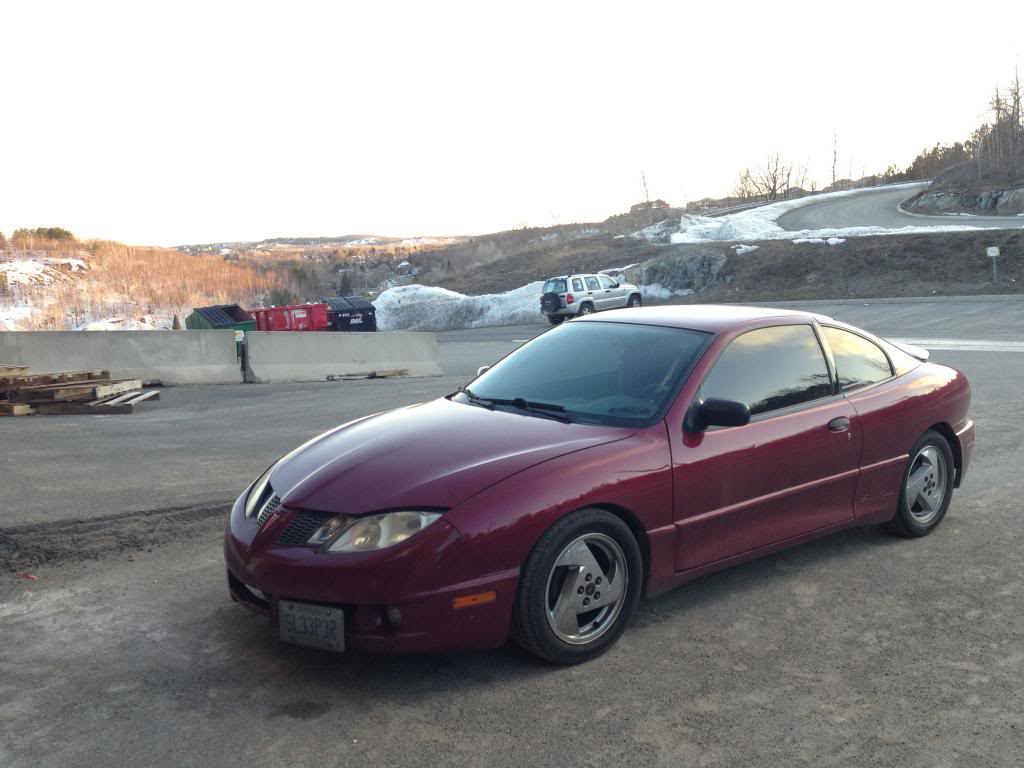

Thats about it, for those who have never seen the car before.....its an '05 Sunfire with a LSJ/LE5 hybrid I built, AMMFAB ported head, full valvetrain, cams, BS delete and a Hahn prototype turbo kit (the 20g turbo has been switched out for a 63trim T3/T4) and all the supporting mods.

On my old 22" I was getting 1.7 when it was all-motor, best I could manage on boost was a high 1.8...it just made to much power to hook. Launching at 5000rpm off a 2-step and 5psi. Car also has a Quaife LSD and the suspension is set up for drag racing.
First time running the 24.5" will be this coming weekend.
