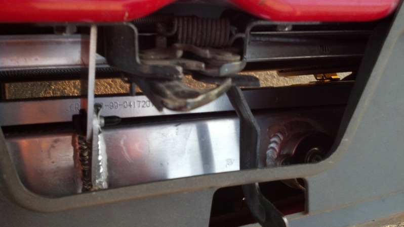

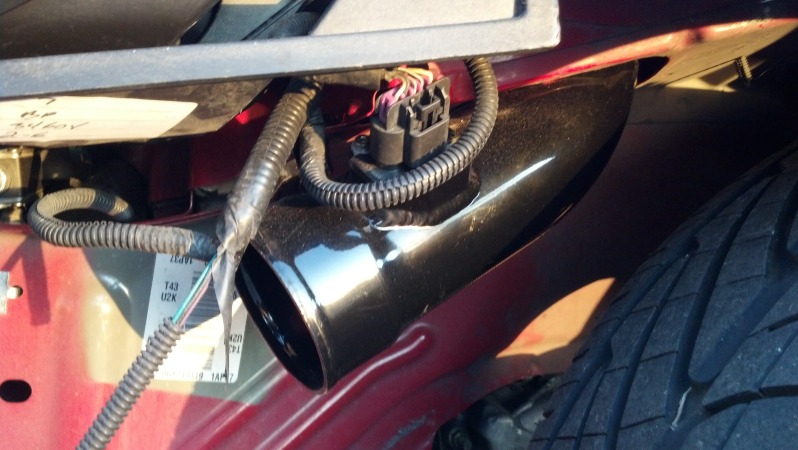

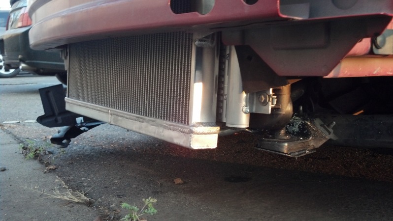

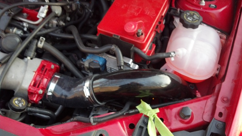

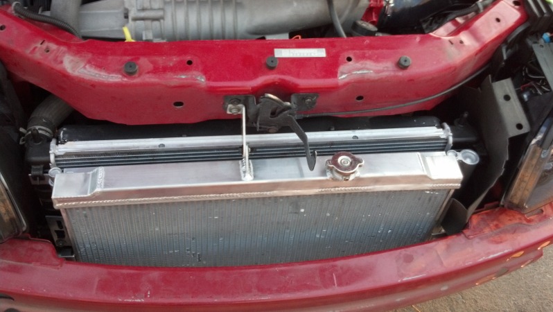

I hit that darn Raccoon and still have yet to get the car back from the shop.
Check out how massive this ZZP HE is. I excited to see some IAT2's now! I didn't even have a HE in the first place as E85 could care less....
They said the RKSport bumper and everything else will be done and ready for pickup by this Friday.

holy hell that thing is enormous. no need for a s3 h/e i presume?
Old Nov 19, 2012 | 08:58 PM
bratboy90's Avatar
Joined: 06-12-11
Posts: 1,118
Likes: 12
From: Elk River, MN
NO NEED AT ALL!!! LOLZ. ZZP claims is bigger, better, and more awesome than the Griffen and so far I agree. And it's cheaper!!!
Even has it's own fill spot. So now no need for a Option B tank as it will bleed air to the top.

Wow seems like this got off track and people are a tad confused.
In order from front to rear:
ZZP Stealth
AC Condenser
Radiator
The ZZP stealth replaces you're stock HE just like the Griffen, but it is now located at the far front...
