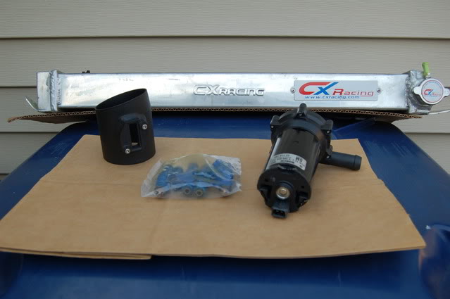

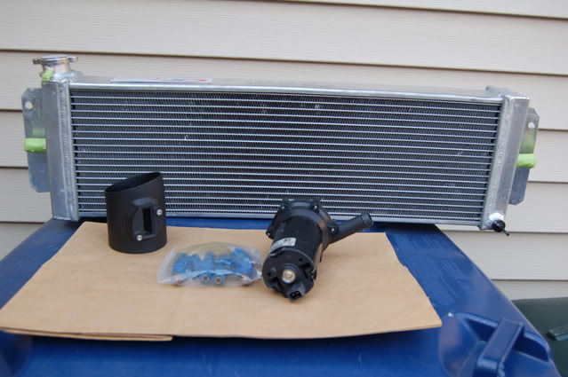

Never Assume. I know exactly what the "option b" setup is for, purging air out of the system, and the added coolant to help lower temps.
The standard LSJ carries about the same as the CXRacing one I have, I believe they are about the same.

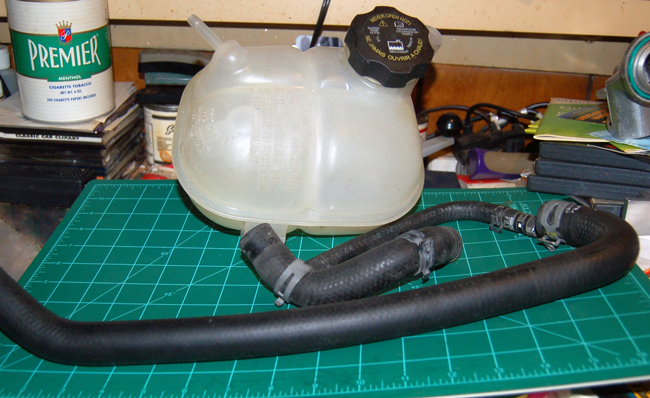

The HHR Never came with a Supercharger, so it would take alot more effort to fab the oem lsj unit inbetween the radiatior and the ac condensor, plus the Cobalt SS/SC has a dual fan setup.
I have a tank.
Trust me, I have been collecting my parts and researching this project for the last 18 months here.
To add the option B tank it needs to be higher than everything in the system to even work, right?
There is no room in the engine bay to install the little tank. To install it were you are suggesting puts it to low to effectively work. No?
And I don't see how a smaller OEM LSJ HE can cool better than the Larger ZZP Stealth HE.
