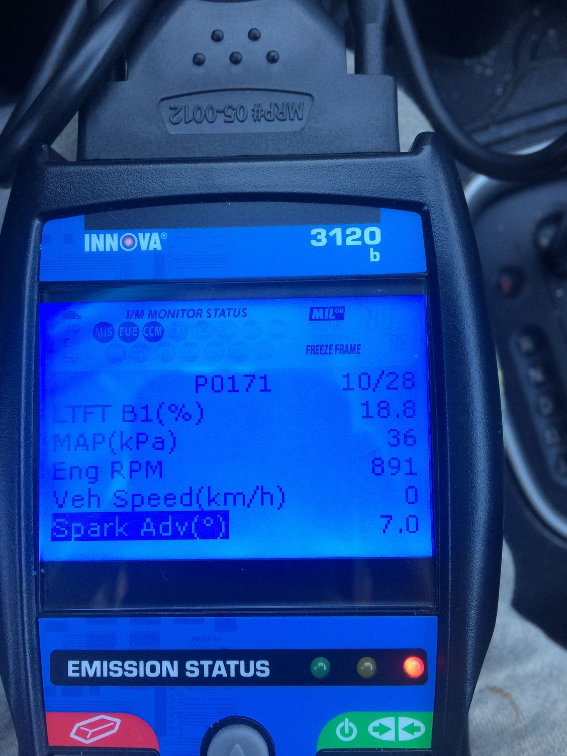

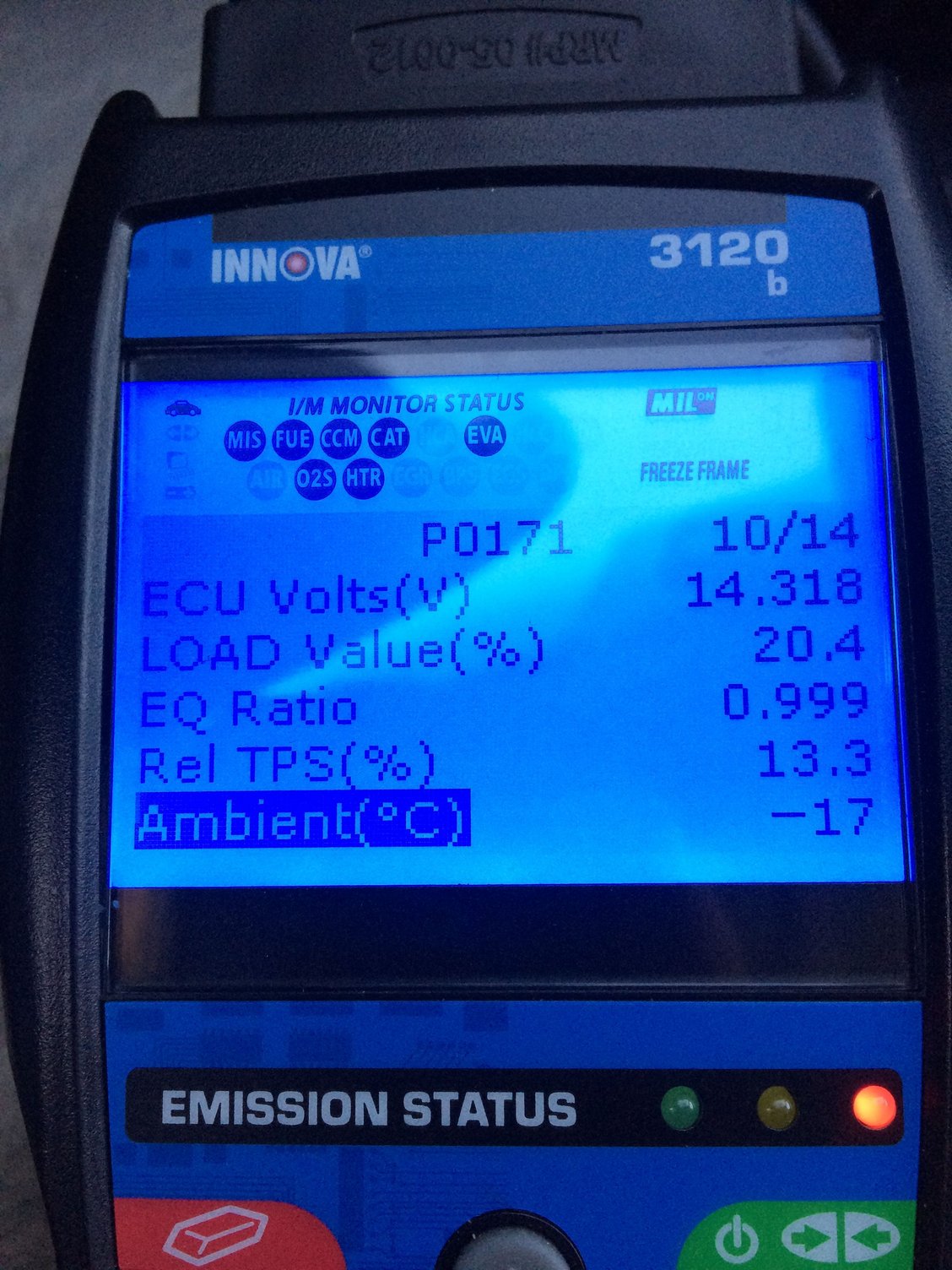

FInally able to get scan tool been busy these are pictures I got of freeze frame!

I assume those fuel trims are at idle given the 891 RPM. Those fuel trims are quiet high meaning it is making adjustments via the rear o2 sensor you are either intaking more air than it is calculating via the MAF sensor. This could definitely indicate a vacuum leak though I would think it would raise your rpms. HGT or someone that knows more about open and closed loop could probably clarify.

yes this was at idle! It’s just the freeze frame from the obd scanner ! And if someone can help me that would be amazing so frustrated

Freeze Frames are captures of the available data perimeters the second the code is set.
I notice a couple things.
Your long term fuel trim has been having to add a lot of fuel and is almost maxed out.
Your engine vacuum is very low... only 10hg. I mentioned earlier that your map sensor may be leaking or not completely inserted. That would cause a vac leak commanding more fuel and show a low reading as it is. I would watch the pre cat O2 and spray some carb spray around the manifold and map sensor looking for the O2 V. to jump up when you hit the leak.
