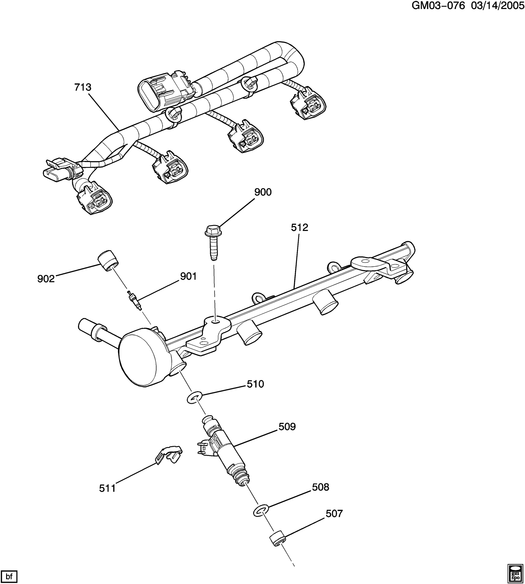

Fuel pressure regulator is in the fuel pump canister, not the fuel rail. 65psi is a little high, it should be 58.
I was googling around where the FPR was, but then starting seeing a diaphram widget on the fuel rails and ASSumed it was the regulator portion, what is that anyway?
Old Oct 24, 2019 | 04:41 PM
My understanding is that is a pressure pulsation dampener.
