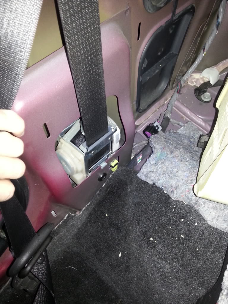

Hey everyone I was replacing the passenger seatbelt on my 2010 cobalt 2lt 2 door and I got a problem, I cant find the input plug for the black-wire (about 1 foot long) thats attached to the bottom of the seatbelt, the previous seatbelt has no black wire thus I'm wondering if I got the correct one cuz the eBay auction specified that the belt assembly fits my car however I looked around the area and under the passenger seat and found no inputs to plug it in. If someone owns a cobalt 2 door can they PLEASE PLEASE check out their passenger seatbelt assembly to see where this 1-foot black wire plugs into or take a picture, I've been at it for 2 days now, Thanks in advance.

You have to pull the carpet up. It will be located at the base of the b pillar attached to a bundle of wiring, you will most likely have to pull the bottom of the rear seat out.
It's the black, purple, grey plug. Very similar to your MAF plug actually.

Yeah I see the difference, all thanks to Wired. My problem is I don't have that plug:
[IMG][/IMG]
ALSO I found this really cool Online workshop manual, it got everything, so according to this thing the black 1 foot wire attached to the passenger belt only goes on:
2006-2008 Chevrolet Cobalt Coupe
2008-2010 Chevrolet Cobalt SS Coupe
2006 Pontiac Pursuit Coupe (Canada Only)
2007-2010 Pontiac G5 Coupe
Chevrolet Workshop Manuals > Cobalt L4-2.2L (2008) > Restraint Systems > Seat Belt Systems > Seat Belt Tension Sensor > Component Information > Locations
