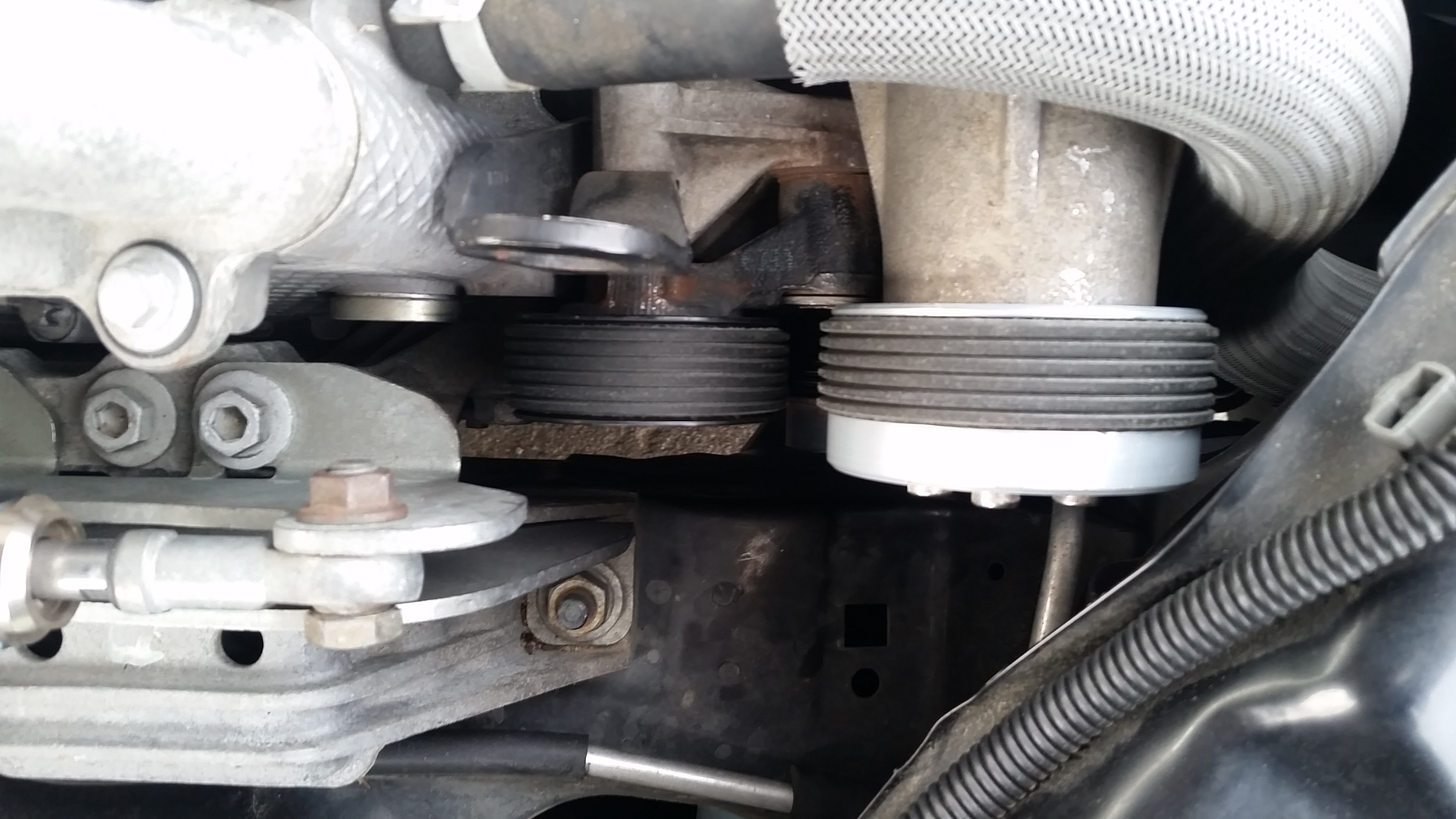

Hey guys so thanks for the help last night. So I pulled the belt off and the supercharger is making the noise and honestly it looks like the belt is not even with the tensioner but wanted to check. If that is off by a half a mm will it make a funny noise? The belt doesn't chirp or anything just a weird sound from the charger. Guessing I need to back out a tad but not sure how far is too far or to far back?
Then the check engine light- I got the zzp kit with new computer and it ran like crap and still has a check engine light on. Do these straighten out the more miles we add and drive? I went and checked the codes and it shows air/ coolant emp sensor. The only thing I haven't gotten to was the plugs that came with it. That wouldn't trip the code right ir would it? I addef pics bit if they didn't show I'll add again I'm driving and this phone sucks.

fix the belt alighnment problem fixed then get it tuned
and make sure you plugged the temp Sensor back iN

Got that sorted out now just gotta get the pcm issue straight. Had some sparadic idLe issues going on and wasn't sure if u plugging battery for 30 mins or so would help clear some of the issues when swapping pcm
