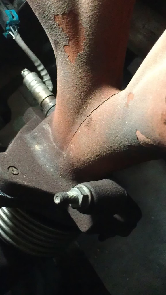

Question cracked exhaust manifold.
Can it throw lean code p0171? I can hear a buzzing sound sometimes when I step on it on cold starts

Hope ya can see the crack above the numbers

I can see it. not sure if it will affect you much.

Yes an exhaust leak before the o2 sensor can give you a lean code. When u get off the gas it pulls in air and throws the code

Well after receiving mongorat's mani I decided to replace the cracked one
Removed heat shield and this is what I found Name:  IMAG0455.jpg

yup, thats cracked, ha
