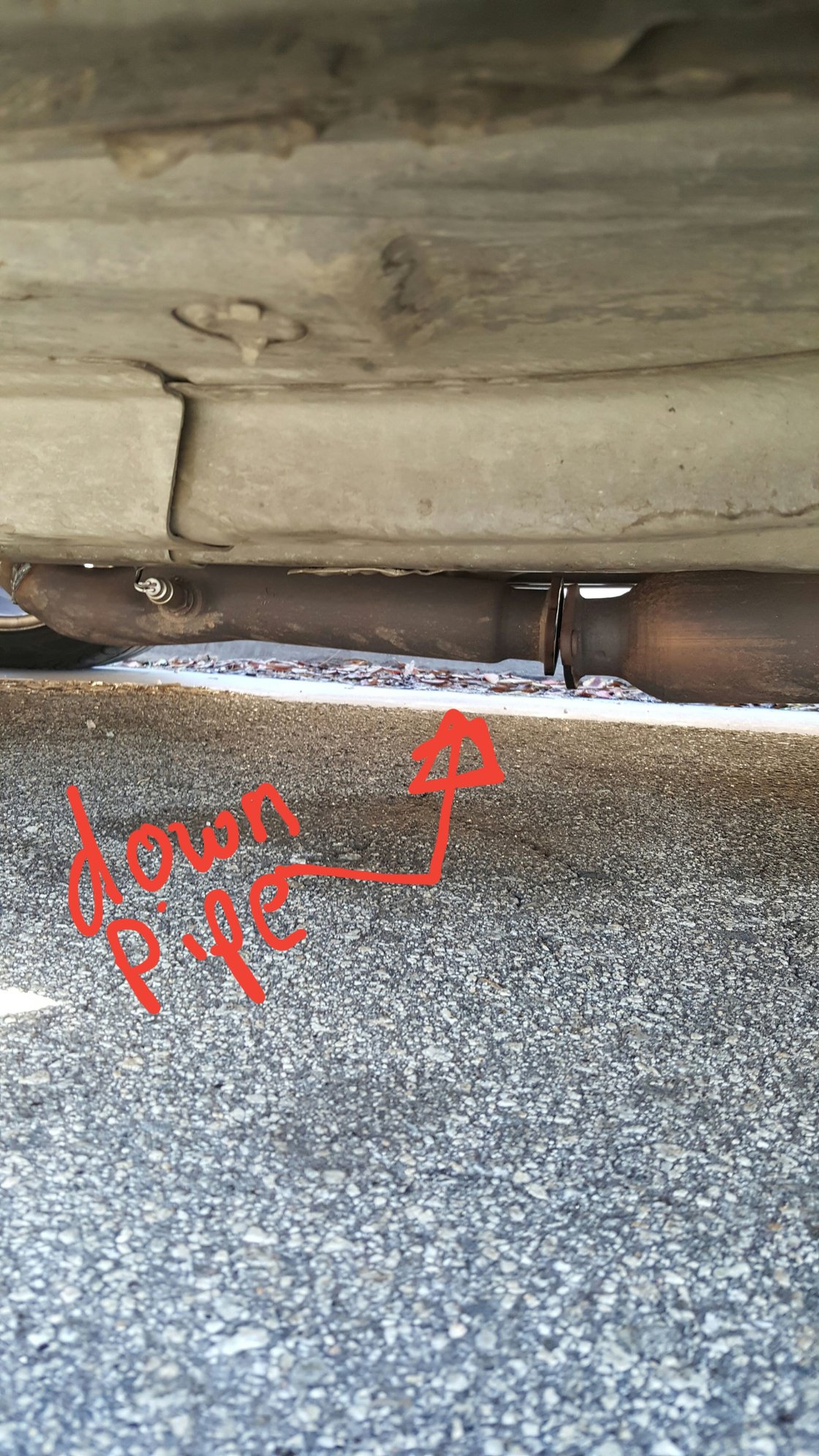

Idk how this happened. Don't ask. Drove home one day and when I got in my car the next day I noticed it seemed louder. Thought maybe I was imagining it. Next day I get in my car and its LOUD. Like straight pipe loud. I get on the ground and look before I came to work today and this is what I see.

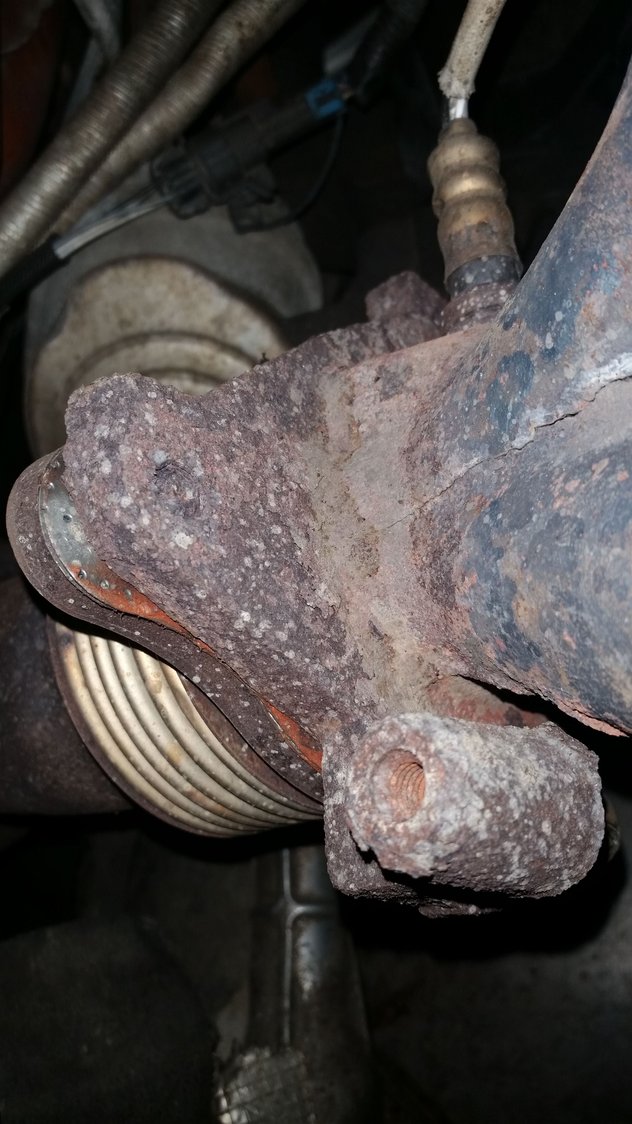

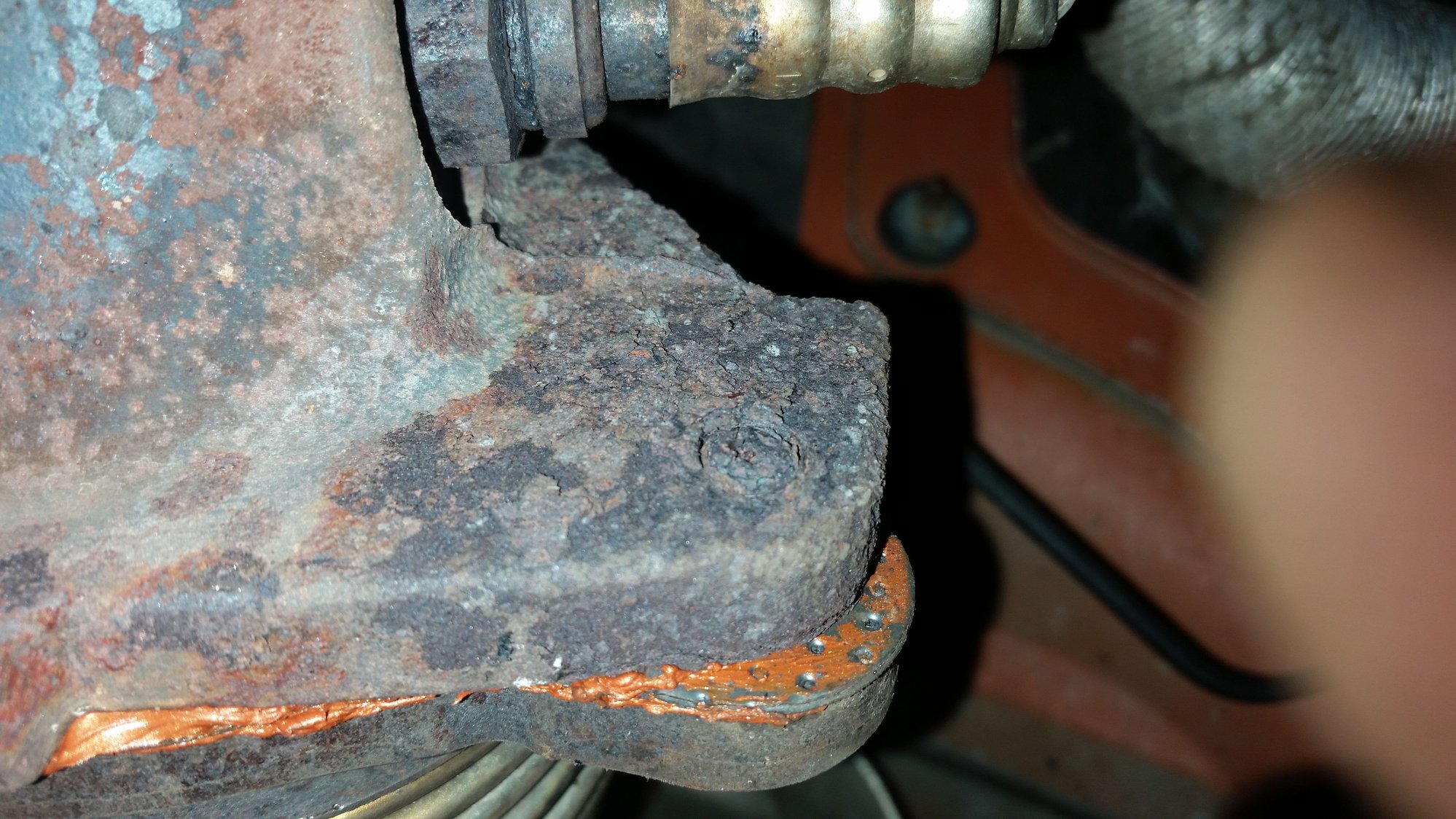

Bolts look snapped. So this weekend I'm gonna go to AutoZone and grab a new gasket and rubber hanger. But hoping I can get the two halves of the bolts out, what size do I replace them with?

If you have access to an air hammer or a large punch you can knock those out. They are usually just held in with splines like a wheel stud. Depending on the hole size either a 10mm or 12mm bolt will fill it nicely.
Edit: Heat helps a lot, a MAPP torch will make removal of the stud heads easier.

in my experience, to hammer those studs out your going to need to support the back of the flange somehow or it will just bend. i find its a 50/50 chance if they will actually hammer out, or if you gotta end up drilling them.

Especially if you want to run the risk of breaking the studs off the manifold side of the downpipe.

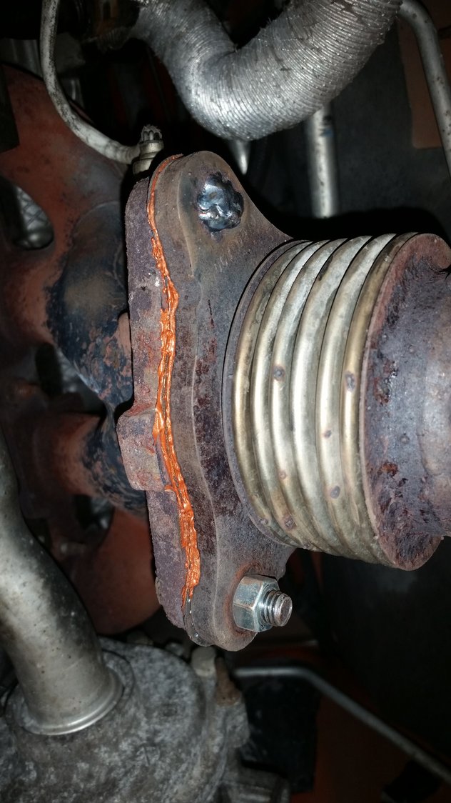

Originally Posted by Platinum_Injected
yep that sucks!!! I got some exhaust work to do myself lol dammit
Holy corrosion Batman. That's intense haha. Do you love right by the ocean?

You will be much better off with bolts and nuts through the whole assembly. Coat liberally with anti-seize when you install so the next time it isn't so bad.
pretty much lol... in nova scotia Canada surrounded by water... but that's just the header... notice the big crack in it!!.. got the car second hand.. new downpipe on it though lol
It's possibke. I think the rubber hang down might've broke off and caused it to hang too low and I hit a bump or something and that hinge got snagged.
What if instead of drilling out new holes and putting just bolts.... I put bolts, washers and nuts?? Any reason that wouldn't work?
EDIT: It seems like that's what Platinum did from his pictures above.
I bought my car second hand... I wouldn't go by that mess... dude was wacked more I look over the car lol... but suppose bolt and nut could work
