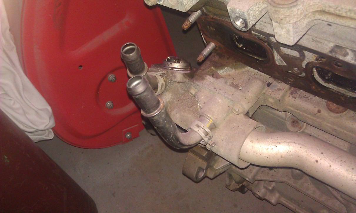

Your header shouldn't be in the way.
The thermostat is on the far left of the engine in this picture, well clear of the exhaust manifold and components.
Oh, just found this for you: 2.0 LSJ Engine: how to: replace thermostat(with pics)

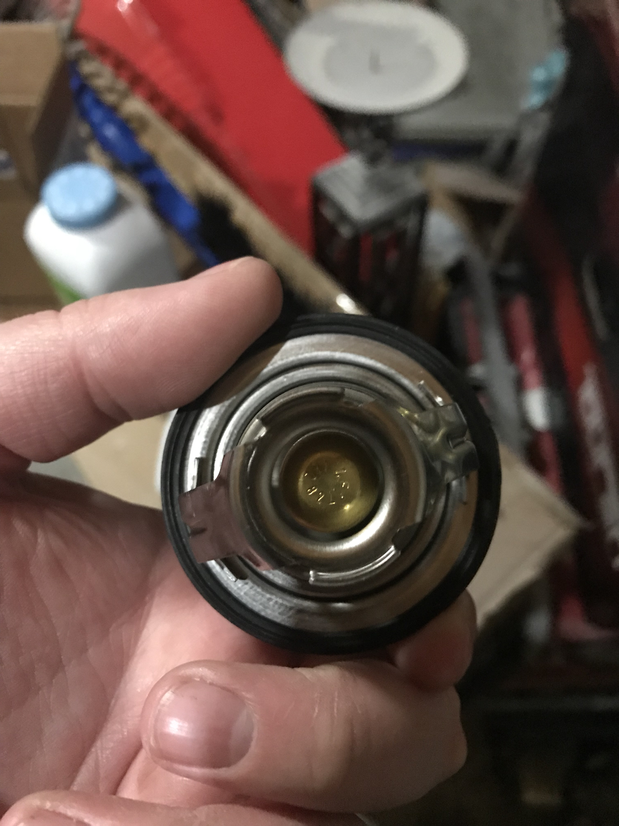

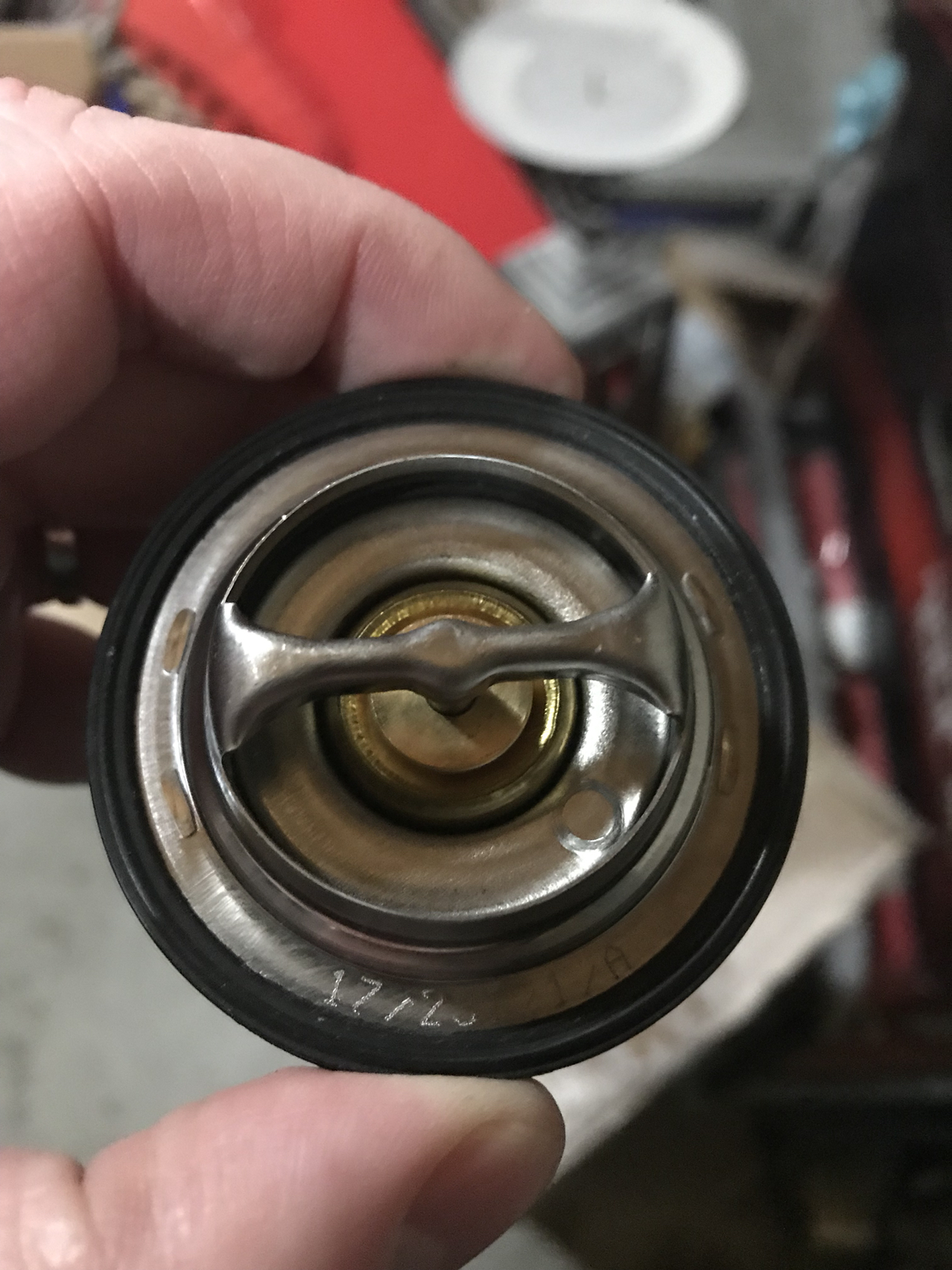

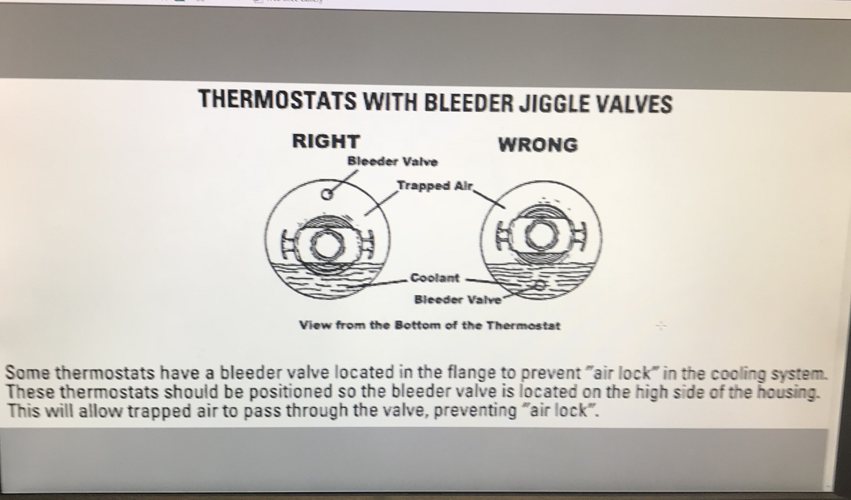

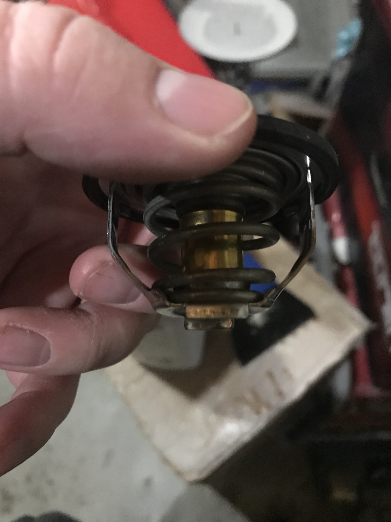

Hey guys I got my new TSTAT in the mail today from rock auto however my question is should I be able to see the bleeder jiggle valve that I paid extra for ? According to their diagram it should be on the underneath side, pics below let me know what u all think. The part number on the box is correct as it did match up with what's on their site.
Old Jan 24, 2018 | 08:07 PM
  #79
Henry3959's Avatar
Joined: 03-17-17
Posts: 0
Likes: 96
That T stat doesn't have one but I wouldn't be worried.

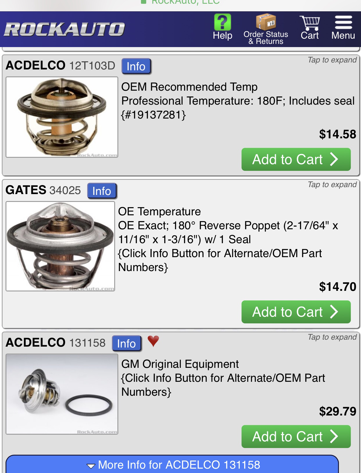

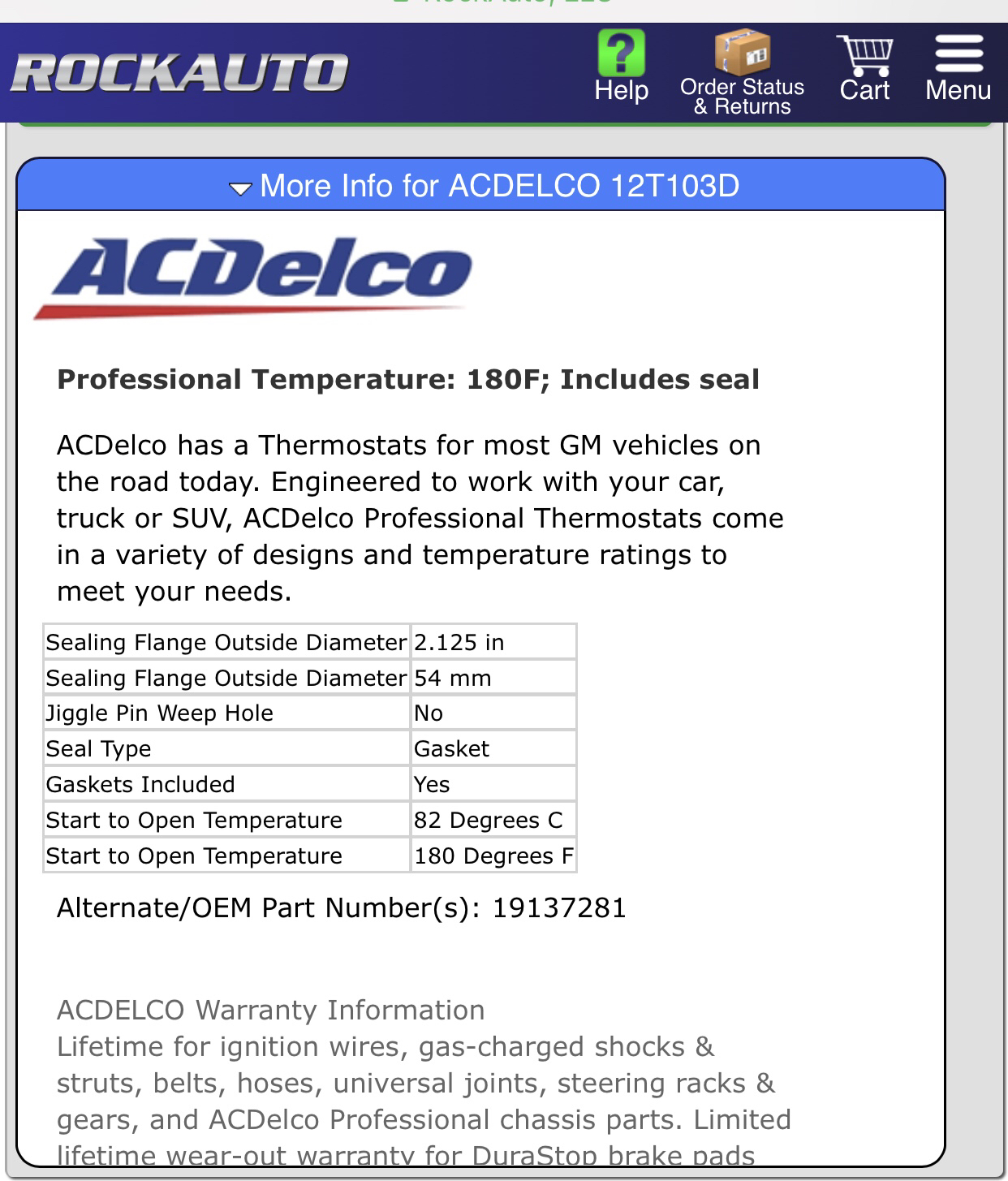

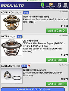

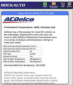

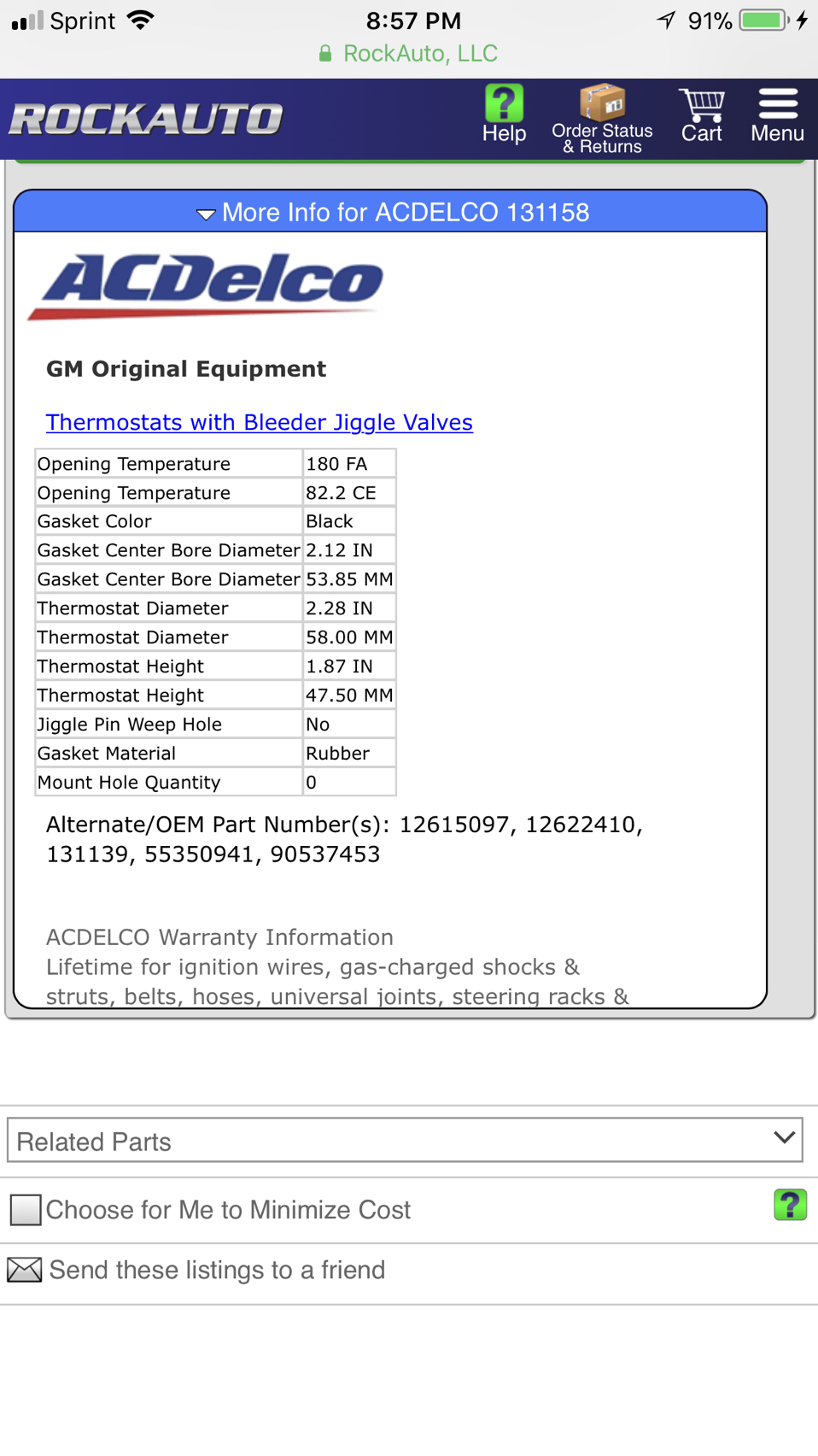

Thanks HGT I guess my concern is that as you can see from the pics below Rock auto had 2 different ACDelco models one was for $15 & the other double the price for $30. I paid for the $30 one & the only difference that I could see between the 2 was that the more expensive one had the bleeder valve. I may need to ask for a refund not sure
Old Jan 24, 2018 | 09:09 PM
  #81
both say no jiggle pin weep hole.
Old Jan 24, 2018 | 09:31 PM
  #82
Doug's Cobalt SS SC's Avatar
Joined: 02-02-15
Posts: 355
Your right E I see that now however up top it says it has it & then when you click on it has a diagram. O well just wondering why the one I got was double the cost, hopefully it's good quality
