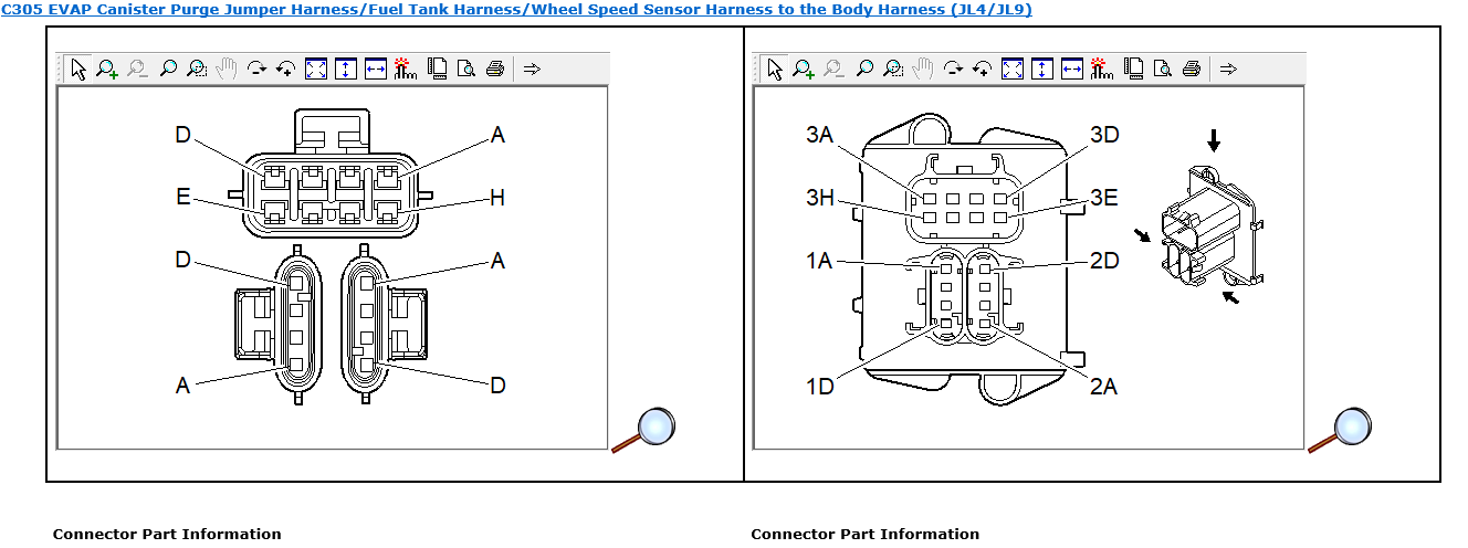

it is in the tank and it attaches to the fuel pump. You can test it by disconnecting c305 and ohming the terminals there and see if your getting a good reading after you have filled up. C305 is the connector that is on the passenger side, rear of the tank, on the body.
#16 on the picture below, this view is from inside the vehicle looking down. arrow pointed toward the front.
#2 in this picture, this view is of the rear axle looking toward the front of the car.

Ohm between b and d terminal on the 8 way connector, female side (harness connector, not the body side mounted connector).
In the pic its the left top one, the connector in that view is with it facing you with the retention tab up.
terminals go as follows
___I---I___
| D-C-B-A |
| E-F-G-H |
Old Apr 5, 2019 | 04:53 PM

awesome. thanks for all the detail and diagrams man. i appreciate it.

np, if you have and questions just ask. Those readings again are completely empty and completely full. In between is not gonna be accurate since you wont be able to physically see the sensor without pulling it out. Since you have a reading full issue then fill it completely full and test it, should be close to 230-250 ohms
