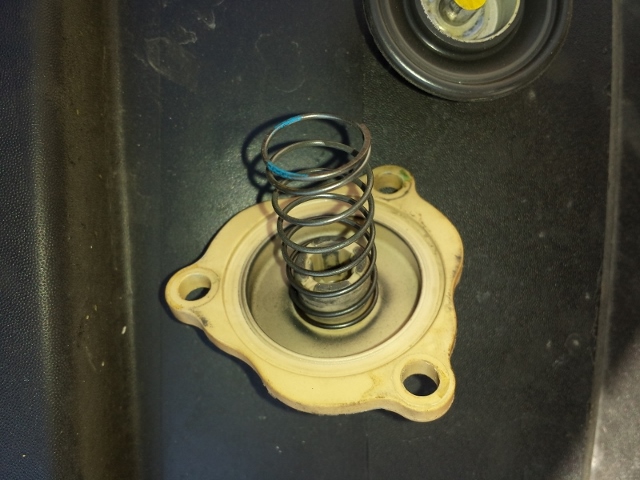

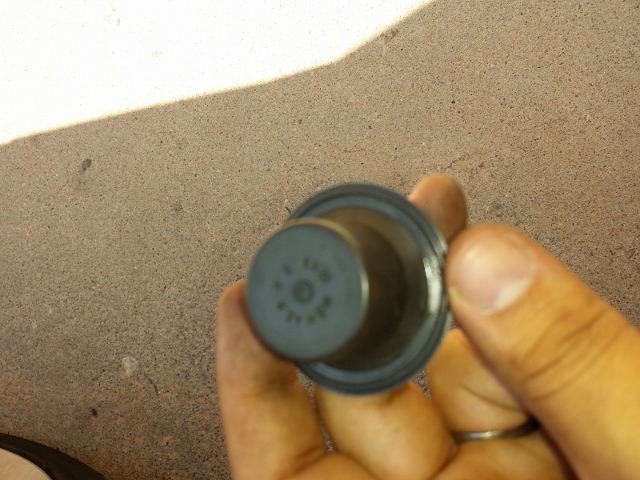

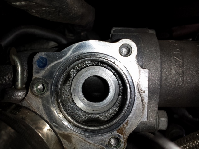

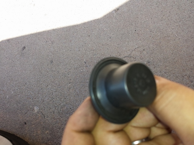

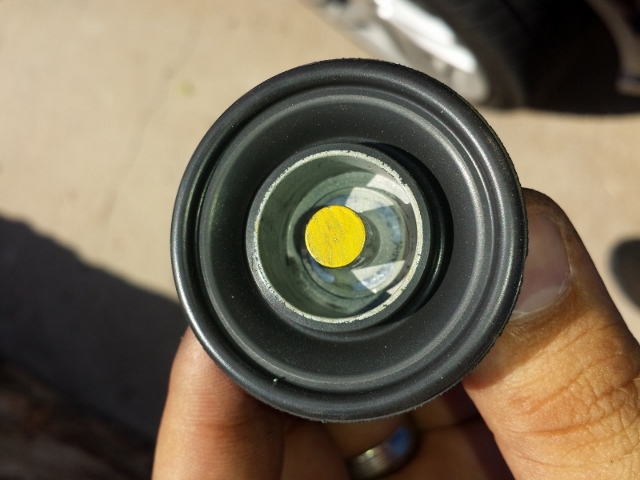

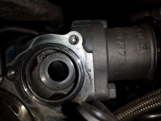

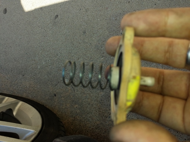

Well im thinking im getting some problems with my stock bpv such as really bouncy afrs and what i would say flutter sounds. I might be wrong well I took it out to check it and that's how it looks. Well I noticed some marks on the bpv it self and one where it goes (blue dot) so im thinking it has been serviced before. What can I check to see if its bad other than to see tears ( didnt see any) could the spring be bad? Any help would be really appreciated thanks. Posting pics in a few minutes

i see nada.

Looks fine to me. If u think its bpv related it's more than likely the bpv solinoid going or its ur vacuum tank going. Issues with bpv opening when it shouldn't, that iv had, was vacuum tank was bad, bypass it
Forgot about that tank. Took it out at 1k miles. 6 years ago. It's a good place to start for diagnoses.
Also, make sure to check that your Evap purge valve on the intake manifold is still good with the blow test. Matter of fact, replace it anyway. The purge valve may be bad and not set a code yet.
