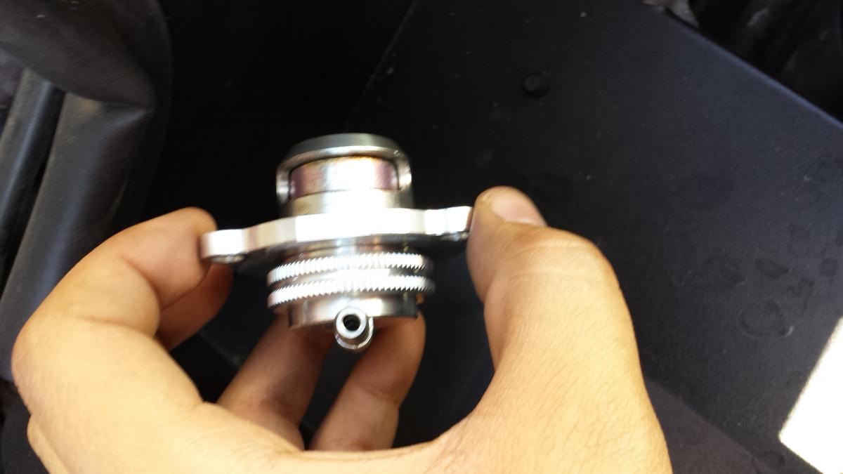

Ok got the forge bpv just not sure how i should install it. With the fitting for the hose facing straight down, or to the side
Opening points down from instructions I believe.

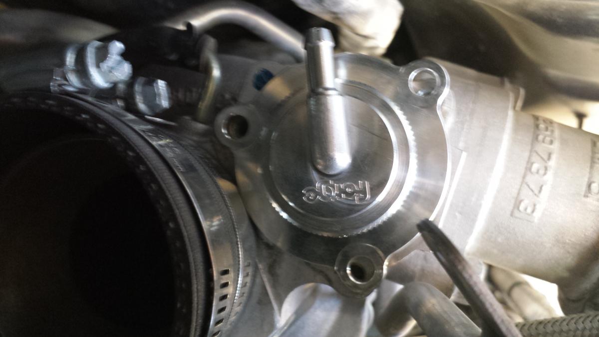

Well I tried to place it facing down but the didnt seem like it was going to work like that once I connected the vaccum line there didnt seem to be enough room to connect so I placed it facing up facing the engine

Feel inside the bpv port on the turbo, ull feel a hole for the bpv air to go that lead pre compressor, the opening on the bpv must point same direction as the hole in the port is located. Otherwise ur vented air will just hit the port wall and not get vented

The hole in the port should be on the side closest to the intake of the turbo

Well just looking at it i see the hole on the bottom and i can feel another opening in the top. The opening on the actual bpv is directly behind where the bpv hose connects

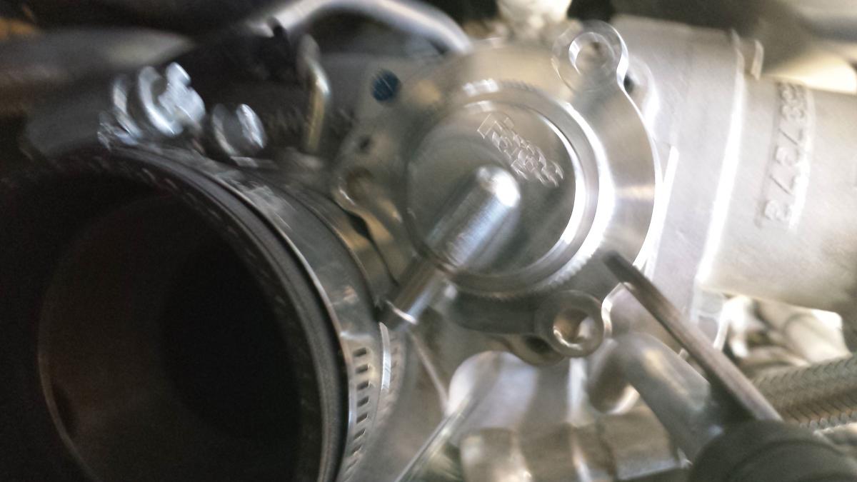

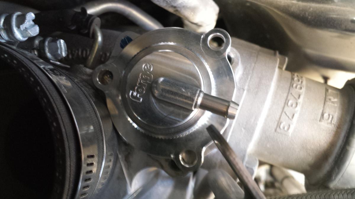

Ok so thats what im saying the vacuum line connects to that and the opening on the bpv under it on the inside part of the bpv
Position 1 the one i have on facing the top and engine
Position 2 what im thinking its the way it should be but i dont see enough room to connect the vacuum line.
position 3 the least likely in my opinion but i could be wrong(facing the firewall)

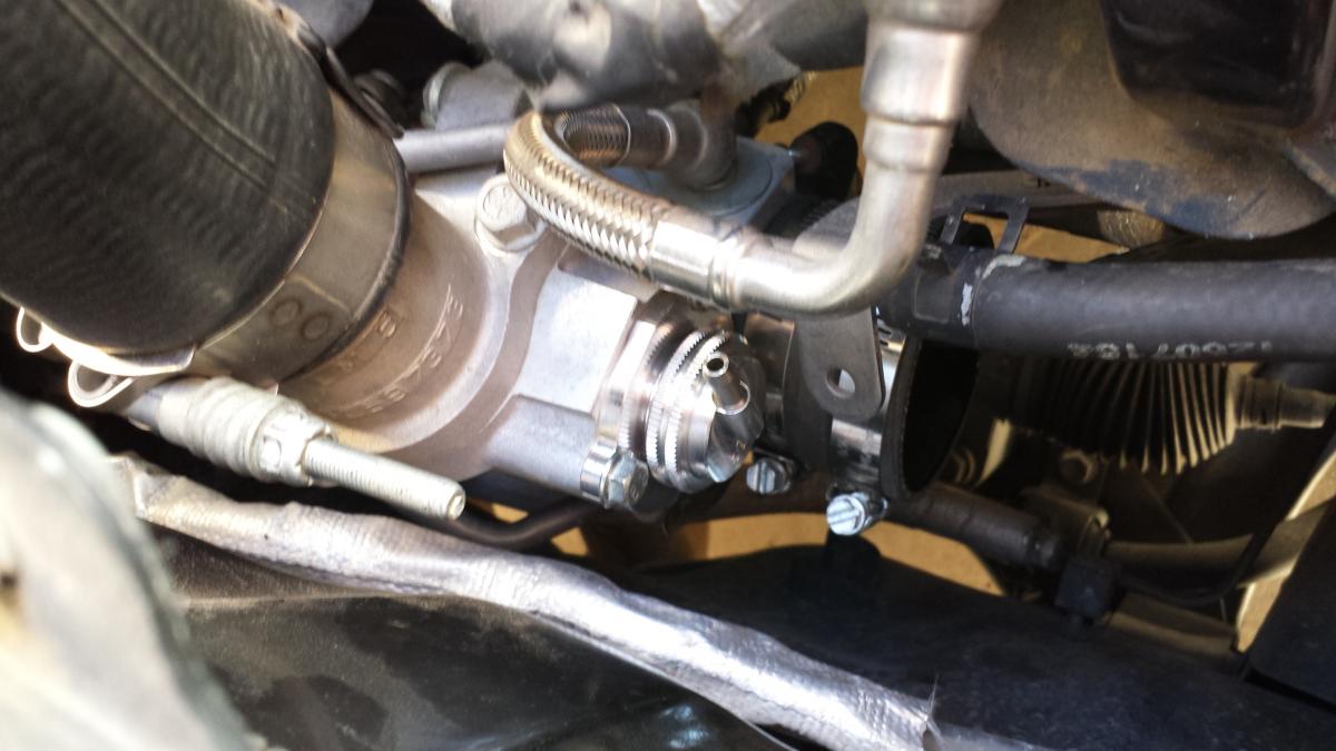

Nevermind found the problem. Didnt notice i can change the way the line gets connected so what i did was unscrew alittle like if i was changing the spring the move it to the position i wanted to so i could connect the line and now the fitting inside is facing towards the floor the way it should. Now i can connect the vacuum line and no problems thanks guys . I see now i probably wasnt making sense lol
