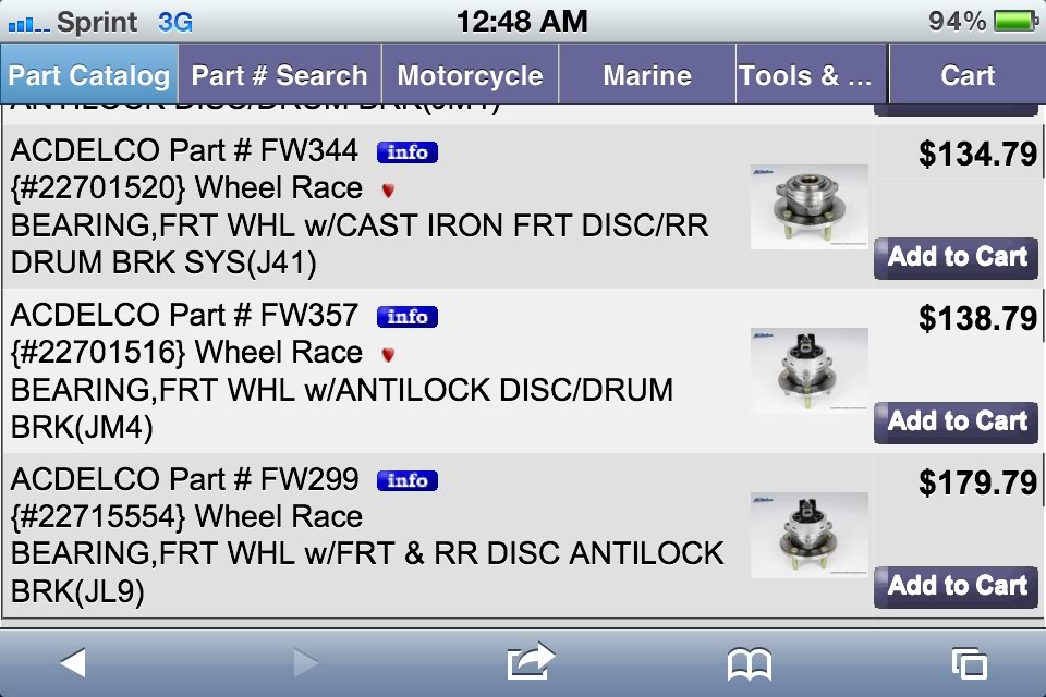

I'm beginning to believe its the wheel bearing tbh. It's now starting to hum when I get on the highway and it's only coming from one side so it's not the new tires. Anyone have an idea how much labor is for that or is there a how to? I'm gonna buy an AC Delco wheel bearing from Rockauto
Which one is it?
I'm guessin the last one. Js

try jacking up the car and grabbing the top and bottom of the tire and try to push and pull the wheel. if there is any play there. ur wheel bearing on that side needs replacing.

its not a bad job, but in order to replace the bearing, you have to buy a whole new hub which is like 150. 20 minute job. make sure you have a large hammer to get the old one off. over torquing the lugs wouldnt have anything to do with the bearing.
