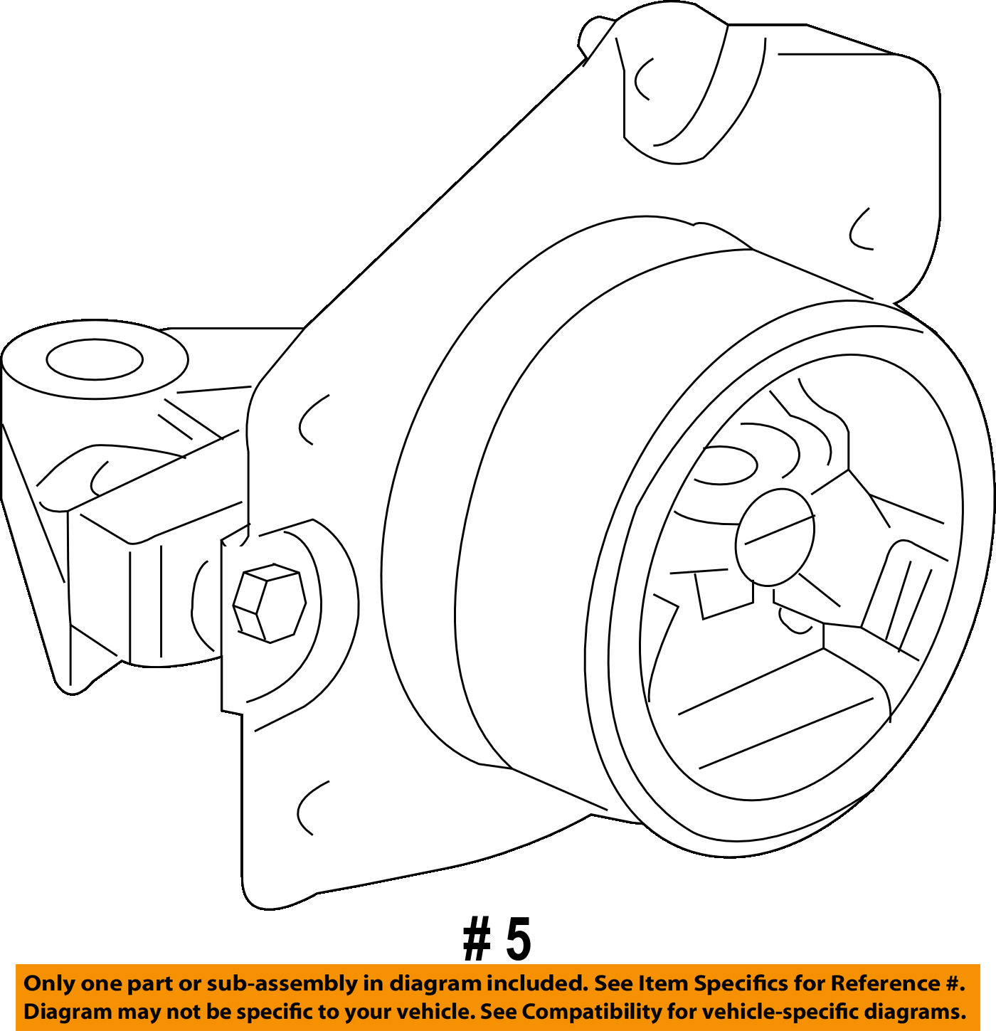

So I went autocrossing over the weekend and had an absolute blast. But on the way home I noticed that there was a creeking noise everytime id go over a bump or turn at parking lot speeds. The motor or transmission mount thats underneath the electrical box is the only one that I can see is torn.
Anybody know the name of that specific mount?

Is that the upper trans mount you speak of? You have an upper, front and rear trans mount.

Im not sure...Its on the driver side, underneath what I think is the fuse box

There are 4 mounts.
Front and rear transmission are both under the transmission.
Front engine is under the airbox on 2.2/2.4 and 2.0Turbo cars.
Upper transmission is under the fusebox.

Originally Posted by YelloEye
There are 4 mounts.
Rear engine is under the fusebox.
your info conflicts with gmpartsdirect and the diagrams for our cars.
I did leave out the engine mount but that's not what he was asking about.

alright so its the rear engine mount

no upper trans is under the fuse box. the rear trans is near the sway bar. front trans mount is bracketed to the front end of the cradle. the engine mount is on the passenger side typically found under the NA airbox if you have one and I don't.

Sorry, not the rear transmission mount, it's the upper one. GM PN# 25829028

I actually just looked this up myself. For anyone wondering, part number 25829028 is for cobalt ss with an auto trans (2.4 maybe? Im unaware if the supercharged or turbo cars came with auto transmissions). the part number 15835312 is for 2.2 cars with a manual transmission.
