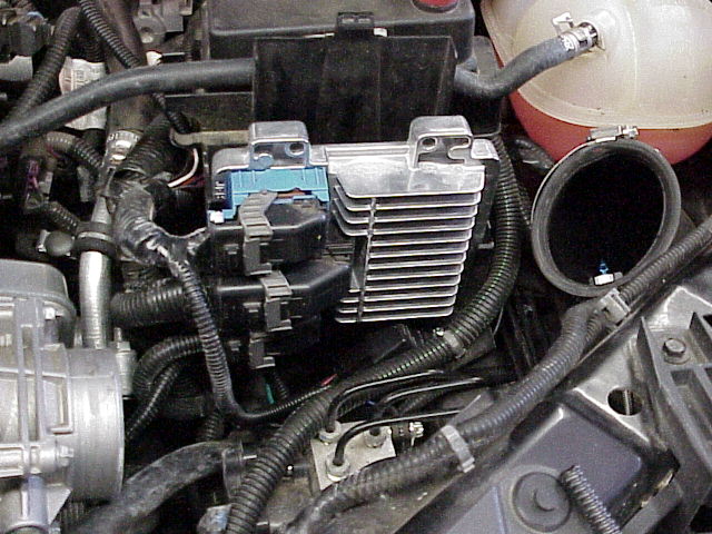

ECM is the engine control module. It's under the hood, probably near the fuse box. On an LNF and LSJ it is. BCM is body control module. On your car it should be passenger side of the console. Not real sure what a PCM is, exactly.

top BCM bottom PCM, TCM is behind the PCM, smaller module.
Did all of these codes appear at once, or is this a slowly developing issue that never got corrected? I know you read my post when i first got my car i had 13 codes on my computer, it needed two VVT solenoids, a map sensor, and an o2 sensor and fuel injectors and spark plugs to get it back to normal from just a general lack of maintenance. But your car seems to be showing a communication error.
It's possible that your PCM is bad, but on such a new car i tend to steer away from things like computer failures unless you had a corrupted tune file installed by accident. BCM's are 137.99 new on rockauto.com , id try to find a used PCM on ebay see if you can spend under a 100 bucks and start from there. Assuming you dont find any blown fuses or frayed wires near the connectors. (its unlikely that you have a bad harness unless its rubbing near a turn or an open portion of the harness)
If replacing those doesnt fix the issue then you should try replacing the two biggest components on that failure list. The CKP is probably the single largest issue there that can cause multiple CEL's. The VVT solenoids can throw all sorts of other issues related to airflow and traction control.
