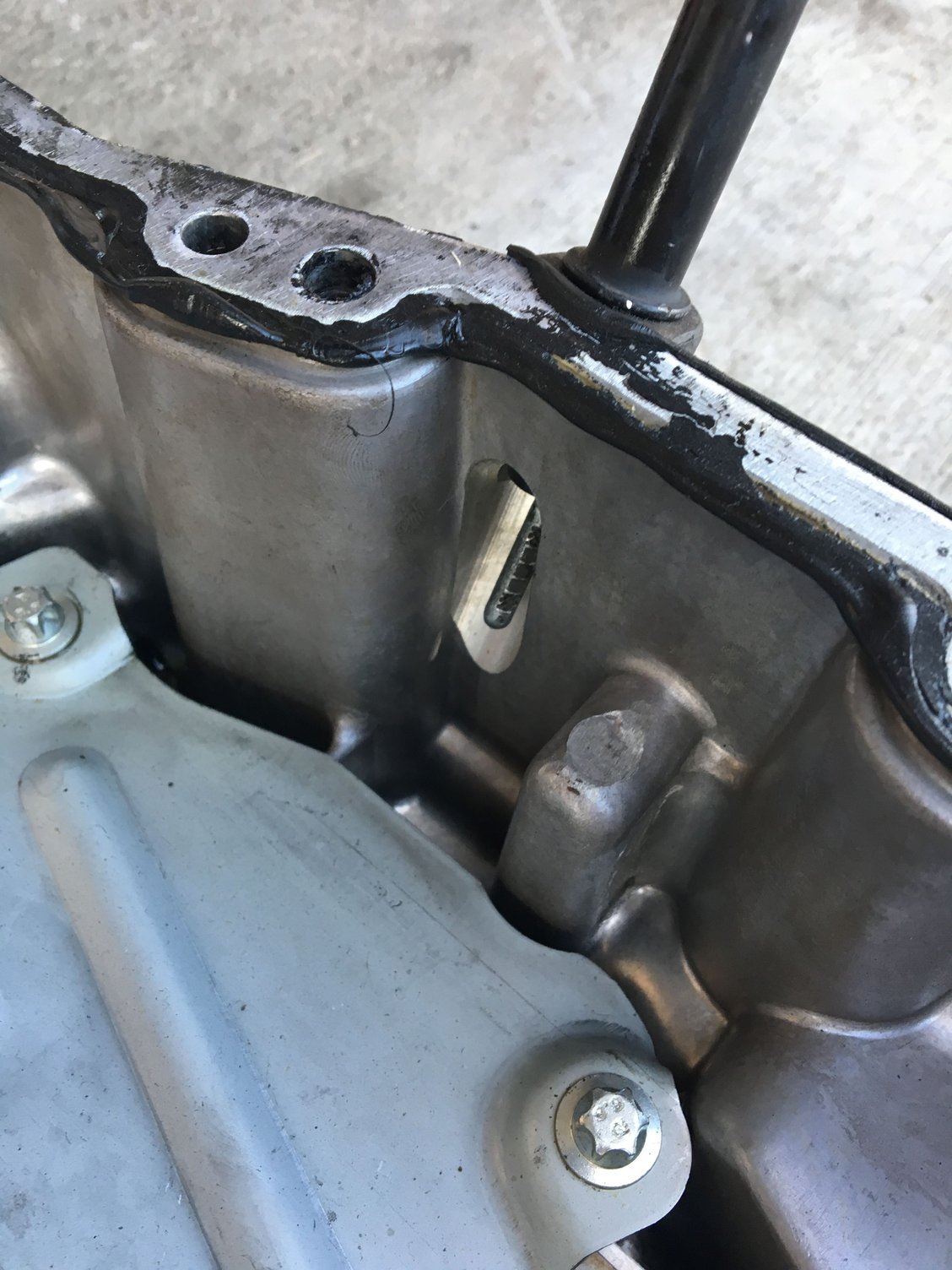

I thought about that. The dipstick is not necessarily in the lowest part of the pan, so question is if it would get all the oil out (or at least almost everything). I have a picture somewhere of my LDK trap door oil pan before it went in, but i have no clue what the VW pans look like on the inside...

Found the picture of a stock LDK oil pan. This one came off my new LDK engine which explains the sealant but no oil residue in it
Clearly here the hose would easily reach down to the bottom although the dipstick doesn't get that low.

I use my mityvac at work on merica. But that's because the drain plug stripped years ago and I sealed it up. I see no issue using it on a cobalt so long as the oil is changed frequently, the car is level and leaning back slightly, and you use a straight stiff hose that will bottom out against the corner of the pan without bending. Your gonna get about the same oil out as draining it when level with the plug and not waiting a hour for it to stop dripping.
