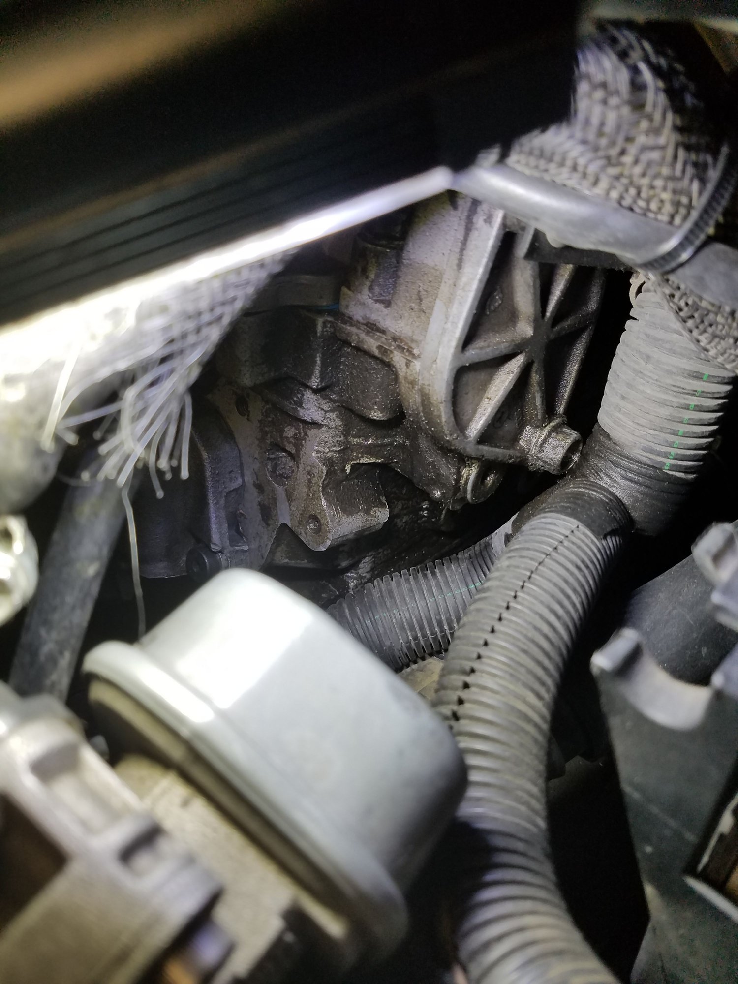

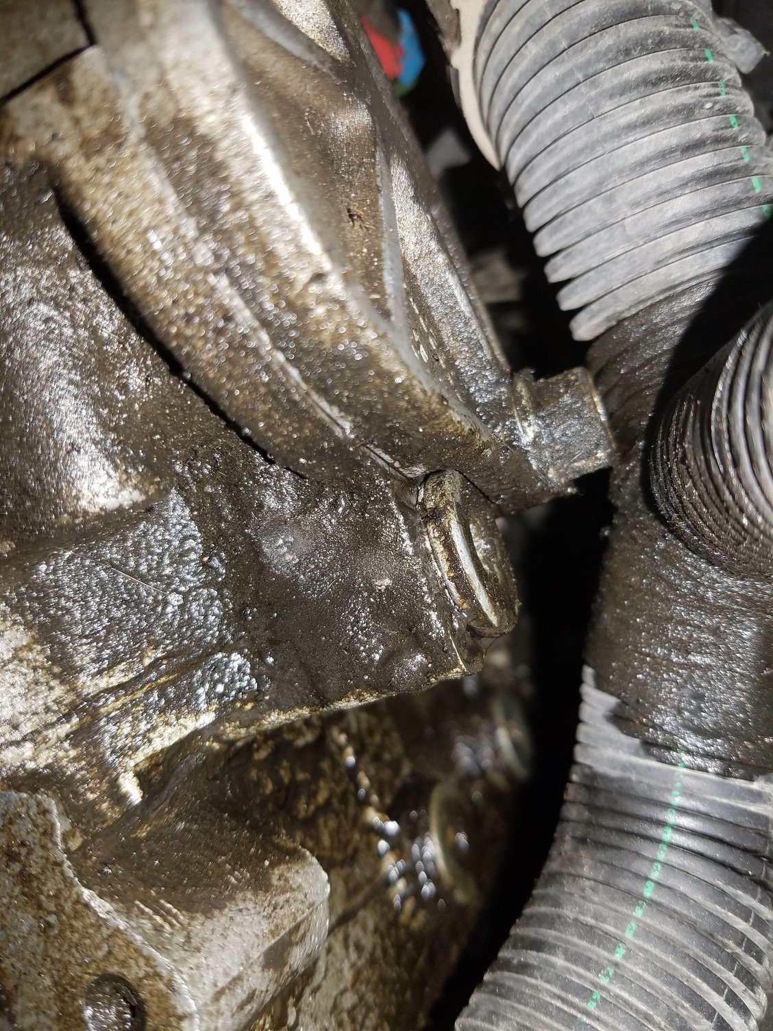

Old Aug 4, 2016 | 10:23 AM
jdbaugh1's Avatar
Joined: 02-03-16
Posts: 6,435
Likes: 358
From: Kansas
You can see a little oil dirt on and around the sensor.
Area noticing wetter oil/dirt
It looks like I have definitely got a leak but the question is how sever and where is it coming from. I started noticing the oil loss after I replaced the timing chain which involves taking of the valve cover. I replaced the valve cover gasket while I was at it. Don't know if this leak has anything to do with the valve cover gasket but thought i would mention the variables.
Old Aug 4, 2016 | 11:01 AM
Clean it off really well and then check it every few days to find the source
