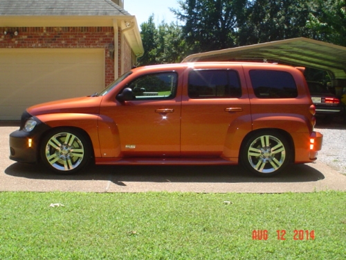

I spent 3 days of vacation 2 years ago working on a show finish. Strip old wax with dawn dishwashing liquid. Claybar the entire car. Polish several times with Zaino z2 polish, allowing to harden between coats. Then top coat with Mothers Carnuba just before a show. I use Zaino z8 grand finalle during an outdoor show to keep it popping. Hard work in the beginning, but this will be the 3rd show season with no water on the car at all.Name:  DSC00278.jpg

Originally Posted by mississippisunburst
I get good results using Zaino products. Start with claybar and finish with show car polish. on the day before the show, top off with grand finale spray. 2 years of shows, it gets lots of looks.
Nice! Great looking HHR man
