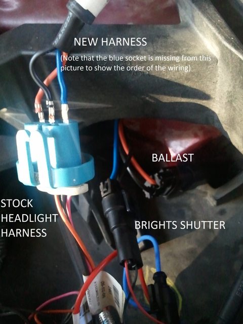

ya halos are easy as that but im having problem with my highbeams no work? and this may be the problem but i had nothing to snap the big blue plug on the light in to on the passenger side?

So y won't my highs work. Really would like them to. So I dont have to swap out for inspection every yr
Take a look back in this thread for my posts. I had problems getting the wiring straight. The problem with the brights is due to the harness having incorrect wiring out of the box. The plug that plugs into the stock blue plug needs it's wires rearranged. I have a picture posted in here with the correct wiring somewhere.
check your High beam fuse
also check the shutter control wires (the little black connector)
also see below

Thanks I did see that post I did my searching but I was not sure if this was my problem. Thanks for the help noob to hids And this is the drivers side that needs to be played with ?

All harness's should be swapped before there shipped. I may have missed one who knows. make sure your high beam solinoid plug is connected to the blue/black wires. Also i also could have repinned your plug wrong. Take the plug that comes out the back of the headlight. Its a 9006 plug. With the notch facing up, black wire should be to the left, and red should be to the right. Also your PINs in your 9007 plug could be bent. Or it just may be your fuse for your high beams. I test each and every setup on my personal car before there shipped.
woods, if ALL that does not work, its something else in your car..
