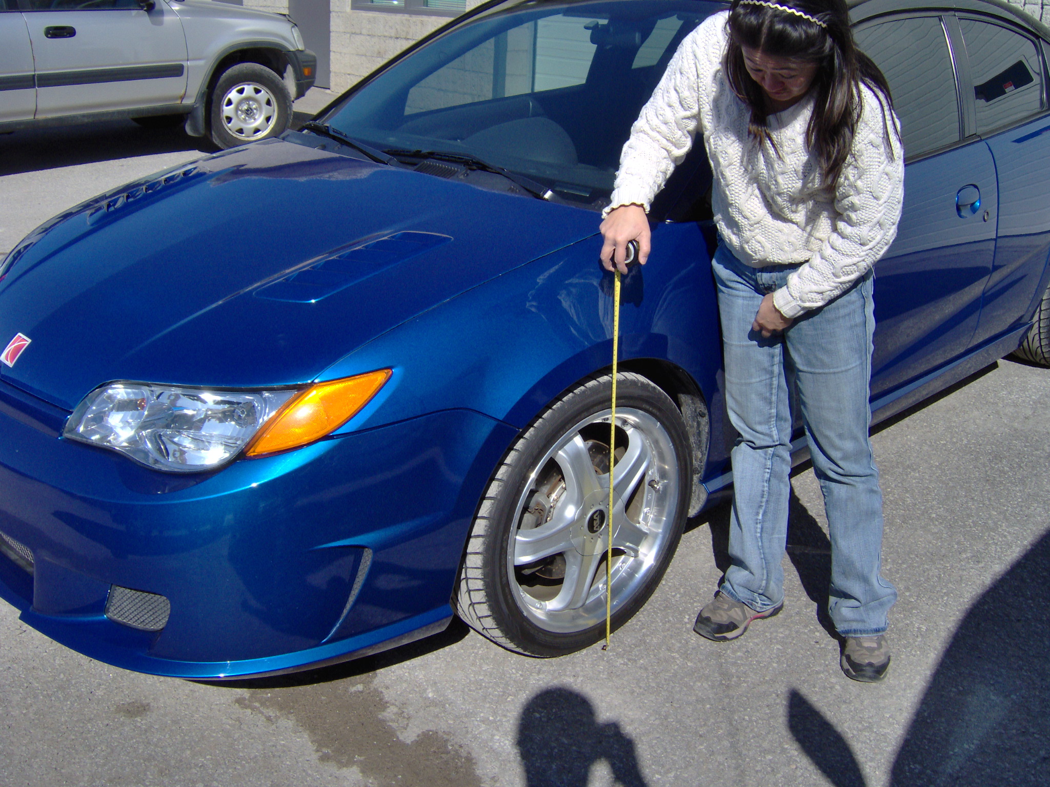

From: Port Perry
the issue with pedders is that they drop the car more and more, to the point that the car trims below 25 inches at the fender lip from the ground through axle centerline
measure like so:
this old 2007 picture is a Redline on Eibach springs on 18 asa wheels.
the ideal setting for track is around 2.5-3.0 negative front camber. You dont want to run that much negative camber on the street it will be a pita to drive and wear out preamturely the inside rib of the front tires. I would run no spacers, and -1.5 to 2.0 negative camber, and zero toe. I would also slot the strut mount holes to get as much caster as I can, even another 1/4 inch of top strut movement rearward would help.

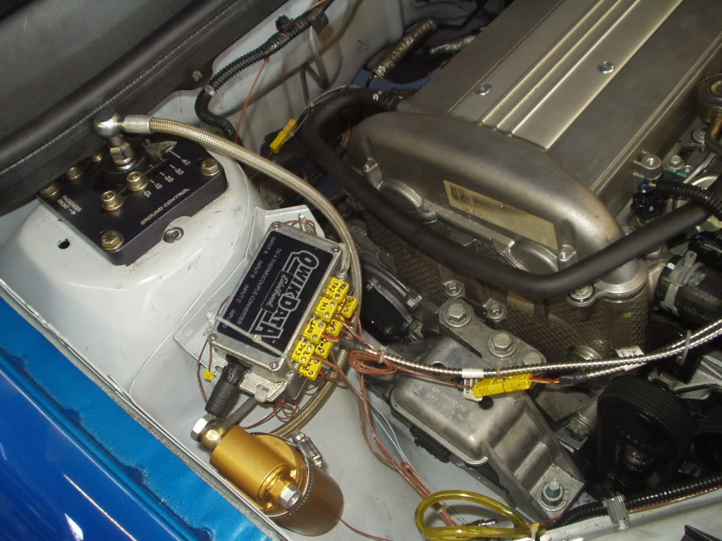

John can I beg you to make Powell Hardcore Performance top strut mounts that give us more caster?
Old Nov 28, 2012 | 03:02 PM
  #104
Powell Race Parts's Avatar
Joined: 04-25-11
Posts: 6,128
Likes: 47
From: Port Perry
there is a less expensive solution costs about 400 dollars. takes a bit of time the fab shop in california hates to make them for some reason. Ground control made that one for a Vdub and we adapted it for coil overs. Not that much about 300 but the install and the coil overs is expensive. See all that data recording stuff and all the sensor leads? Testing....

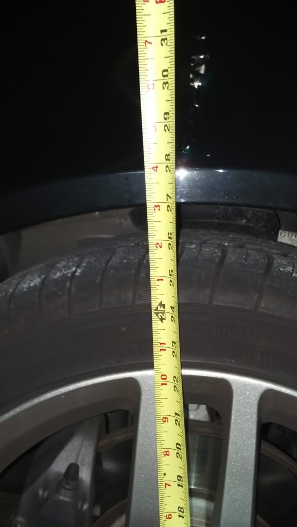

Old Nov 28, 2012 | 07:41 PM
  #110
spike's Avatar
Joined: 12-01-06
Posts: 1,700
From: IN
SSTC Sedan stock height 225/45/18 tires aka monster truck. Hoping to get some YYZ's after Christmas
front
rear
Old Nov 28, 2012 | 08:18 PM
  #111
Joined: 04-25-11
Posts: 6,128
Likes: 47
From: Port Perry
27/28? wow that is 'chain ready' ...lol
Old Nov 28, 2012 | 08:42 PM
  #112
spike's Avatar
Joined: 12-01-06
Posts: 1,700
From: IN
Yeah its just shy of 27/28. My car is definitely on the struggle bus as far as sitting/ driving right. Hopefully the yyz v2 and a good set of 235/40/18 & 18x8 wheels will get me out of crossover ride height. Im starting to feel like I drive a Traverse.

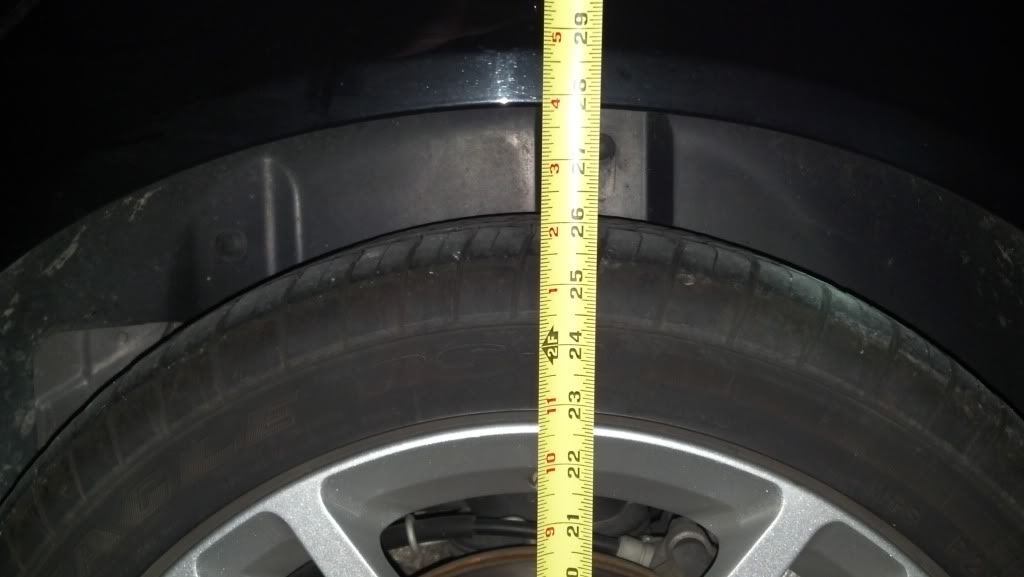

Old Dec 2, 2012 | 12:58 PM
  #114
86buick09sstc's Avatar
Joined: 01-02-11
Posts: 151
From: Marriottsville, Maryland
Measured my car from ground to wheel well today in the driveway, not quite level but close. Cant wait to get the new YYZ v.2's!
Tire Height: 25.1" Stock
LF: 26.5"
RF: 26.3"
LR: 27.3"
RR: 27.5"
