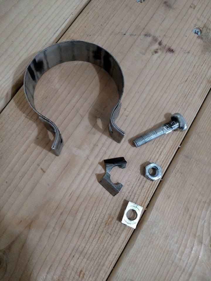

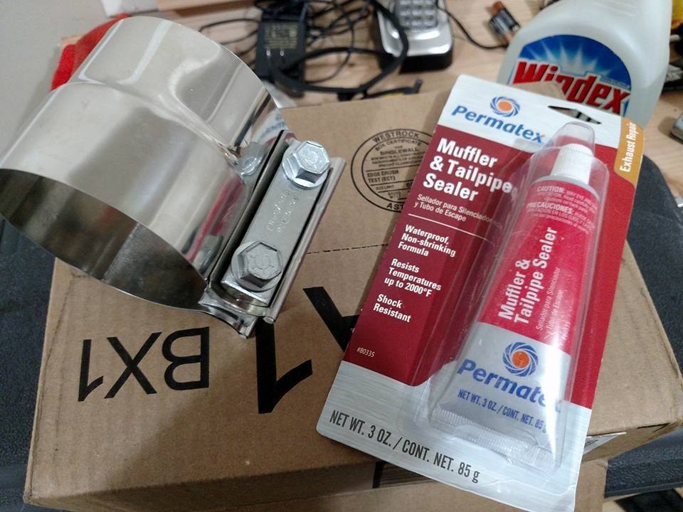

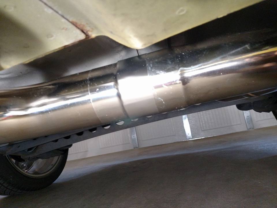

From: Newark, DE
surprised by that too.
Finally got the new clamp on. Actually found out the one TurboXS supplied snapped at the I bar...
I suggest this clamp. TurboXS, you should put this style clamp with your exhausts.
https://www.amazon.com/gp/product/B0...?ie=UTF8&psc=1
Just needs to be 3"ID to 3"OD like in the link. It looks great and its polished stainless steel so it blends right in. note: the image on Amazon website is not accurate. There is no Nut for the bolts. The other D bar is threaded so its even easier.
Read online from someone using these clamps to tighten them to 45 ft-lbs. Seemed tight so did 30 ft-lbs first and then went up increments of 5 ft-lbs. Sure enough, it held and didnt snap / fly into my face. lol.

I should do this... same issue here with my FL. The included clamp broke on me. Couldn't get it to tighten enough.

Same happened to me so I went to auto zone and got a clamp but I'm already at 2 yrs on my exhaust

Sent this over to quality control as well as the owner. We are looking into this matter and will report back with what I find (Raj)
Thanks for this, as this helps US. Appreciated.

Update: Quality control and the owner are fixing this problem as I type. Looking to order pretty much what Cudajoe has.

Cudajoe,
The pipes overlap right? That clamp has a groove in it. So is the groove just a little step to allow the clamp over the second pipe then it goes to 3"? And is the sealant necessary?
Looking to do this in the spring along with everything else I'm doing.
Old Nov 29, 2016 | 01:24 PM
  #997
CudaJoe's Avatar
Joined: 04-21-09
Posts: 11,280
Likes: 74
From: Newark, DE
Originally Posted by ThePanduuh
Cudajoe,
Thats exactly what it does. The narrower diameter side is 3" Outter diameter. The wider side is 3" Inner Diameter (at least advertised as this).
Idea is to provide a solid seal with a slip on pipe setup (one pipe slides inside the other). Im not sure that the Exhaust sealant is necessary with this clamp as both sides of the clamp would hold tightly to the pipe. Once this sealant is on, its pretty much a permanent bonding of the two pipes. If you use a sealant, Id slide the pipes together first and center exhaust tip to the bumper. Check the fit. Maybe drive around a bit and see if it shifts to one side or the other. You could then slide the pipes apart slightly to adjust how the tip sits. Once you find a spot that works well, mark the pipes with a marker, and apply the sealant.
I slid the two pipes all the way together but there little clearance from the EVAP box under the car. In a sharp turn or rough bump, I can sometimes here it clank. Its not a big deal though, I shouldnt be jerking the car or hit bumps hard to begin with.
