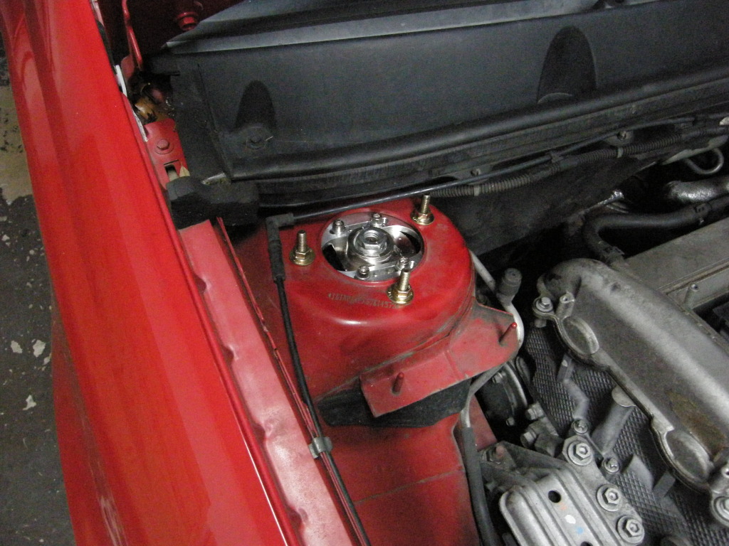

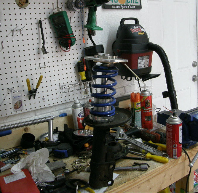

You could do some fabrication. Name:  P81102102.jpg
https://www.cobaltss.net/forums/susp...plates-284564/
you would have to figure out how to adapt the stock upper spring perch to work with the pillow ball, or just switch to different type of spring. And the stock struts do a pretty good job with slightly higher spring rates. Just don't try to lower the car too much on the stock struts. With the car at the ride right i'm at now i only have about 2" of travel before the strut bottoms out. I'm going to be shorting the strut and using some koni 8610-1436Race inserts , this should give me a good 2.5 to 3" more travel(the wheel will touch the wheel well at that point lol)

I'm liking this idea, I'm no welder though. I'll have to check with the Pro autox guys for guidance on this! Or is this a bolt on application? Thanks.

no welding needed, just precises measurements and drilling.
