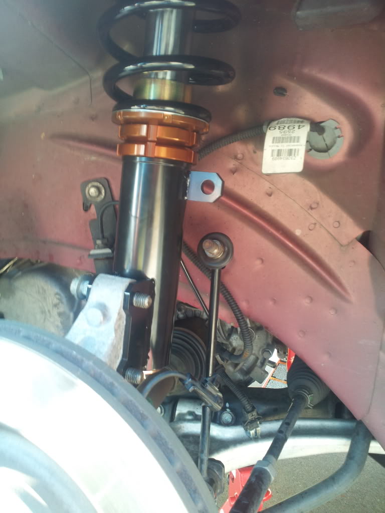

Hey guys I'm in the middle of installing my stance coilovers and I can't figure out how to get the sway bar endlink into the new bracket on the front coilover. Took a picture, maybe I have the stances set up wrong?

i would always place a jack under the brake disc and jack it up until its even. i have a feeling this is not the proper way of doing this but it works lol

yeah thats what i ended up doing, i just put a jack right on the sway bar and it went up really easy. I'm on the back now but i'm taking a lunch break haha.

I did that too I'm like wtf! Then jacked up the sway bar and was like wow that was easy haha. The rears are cake

if u unbolt both sides at the same time it pulls up rly easy..

is one side of the car jacked up and the other on the ground?

they both sides were jacked up, i figured out the endlink problem but now i just need to figure out when the rears are so bouncy. gonna try to adjust them tomorrow.
