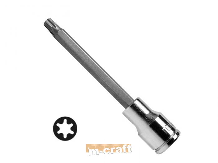

For the fronts, use an extended Torx45 (? or 47? I forget, but I had one in my toolbox, like this: http://instrumenti.lv/images/items/b8MykV3nu1o.jpg), with the shaft rounded, and a 15/16ths spark plug socket (http://www.mytoolstore.com/wilmar/w1126c.jpg). Place the socket on the strut nut, place a ratcheting wrench to loosen on the spark plug socket, feed the torx socket (with a locked ratchet/breaker bar) through the hole on the spark plug socket, and crank the wrench while holding the breaker bar. No need for impact gun, as that just ends up spinning the strut shaft inside the strut.
