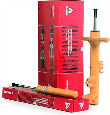

I just received a koni shock for the
front and i feel like they sent me the rear one?
isnt the one on the right the front and the left one laying down for the back?

the one on the right is the front one

no. the fronts are inserts, you must cut your stocks and install them. the one standing up is for the frotn but its full replacment for some other car. the one laying down is called a insert which is what they only make for the cobalts. Read the how-tos its very easy to install.
Yes that is correct, the fronts are inserts.
That photo you used of ours, is just a generic photo, as Koni does not provide pics of each product.
