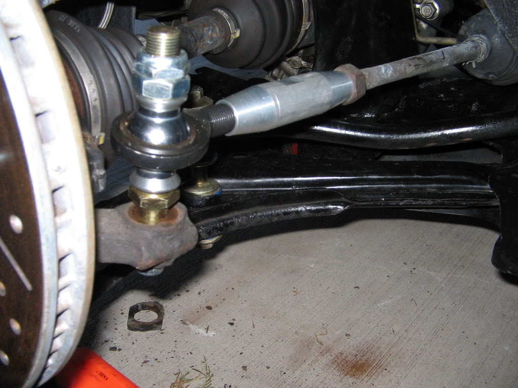

Im no suspension guru.....just recently seen lots of people complain about issues when they go low. Just trying to help ya'll guys out.
So i posted this up over on the org for the jbody guys and its been said to help for those who go really low.
For the smart assess....i know the link is for a honda....but the idea is the part.
Buddy Club BC02-BJP1-H001 P1 Racing Extended Ball Joint for Acura RSX / Honda Civic 02-06 : Amazon.com : Automotive Buddy Club BC02-BJP1-H001 P1 Racing Extended Ball Joint for Acura RSX / Honda Civic 02-06 : Amazon.com : Automotive
Here is a installed pic someone posted on the org.

So is this available for the Cobalts? I offered my input on this because ive considered of going low but worried of having issues like how everyone is posting.

Most of us shim the rack where it mounts instead of messing with the tie rod ends.

yep.... if your really low shim the rack

lol, that ghetto **** would never see my car.
just get rack spacers, even then im pretty low on coils and dont have any problems.
