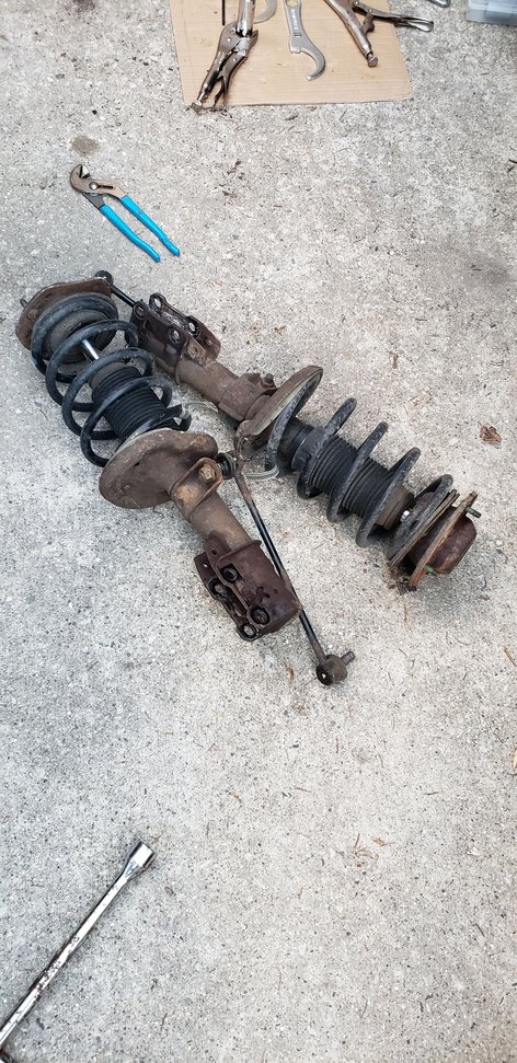

So I finally installed the raceland coilovers.
the install was a bit of a pain, but if I had all proper tools it would've been fine. It rides a little rougher, as can be expected. Fronts are about 3/4 an inch higher than being bottomed out, rears are set as low as can go without removing the spring seat adjuster.
in order to put the top mounts on the front coilovers you need to put an Allen key in the center and use a 22mm pass through socket and wrench so this was devised.
and the sway bar end links bushings were totally destroyed so the bolt spun freely and it needed vice grips to grip it while wrenching, ended up just replacing those all together and taking them out with the front shocks.
