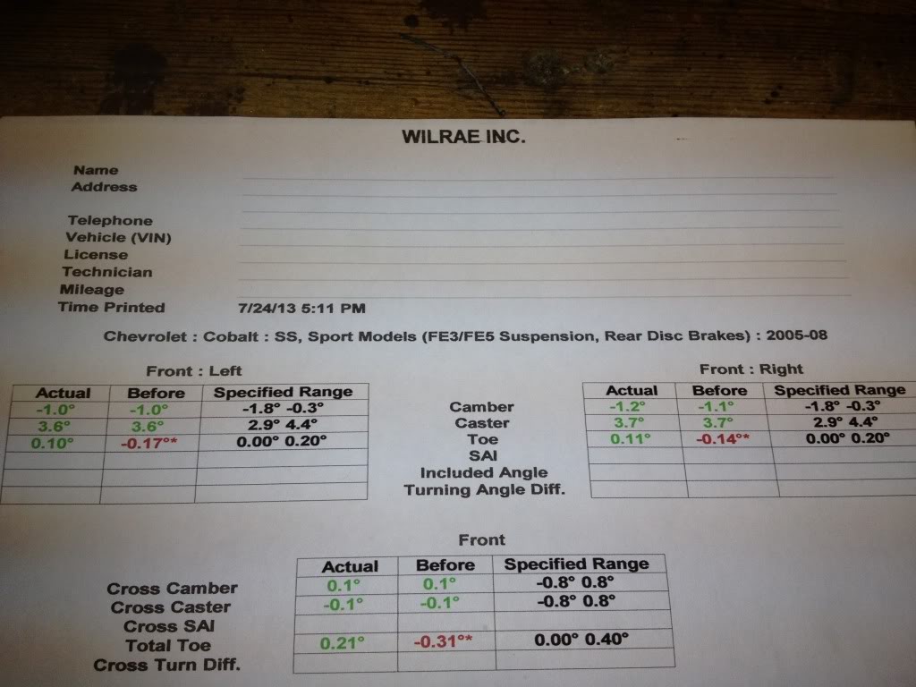

This is mine with stock suspension. Just snuck it on the alignment rack at work yesterday and did it. Note specified range for their recommendations. I think it handles pretty decent.
