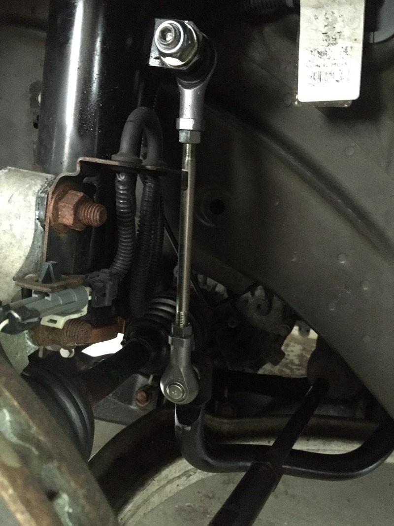

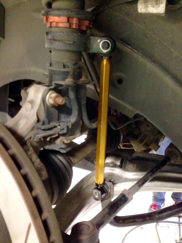

I have Whitline endlinks and they are beasts lol. This is the setup for ksports. And yes, that bracket is where they mount. Don't mind the filthyness, I had a dirt (mud) driveway at the time. lol

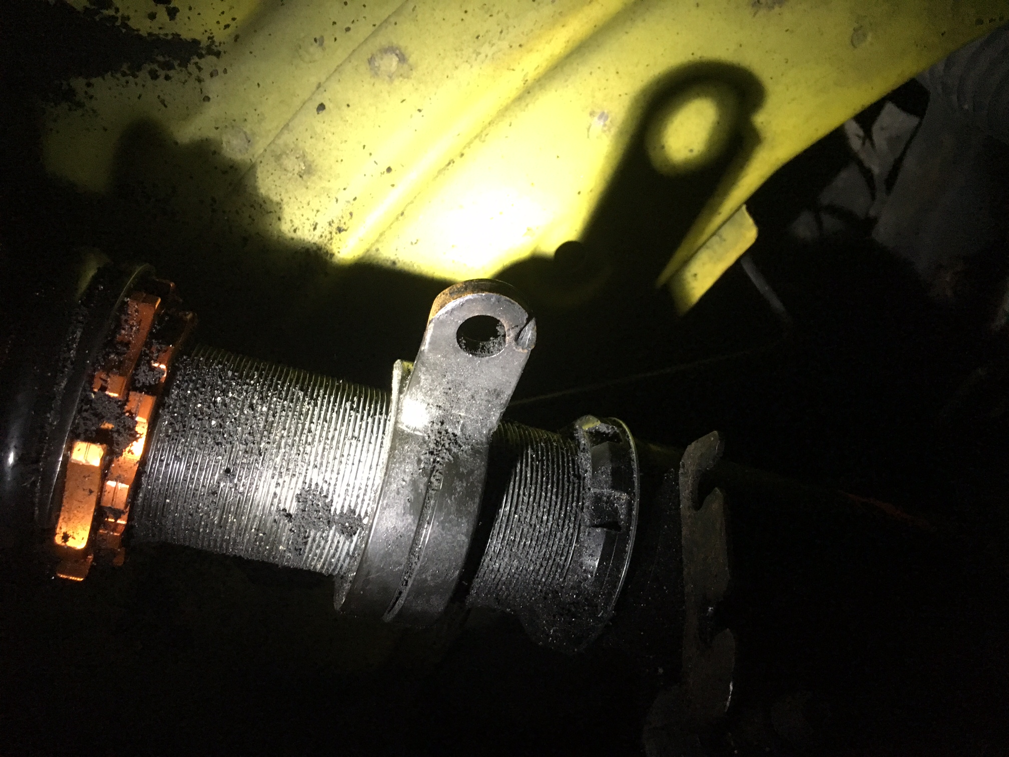

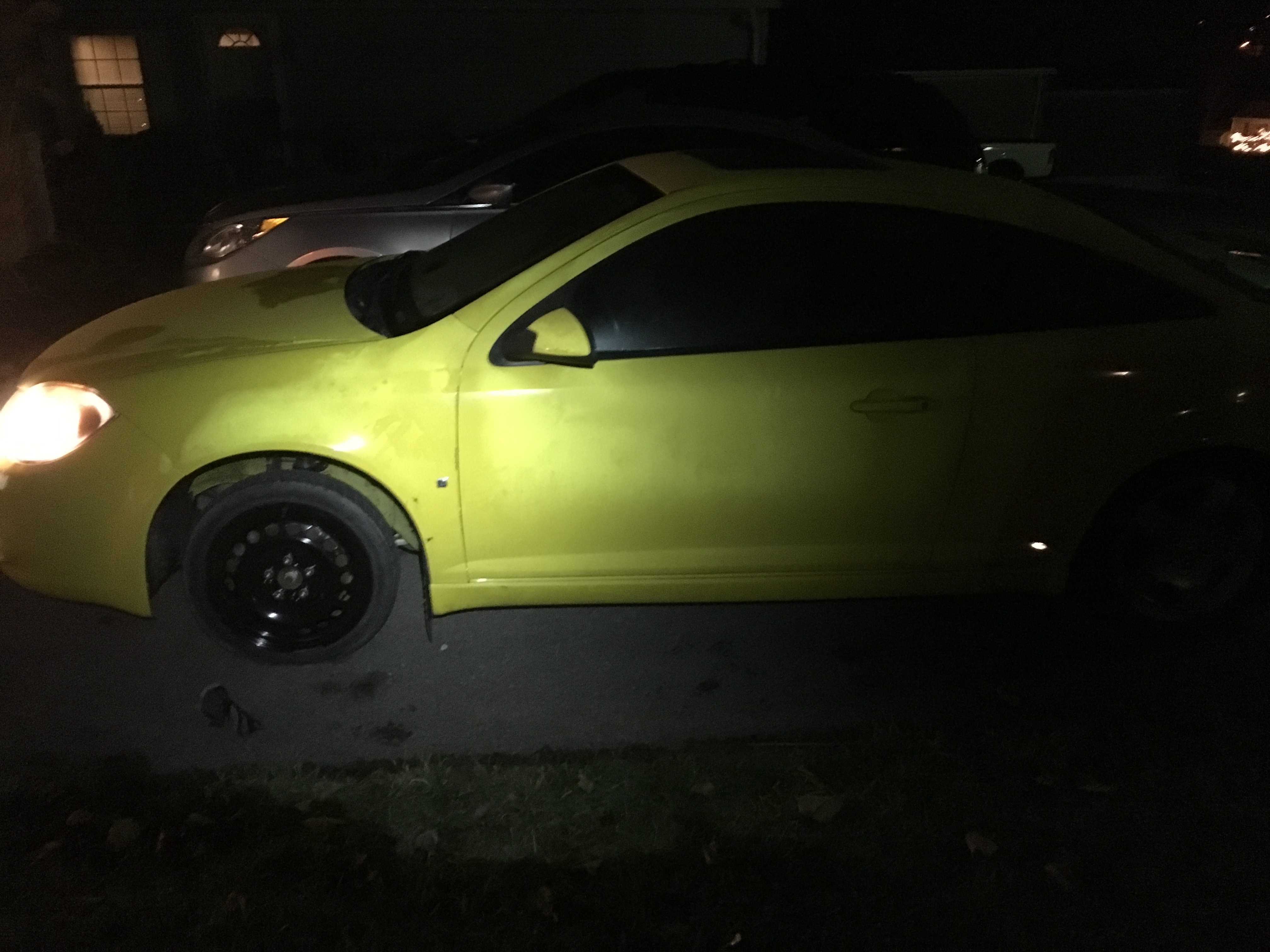

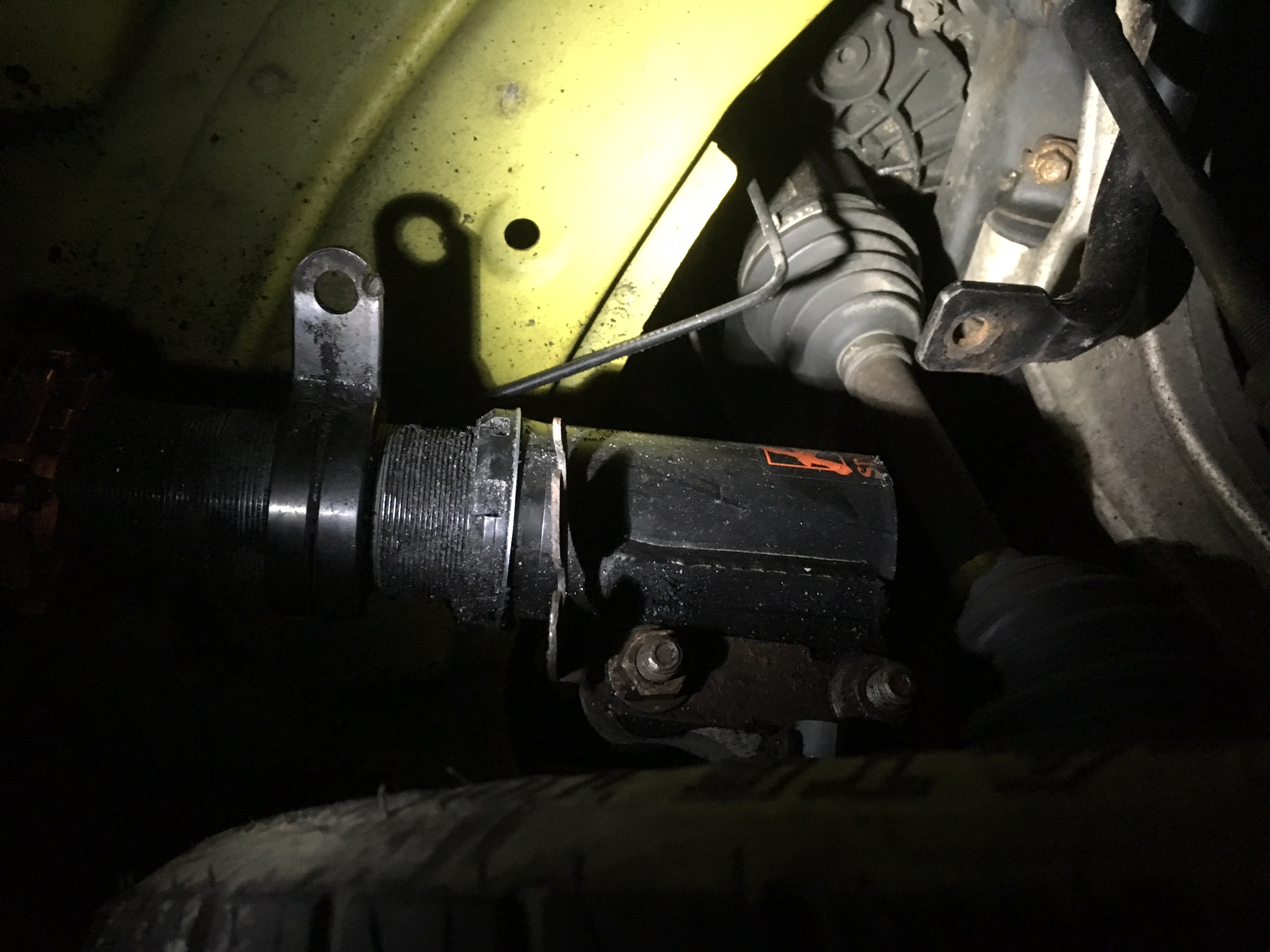

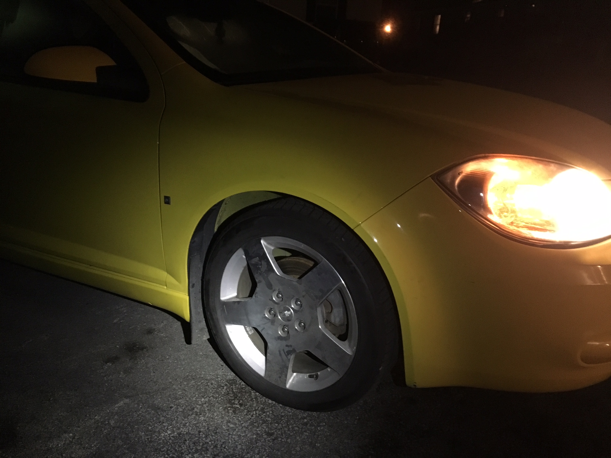

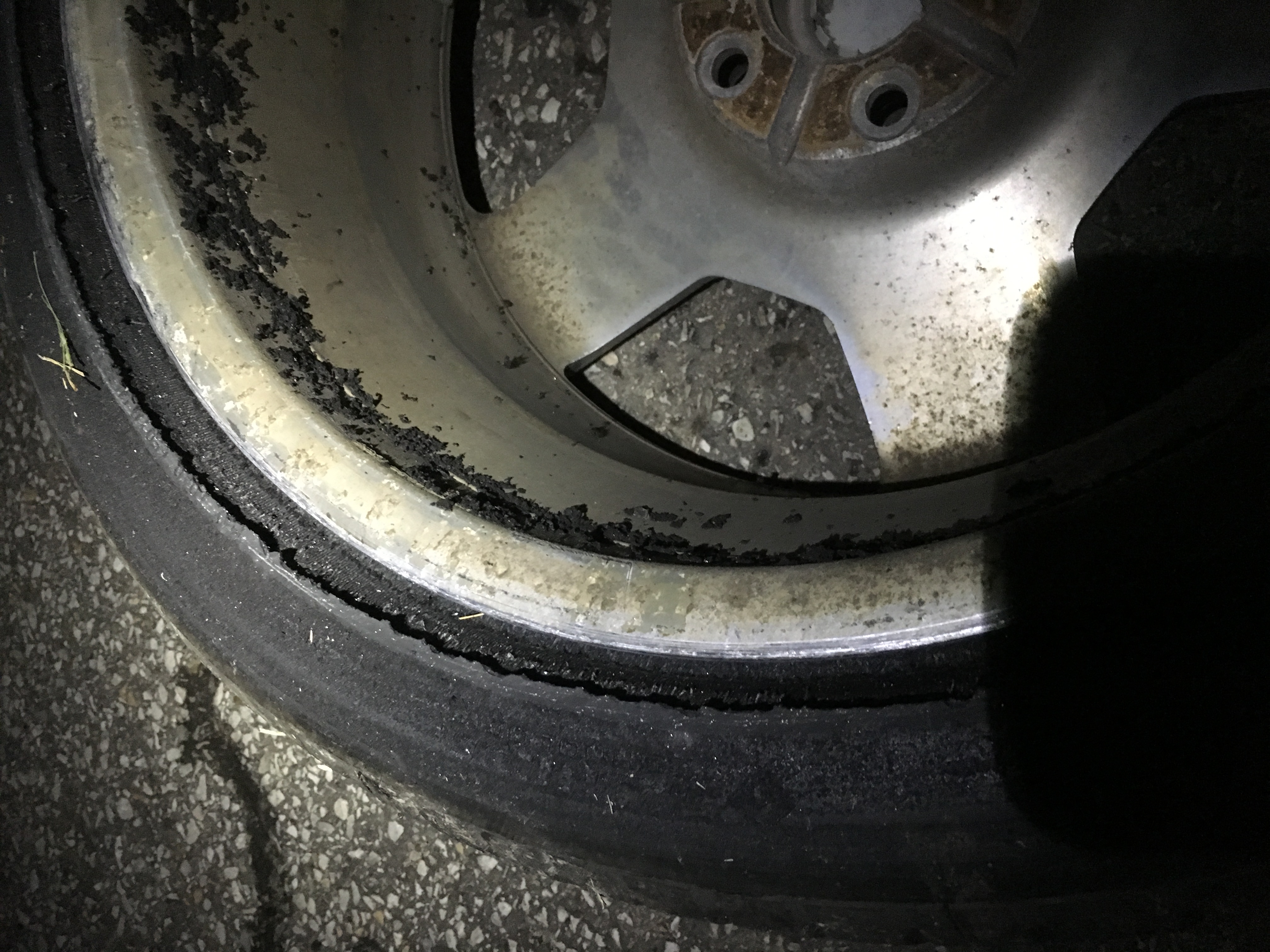

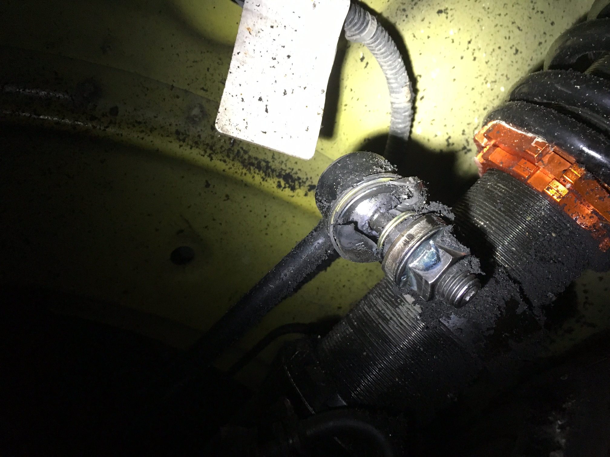

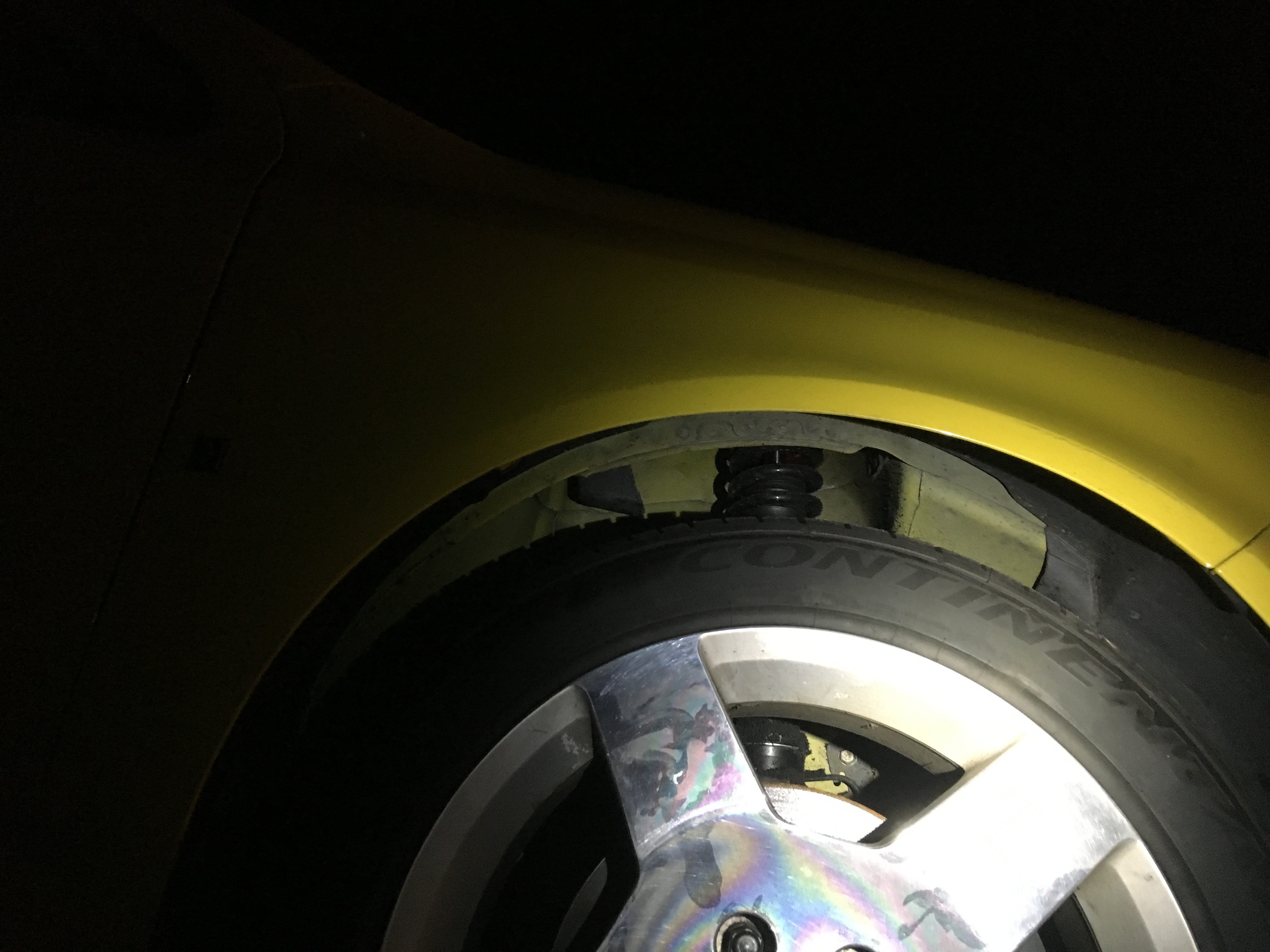

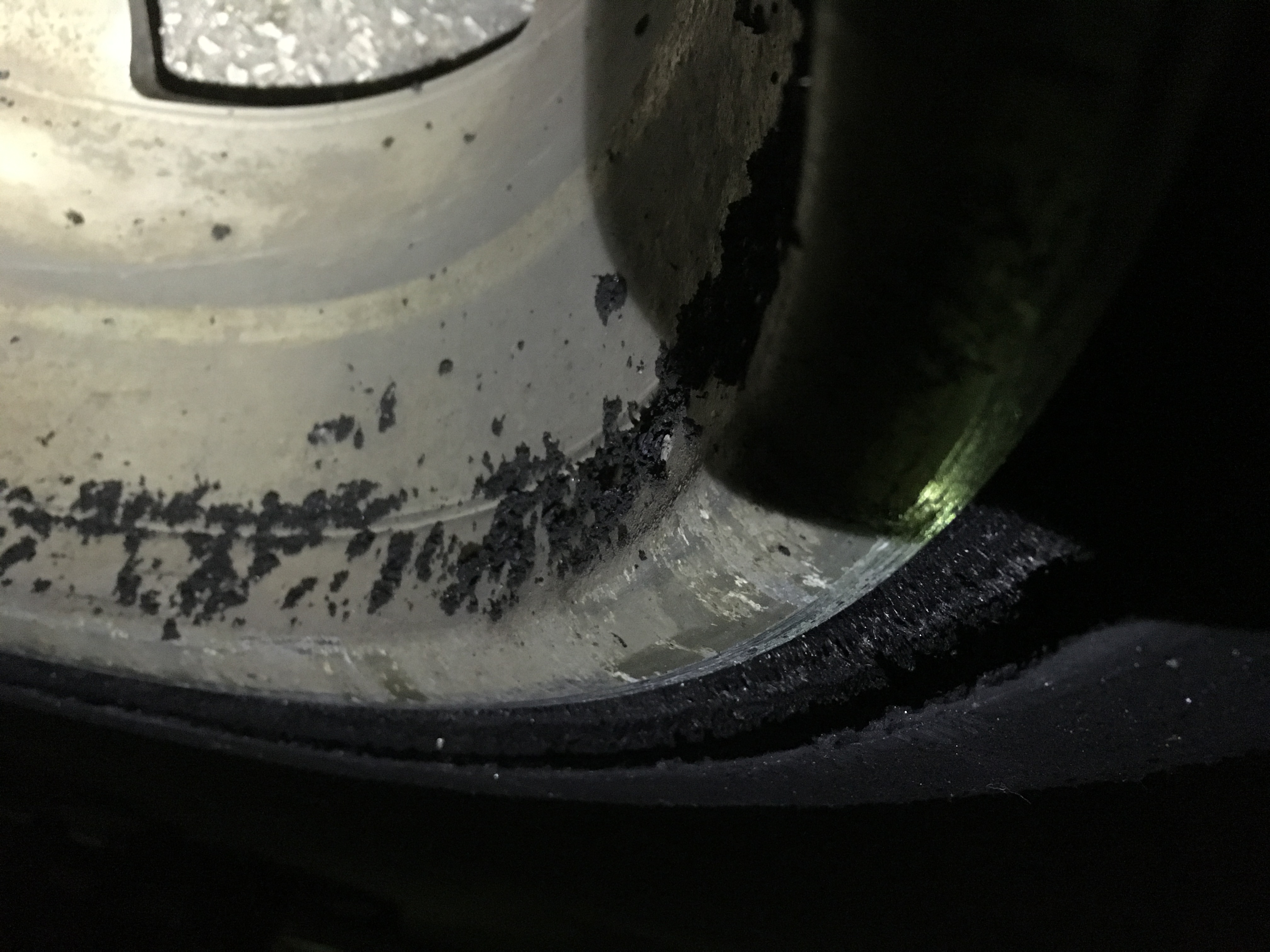

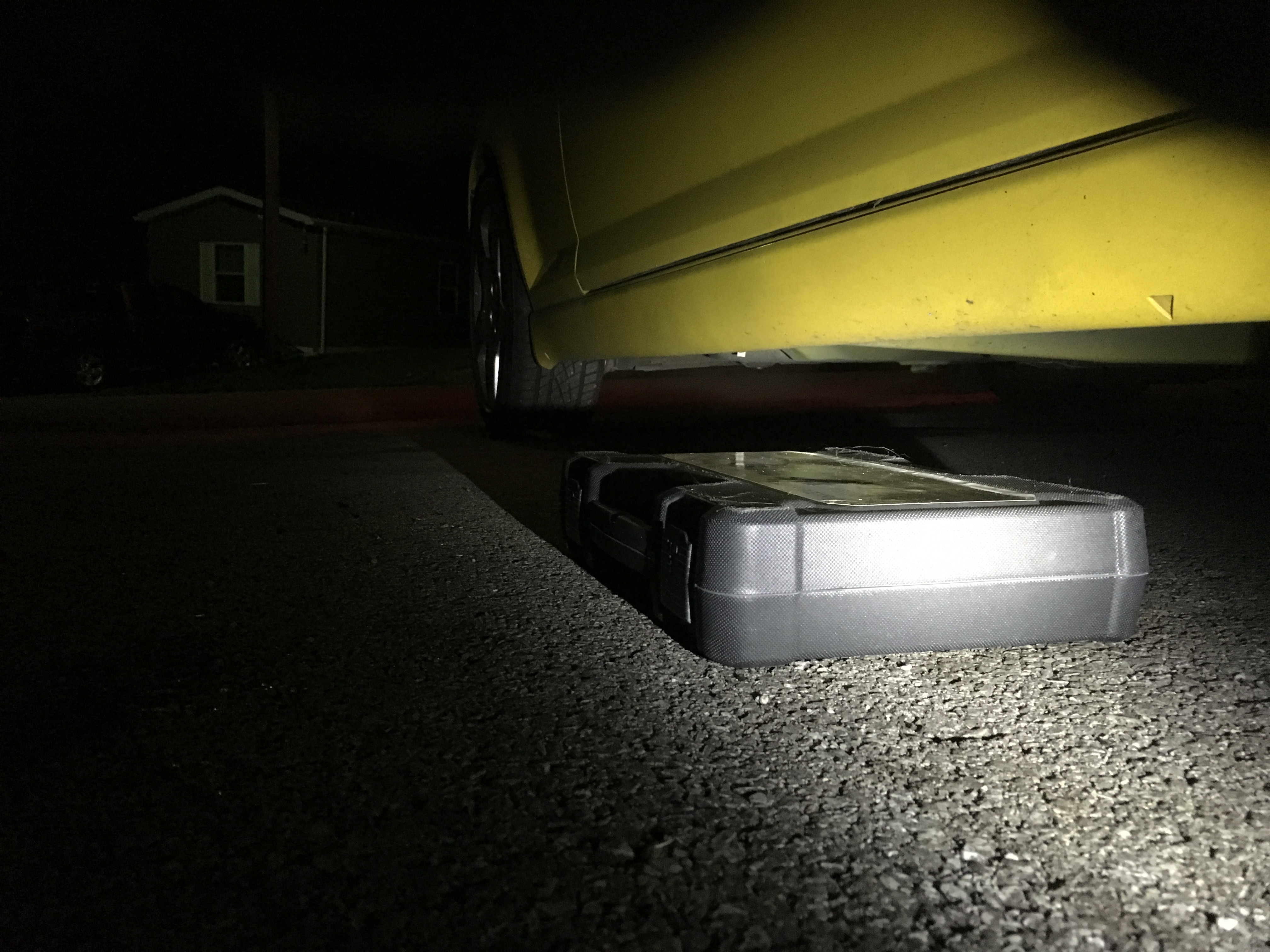

So the first two pics are the driver's side. On the KSports they have the sway link bracket rotate freely up and down, and im assuming now to compensate for the different lengths of sway bar links (am i right??) There is no way to secure it in place either so i am worried if i purchase whatever it is i need that this will be an issue when the links are hooked up...?
But the rest are showing what happened to the passenger side. Even though the tire is still on the vehicle, the sidewall of the tire itself looks half-way like the driver's side tire (the last two pics are showing what happened to the driver side tire.)
Im not a photographer gentlemen, and its colder than a witches tit outside so i wasnt about to go through the process of removing the wheel... i can and will if need be tomorrow though.
So what do you guys think???

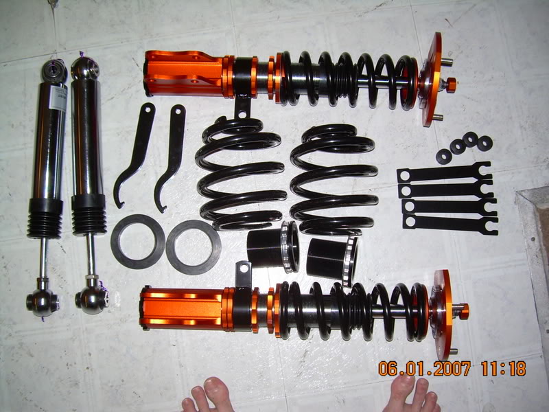

is the collar just spinning on the threaded body? the pics i look up of those struts shows lock collars on either side of the sway bar bracket to lock it in place. see the pic below
Old Dec 4, 2015 | 11:32 PM
Cobalt_noob's Avatar
Joined: 11-06-15
Posts: 220
Likes: 6
From: Pittsburgh, PA
That's a slightly different setup than the one I have. The bracket on mine spins freely up and down. Not only that, there is an Allen key bolt on it that once you unscrew it, you can remove the bracket from the strut. Not sure the point of this other than they were expecting this to happen. ... And you can't tighten that Allen key bolt tighter so it doesn't spin either
