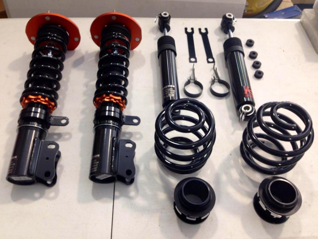

This is the kit you have correct? I have never had my swaybar brackets move on me, would definitely call Ksport and see what their recommendations are. And for the record, there are no lock rings for the swaybar brackets. Also, can you take a pic of the full endlink attached to the bracket and the swaybar. Looks like the two are awfully close in the one pic.
Yes, that's the exact kit I have! I emailed them about the bracket asking for a full explanation as to why the brackets move freely even when the links are attached. I was already itching on the hunch that something wasn't right about the bracket.
Now about the bracket and the swaybar sitting close to eachother on the one side, I just bought some 'Moog' links (I didn't want to throw more money at nicer ones and then this happen again.) Yeah man I'll hook them up and snap a pic... I would do it right now but I've got kids.

See the above picture. The Ksports don't come with lock rings on the swaybar brackets. They are a split bracket with a set screw. If the proper torque spec, and sometimes Loctite, is not applied, they stand a chance of back out. The kit posted on the previous page was either an older kit or another level of Ksports. The kit he has is the same one as I posted.
