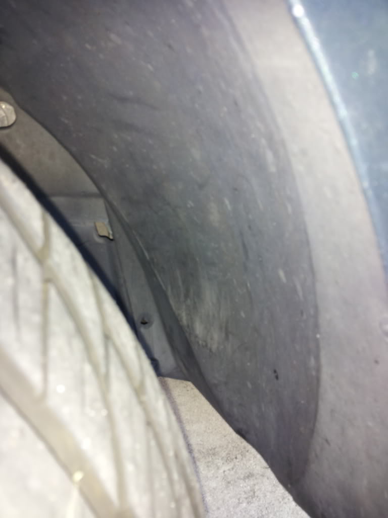

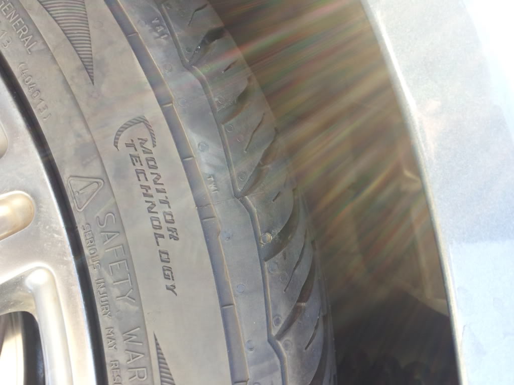

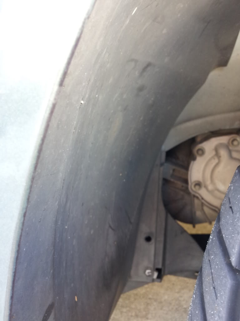

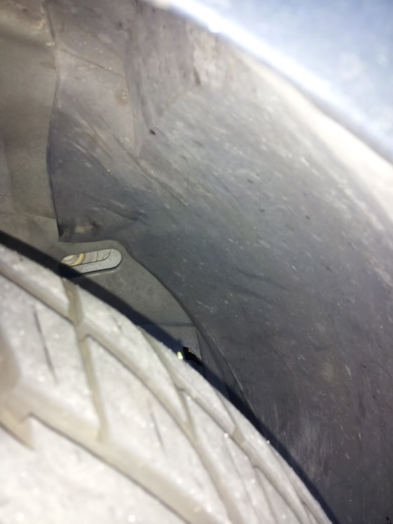

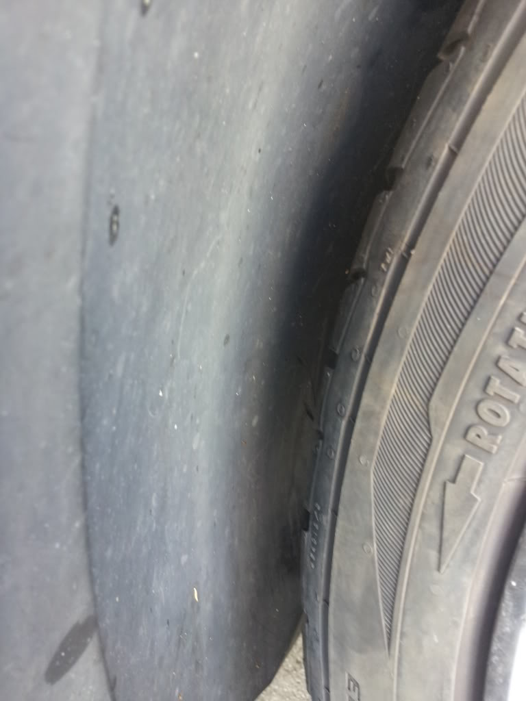

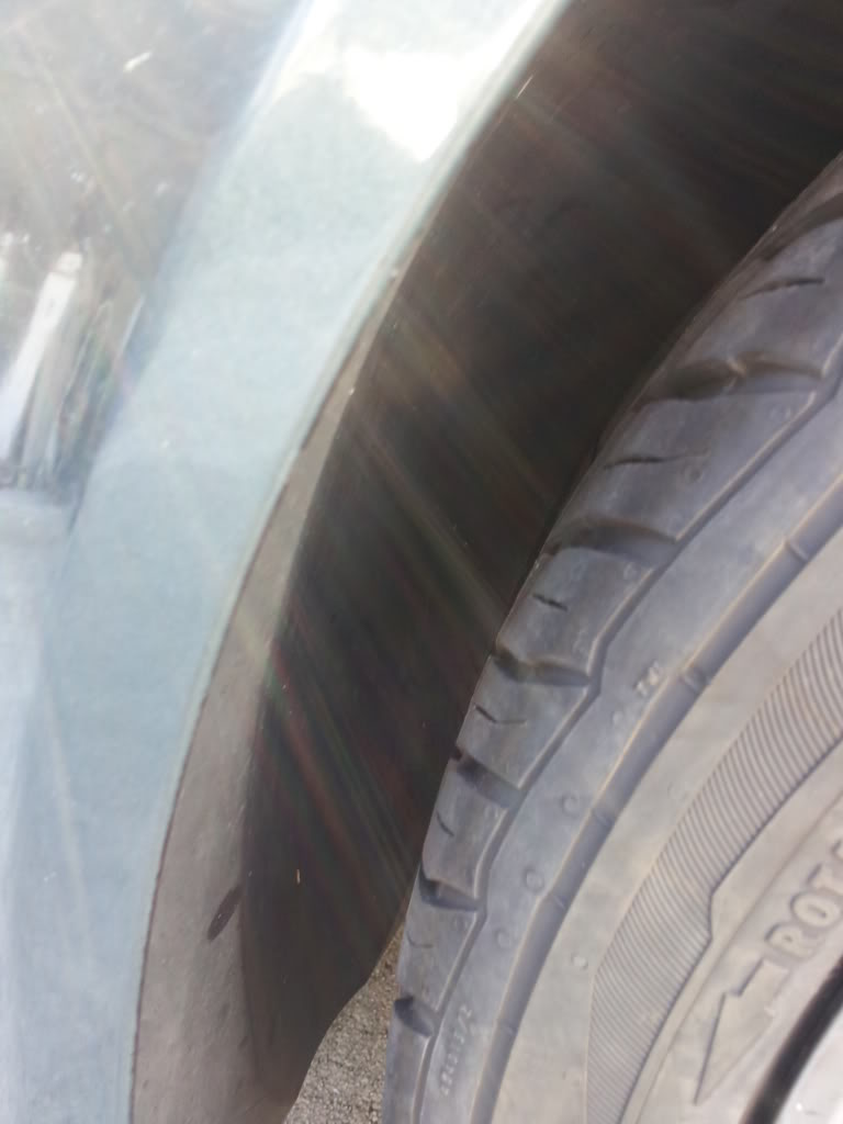

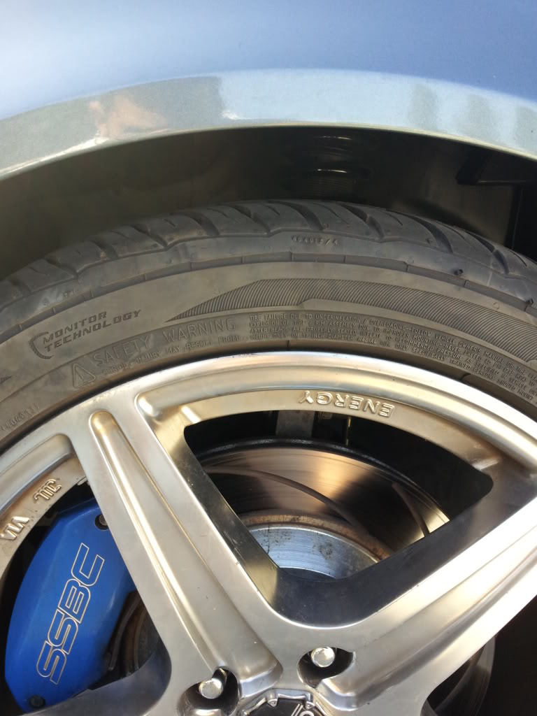

thats not a stock spring. looks like a coil over or a sleeve. its an f23 car. I would guess that at full lock with those tires and coil overs you get a lot of scrub and that could lead to a thump transmitted through the top mount of the coil over, which if I am right would be a spherical joint and would not isolate the skip/scrub motion of the wheel/tire assembly at full lock.
and then the brake calipers look non stock as well....
Amazing how much we can gather from a few pics
I agree with John, and also, if those are sleeved, the popping could very well be from the spring unseating and reseating. Tell us what kind of coilover that is.
They are BC coilovers, I said that in the first post lol. I've had the coilovers and tires on for about eight months and never had this this thumping noise problem. The noise only came after we installed the new parts as I listed in the previous posts.
