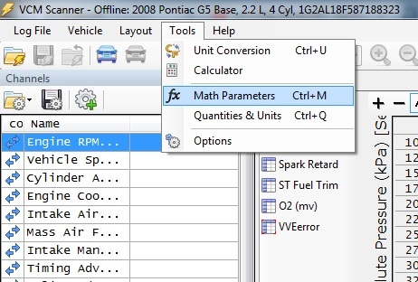

If you are trying to log your wideband through your AC pressure signal, you'll not be able to simply create a function string and expect it to work. Now you have to create a user math parameter. It can be done here:

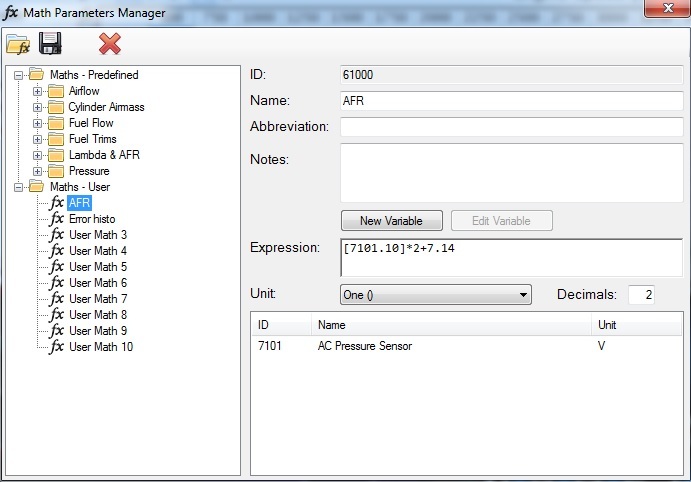

Like this(pay no attention to the 7.14, it's my offset for my ethanol mix):
