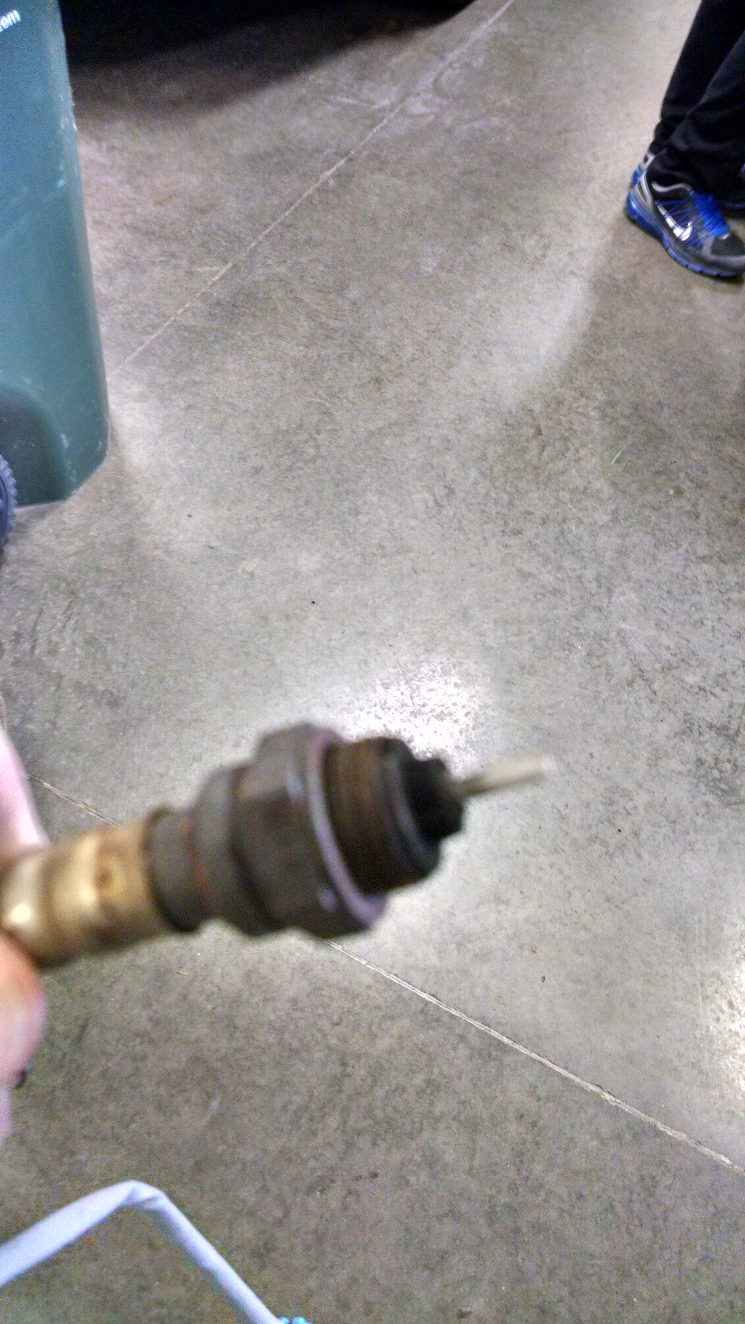

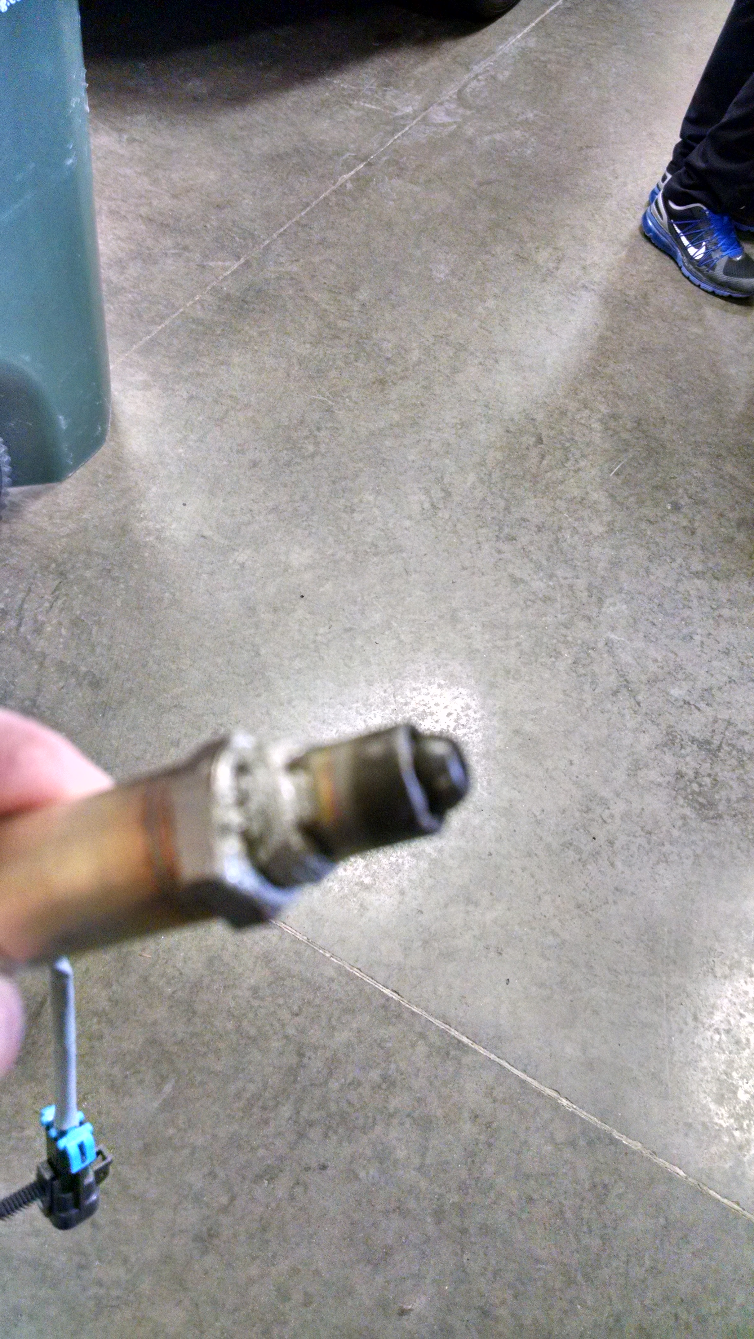

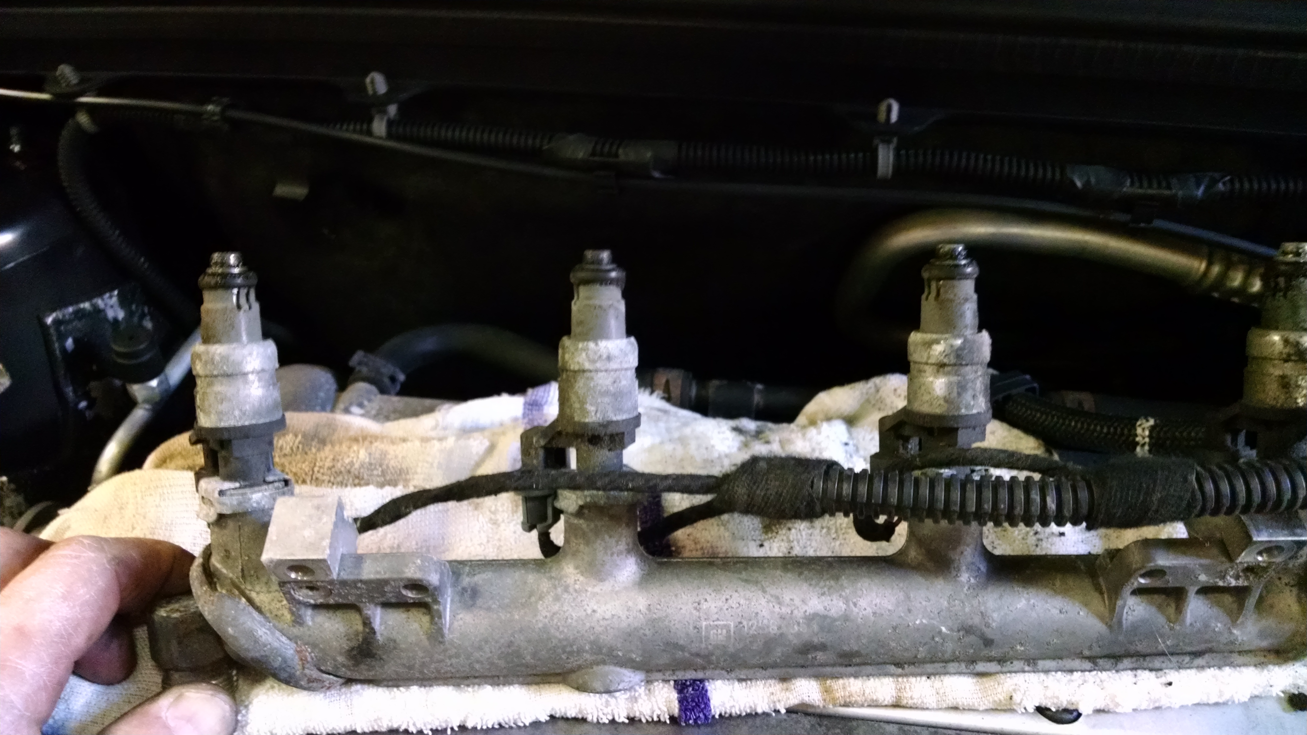

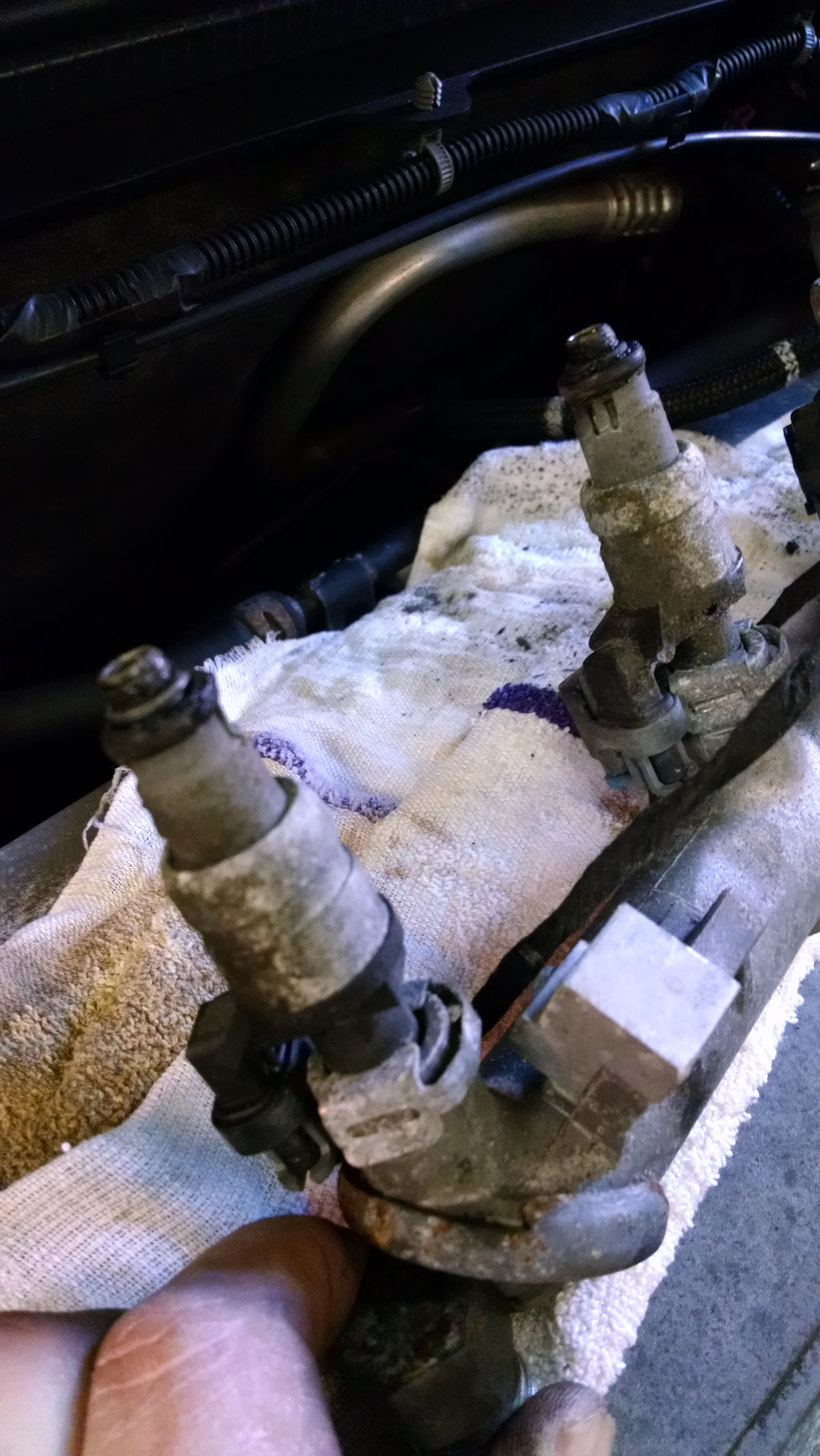

Ok so here's an update. I think I fixed the rich condition, rough idle, and jerking problem by replacing a bad O2 sensor. Pics of old and new attached. This makes sense because the car would run fine until it warmed up and was driven a while which I attributed to the ecm not taking input from the O2 sensor until going from closed loop to open loop mode. Does this make sense? The fuel mileage is slowing going up on the computer too. Was as low as 13 mpg but now up to 18 and still rising. Also included pics of my injectors which i think look like the gmpp42s posted earlier. But I'm gonna leave it alone.because its running good now. The bucking was horrible when lightly on and off the gas in all gears. Thanks for everyone's input.
Yes those are gmpp 42's.
