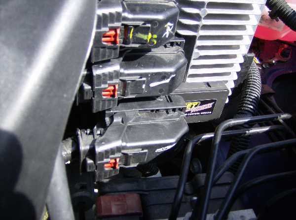

E67 ECU with Jet 10708 re-installed in 2007 2.4L LE5
INFO: The module does not go into the bottom connector -- this picture is incorrect. I Purchased the Jet module and the instructions show a GM ECM -- not a Cobalt ECM -- and it only has 2 connectors so the instructions make it look like it is supposed to go in the bottom. I looked in the 06 and 07 factory service manuals and discovered that the engine controls (MAF, H02S, etc.) are in the middle connector so I called the Jet Tech line and sure enough it goes in the middle connector -- NOT the bottom connector as pictured. The bottom connector runs things like the cooling fans. Both the middle (C2) and the bottom (C3) connectors are 73 pin.
This is where it goes -- the middle "C2" connector:
In order to get the ECM cover back on I had to cut a small section out of the lower passenger side of the cover to get it to go over the connector.
I like the increased low-end and part throttle response. Haven't been able to make a comparison worth listing but I do know it has quicker throttle response and the part throttle performance is definitely better.

If you have an auto you can really tell the difference from a 10-15 MPH roll -- you don't get the "lag" before 4K RPM. If you take the module off to check this you will want it back on in a heartbeat!
Thanks to "Red07SSNA" for noticing a "minor" problem with my installation. I made a correction and the change is dramatic. Use the BLACK harness connection and you will have difficulty keeping the car straight and on the road under a brake torque L-1 launch!

My Lazer Blue Coupe is a SS with automatic. After I moved the Jet Module to the correct connector, it produces so much low end torque that it easily breaks traction on both wheels if I launch with traction control off. I went back and checked two different places where I launched from the right lane... both wheels broke loose (stock P6s) and the car drifted to the left across the left lane and nearly off the road at which point I let off. It also "barks 'em" on the 1-2 shift. In addition to the Jet GM stage 1 module, there's also a K&N SRI helping the low end. Still gets 22-24 MPG spirited driving into town and back to our rural subdivision.
