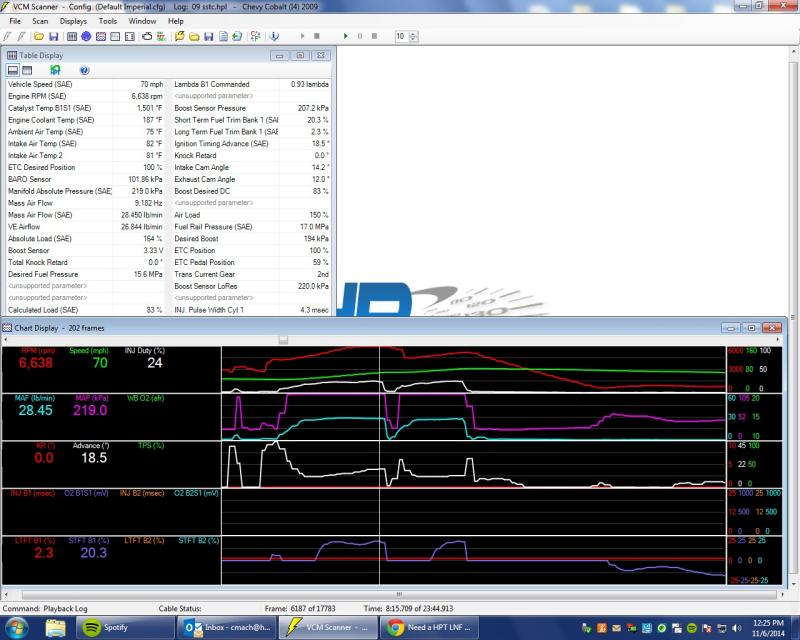

18.5 advance seems to the be the max timing commanded under WOT. I only ever pulled to 6600rpm in second and third due to traffic and that was the peak timing.
18.5 advance seems to be the max timing on it. That was 6600 rpm is 2nd and third.
Is it on 93 or E-47?

93 pump
Old Nov 6, 2014 | 12:28 PM
Terminator2's Avatar
Joined: 07-25-08
Posts: 12,450
Likes: 6
93 pump
Back it off. Way too much timing for just 93. That is about 3-4* past MBT timing on 93 and 25psi 14.5 to 15.5* max on 93. Pull the file and if you want send it to me. I bet he has it not pulling timing because it should be knocking on that much timing and boost and 93.

"Panda" worked on it a few times over the past 5,000 miles. Before that it had Trifecta for about 20k and stock GMS1 for about 20k.
Any harm done to it from the too much timing?
Also, it was not knocking at all. I would get 0.1-0.3kr but I was watching it and it was false knock from the construction on 417. Always as I hit a rut.

That car was likely tuned for meth based on the +20 STFT on 93 and the crazy amount of timing either that or he has no idea how to MAF tune not sure which.
